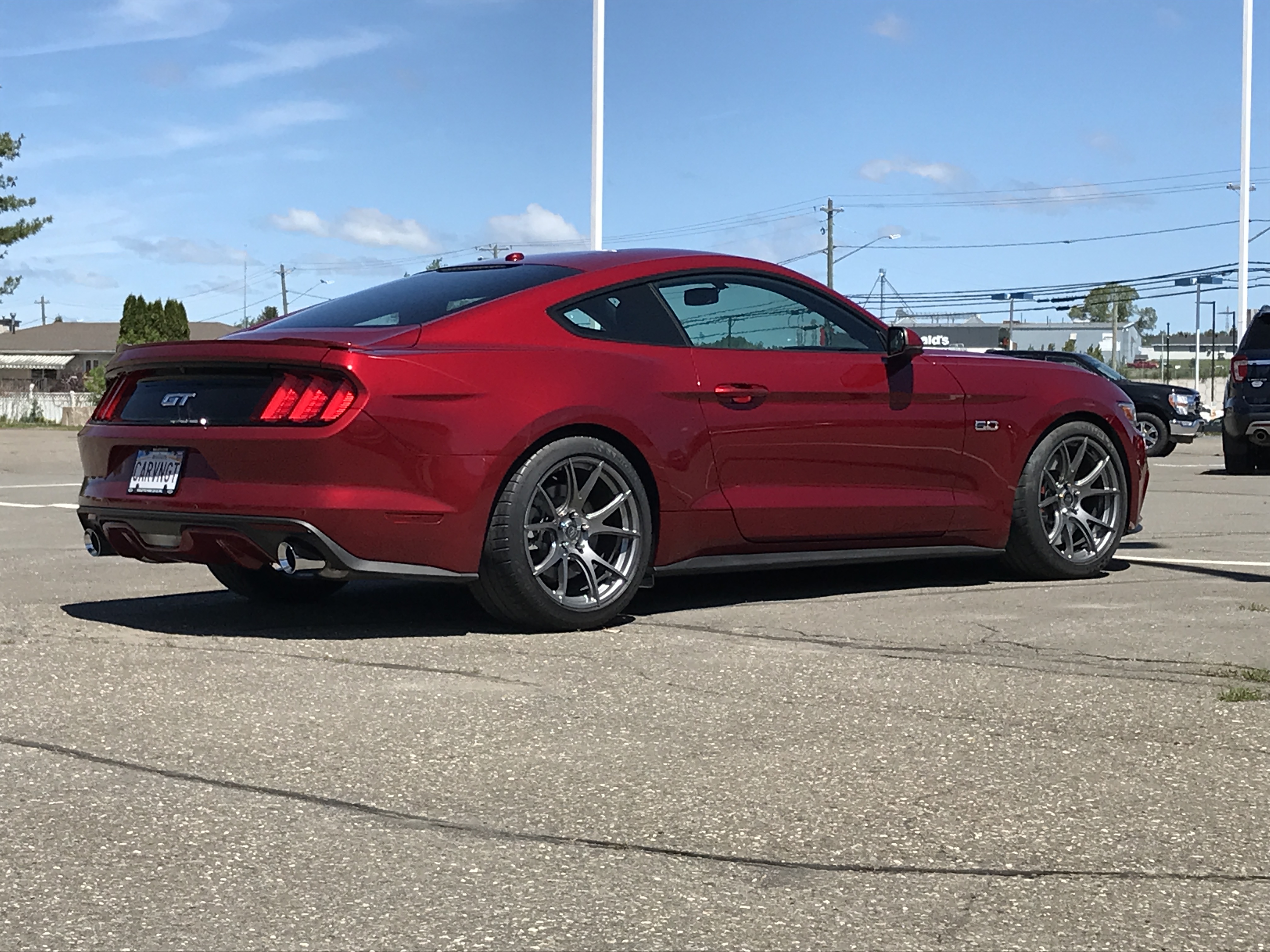

Plated it yesterday and got oil change done and alignment ckecked today.
I check alignment every year with oil change.
Even if it feels good.
Alignment was open in front. Toe out.
With the camber I run, would of eaten the inside of front tires pretty quickly.
Toed it back in a bit.
Good to go now.
Had forgotten just how good that car handles.
On ramps, transitions and sharp curves are just a playground for that car. ?
Few shots in dealership lot.

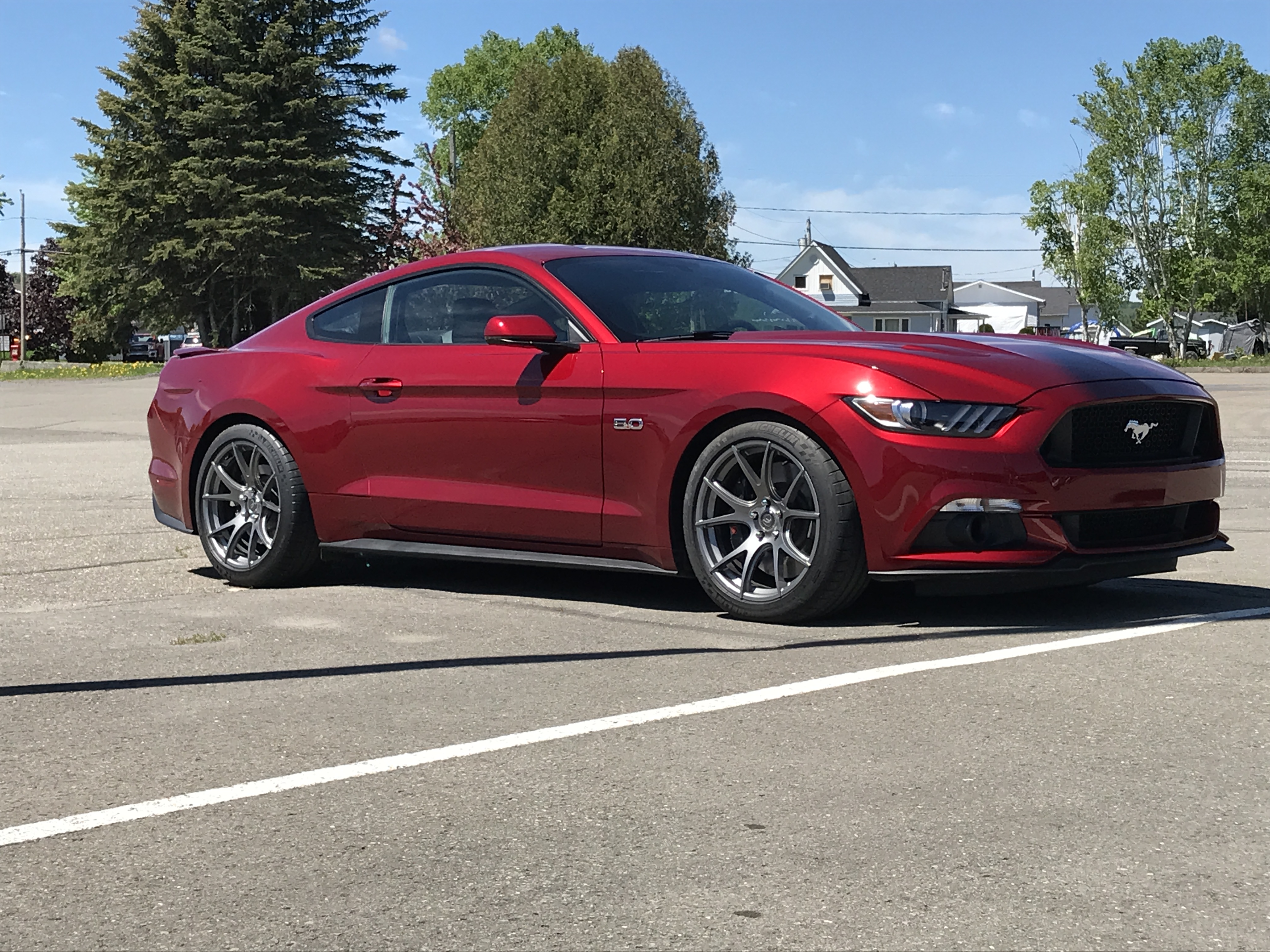

Good to go now.
