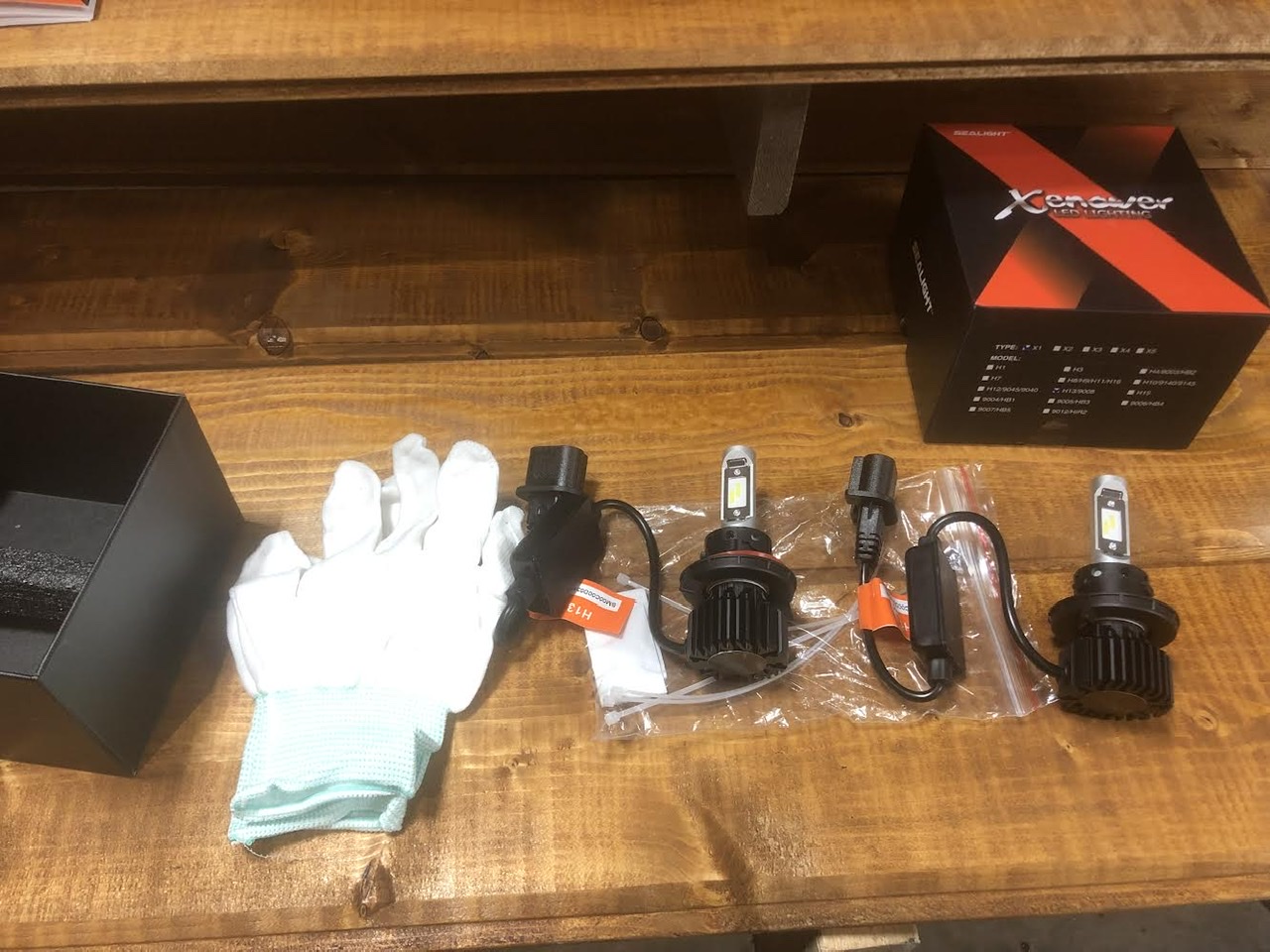

Big mod today,
Sealight is the brand - I’ve used some of the smaller Led they make with good luck in marker lights etc. I got these as a Christmas gift - I hope they actually project a bit, many LED are bright to look at but don’t seen to carry far. It will be dark enough to do a - “out the garage door “look after supper for a first impression.
I had to index them - easy to do - remove a couple of screws and rotate the bulb in the housing so LED were at 3 and 9 O’clock when installed .
even came with white gloves to handle the bulbs !
View attachment 51128Sealight is the brand - I’ve used some of the smaller Led they make with good luck in marker lights etc. I got these as a Christmas gift - I hope they actually project a bit, many LED are bright to look at but don’t seen to carry far. It will be dark enough to do a - “out the garage door “look after supper for a first impression.
Good luck, I've tried a few LEDs in my 05. Look good at close distances , but they fade to black quick. Ended up going back to Piaa. Best long light I've been able to find. Did a lot of online searching about 5 years ago and ended up finding out that OEM housings just don't work with led. Rich has the ones that I wanted to get as they are projection housings and should work better with Led ..
Hopefully LEDs changed a bit over the years and they work well for you .
