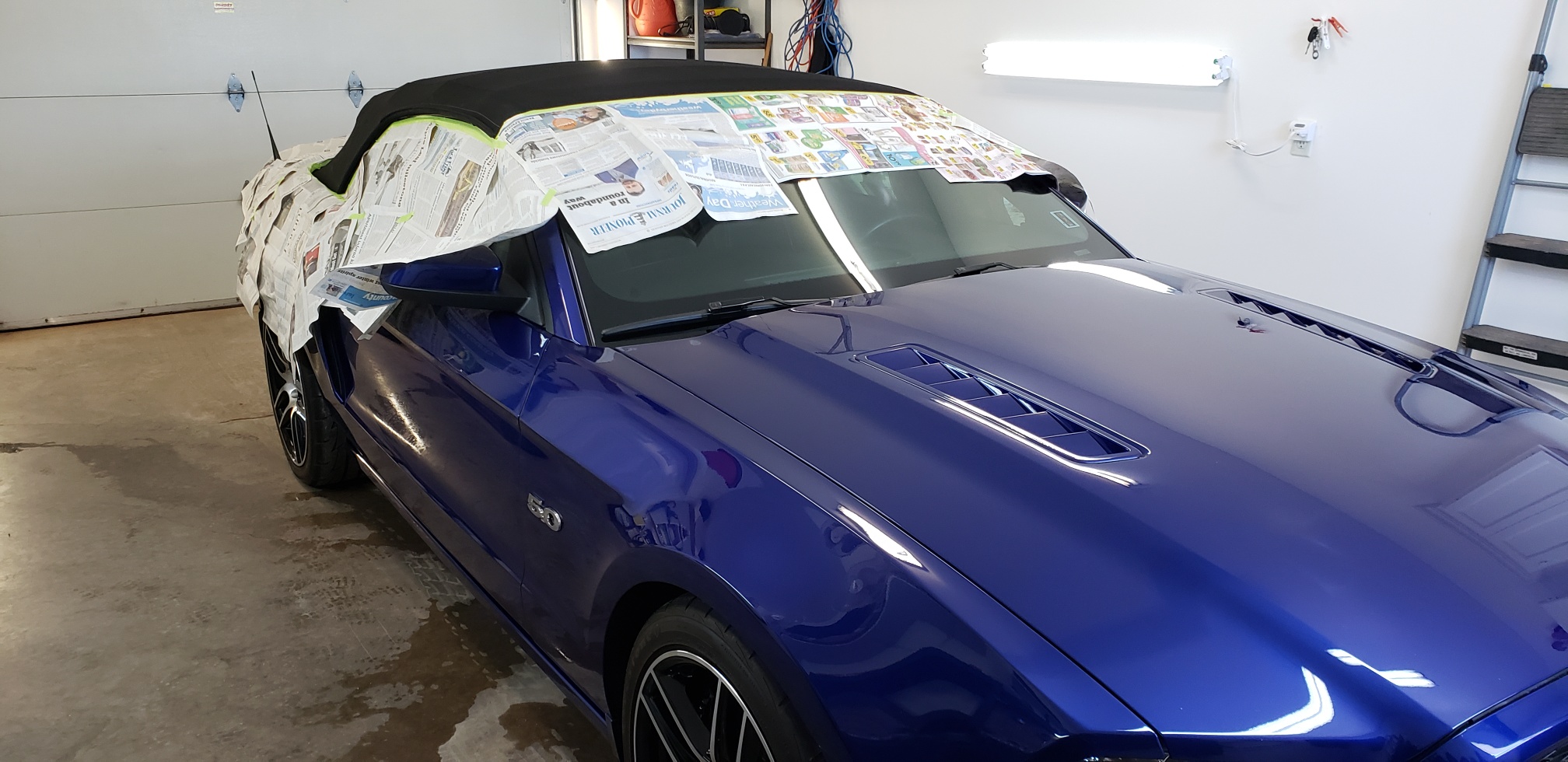

Many words - I know I should have taken pictures. Work on a cloudy day to wash the top , your top is black so will dry fast in the sun. Wet the car top and the whole car , spray cleaner on and use soft bristle brush - (horsehair ,Mustang,pony? Lol) to clean the top . You may have to do several times. Rinse well - rinse again - and again. Once top is dry - now the sun works for us it’s time for the protectant .
I spray the protectant when the car is inside the garage so I don’t have to worry about the wind.
I opened the car windows about 1” and released the top latches and put a 2” block to hold the roof open a bit and put some old blankets over the windshield / hood under the unlatched roof, through the side windows over the doors and across the trunk to keep the overspray off the rest of the car. I taped up the trim around the car / roof as well to allow me to get good coverage at the bottom . Spray light coats - alternate directions between coats, front to back, then side to side to get better coverage , let dry 15+ min between coats. I may have went a bit heavy as I just got 3 coats from the can .Clean the spray off the windows or trim before it dries each time . With the roof released the fabric is not tight to the trim so you can get the normally hidden places treated as well.
Gerry Wow thanks for the in depth write up. I did not realize how much prep hoes into it but I want to make sure everything is protected. I am sure the write up will help others as well.

Charlie....prep for my last top treatment. Saves a ton of overspray clean-up even if you're super careful.
View attachment 44966is the over spray cleanable ? I looked at a convertible yesterday and the guy said he just did the tip but there is over spay and smudge everywhere .. might buy it today but want to make sure it can be cleaned up ..sorry buts it's not a Mustang
