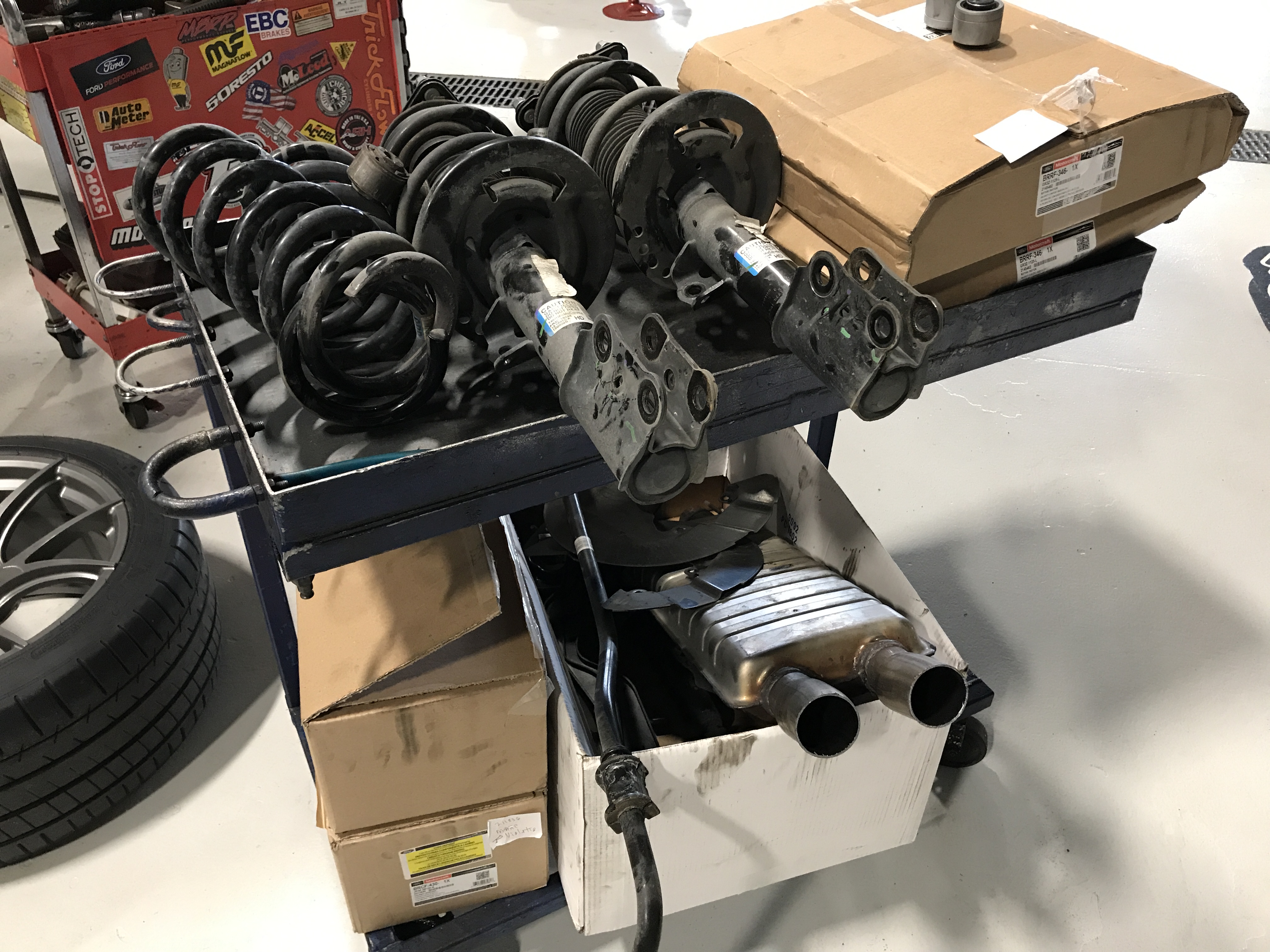

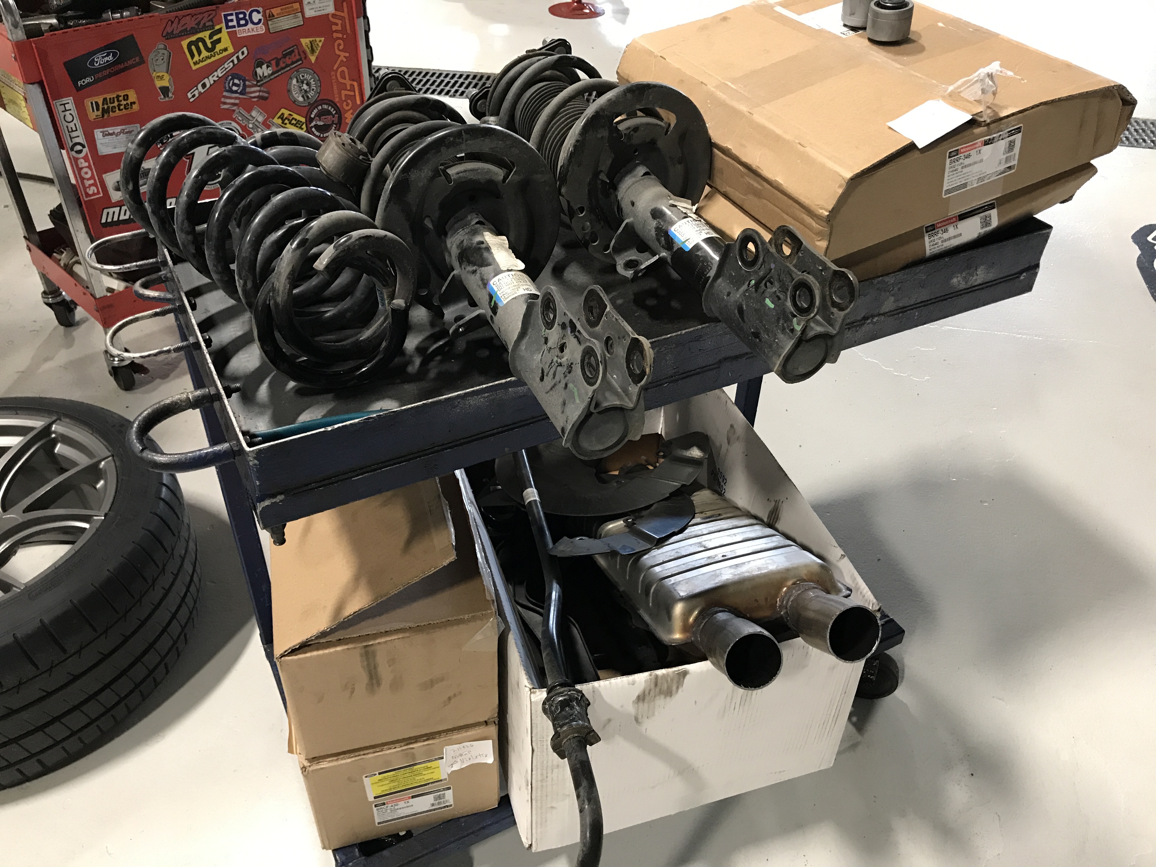

It’s not resonatorS.
It’s one big suitcase size resonator.
You’re going to drop about 30 lbs of weight by doing that mod and it will breathe more freely, enough to net you a few extra hp.
I forget the exact catch phrase number but somewhere between 5 to 8 hp comes to mind.
Just doing that mod changes nothing to, nor does it affect your variable exhaust in any way.
It will keep your cats as well.
It’s a very safe mod.
I have it on my ‘15 and Mike from St-John has it done to his Mach 1.
A very good quality H pipe, and is the one Mike has, is the Roush H pipe.
I have the Mishimoto H pipe.
It will sound a bit throatier or deeper as you mention but it will be a bit. Just a bit louder than with the resonator in any given exhaust mode.
But with the variable exhaust, you can control that.
I don’t have a before picture on the car, but you can see the size of the resonator in the white cardboard box in this picture.

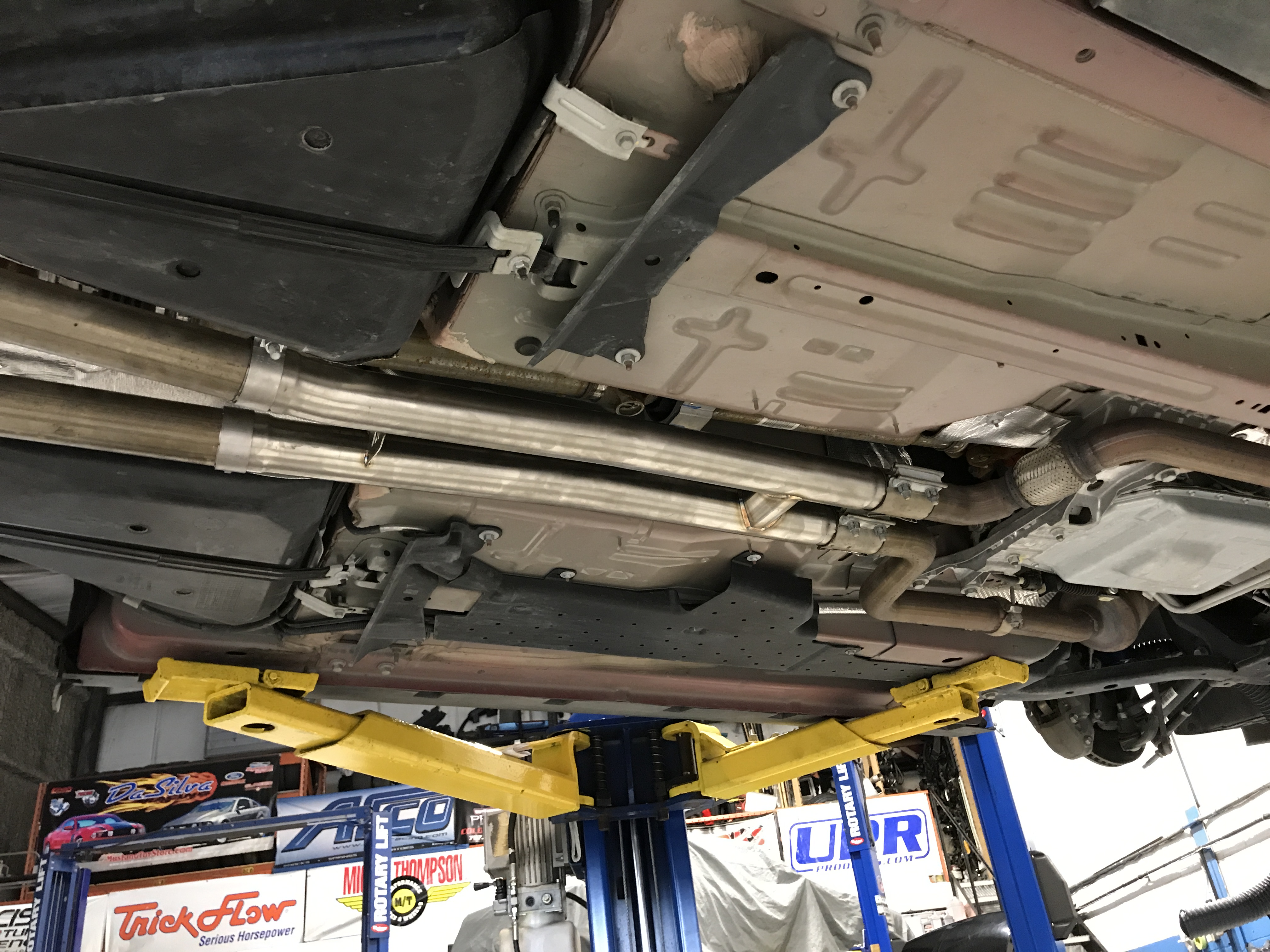

This is the finished result with the H pipe in place.
Very clean and does not even come close to touching your mufflers in the back.
You can see the down pipe from the manifolds is also not touched or affected.
You see the LHS cat on the other side of the transmission.

Wow thanks for the quick suggestions. Very much appreciated. Yes I have gone on you tube and listened to a few pipes so far just trying to get real life info as well as I just started. I am leaning more towards the H as I like throatier vrs raspier I guess. They do each have their unique sound. I didn’t realize it was one big resonator and the weight of it. That’s crazy. I heard you did gain a few HP because it breaths better. I will check out the suggested pipe brands as well. Louder and a nice rumble is exactly what I am aiming for. I would like to keep the cats for now. Lol

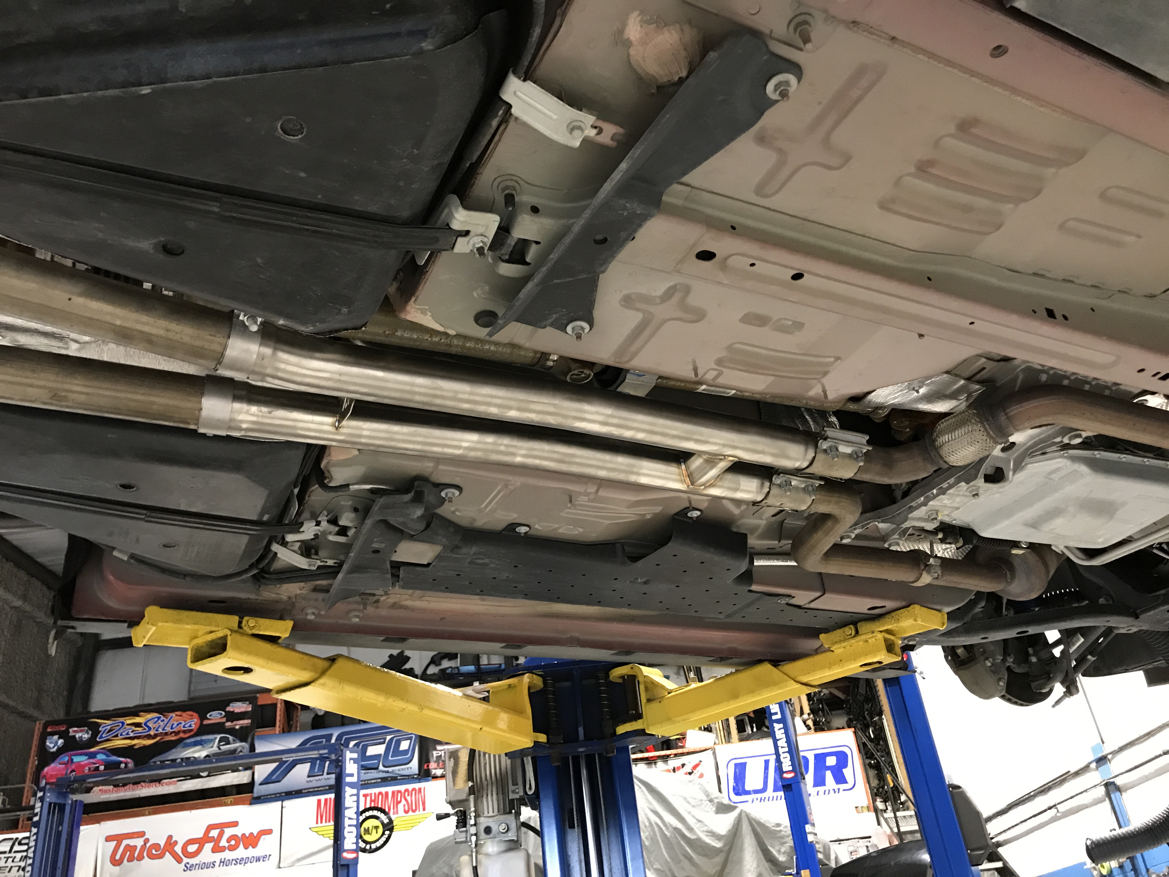

That definitely looks nice and clean Marc!!
