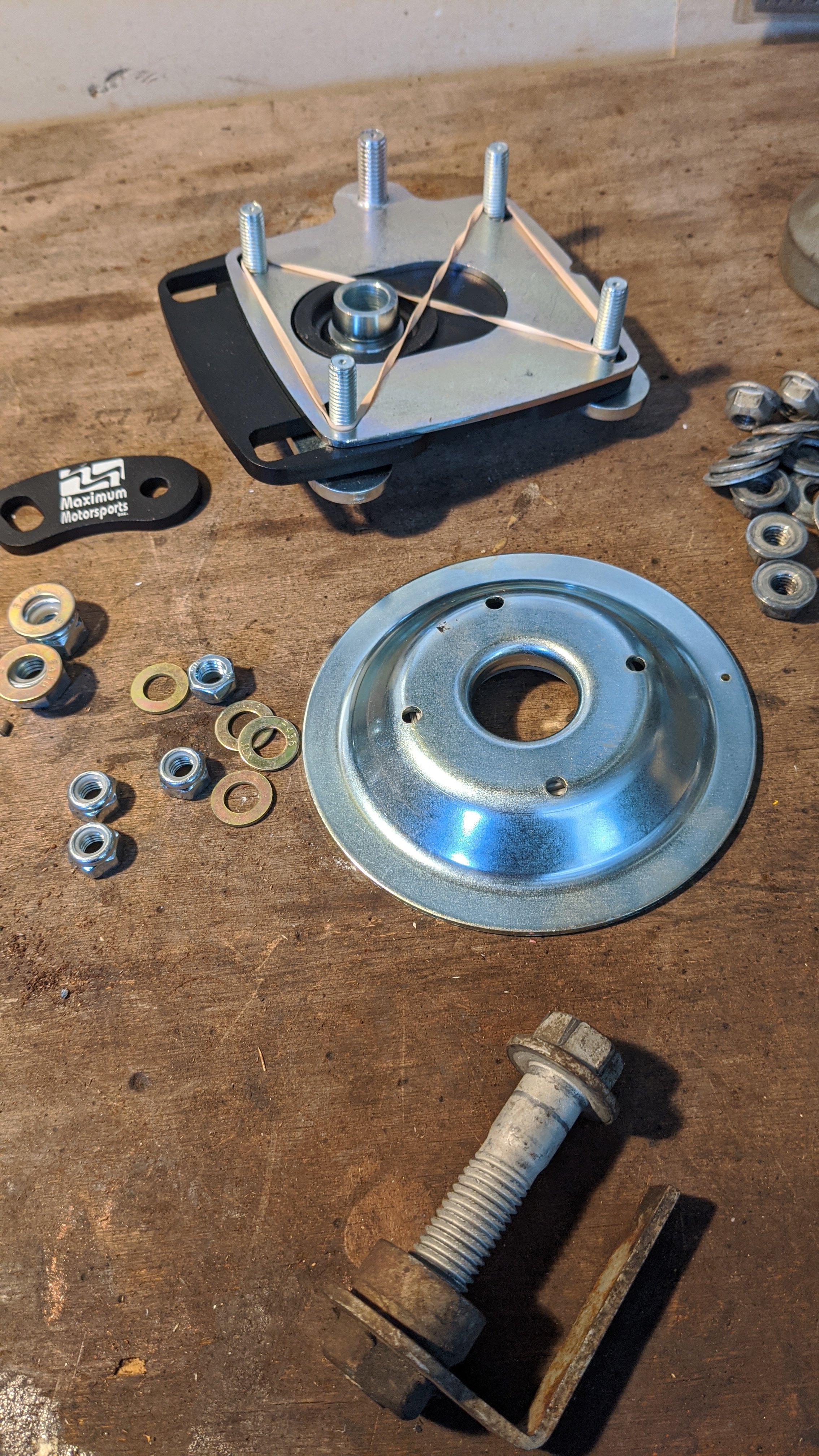

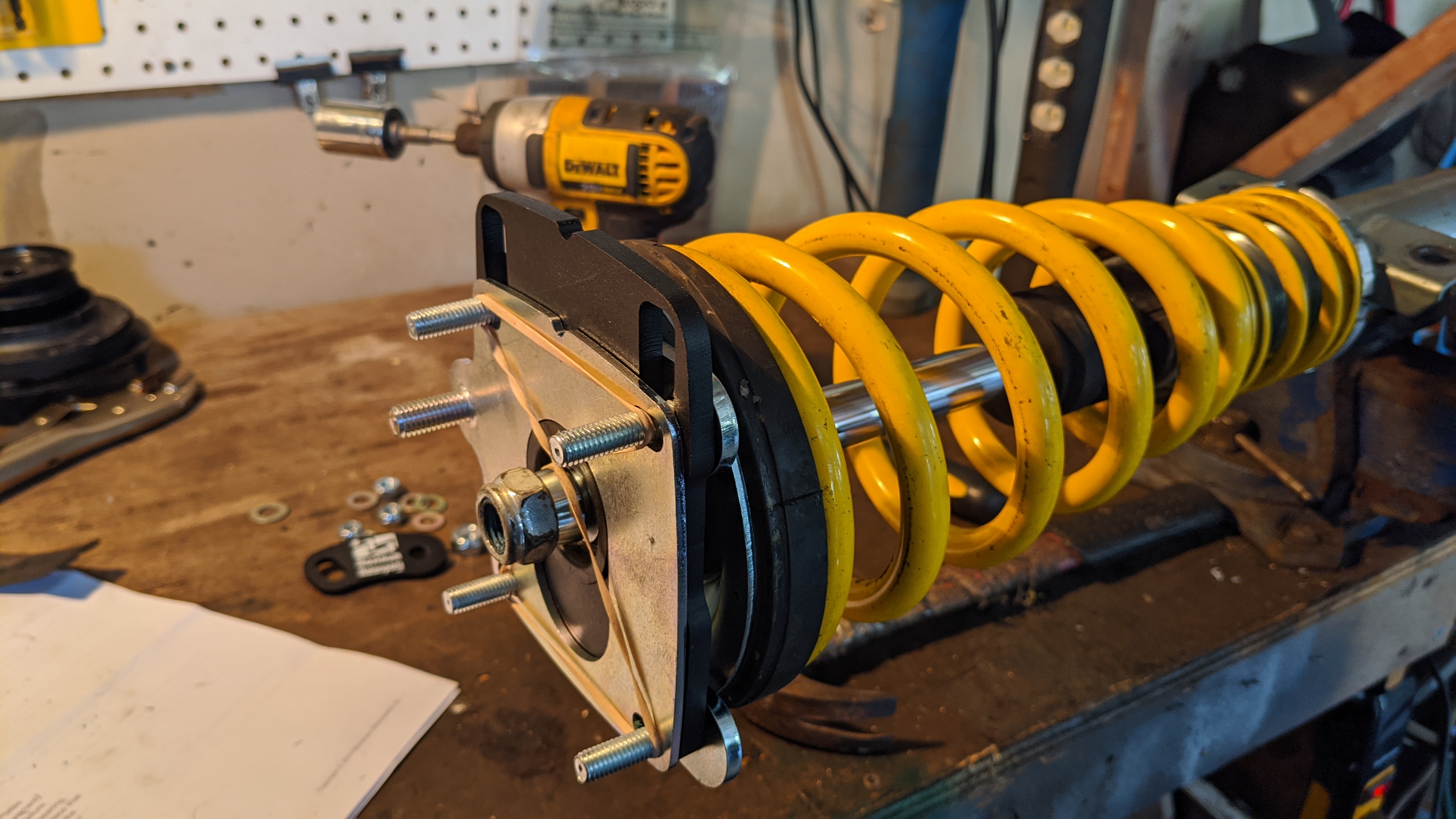

Maximum motorsport CC plates came in this morning so put them on , I'm impressed on how much adjustment there is in them ..very easy to install, just have to drive to Fredericton to pick up my plasma cutter from my brother so I can modify my strut brace to put back on

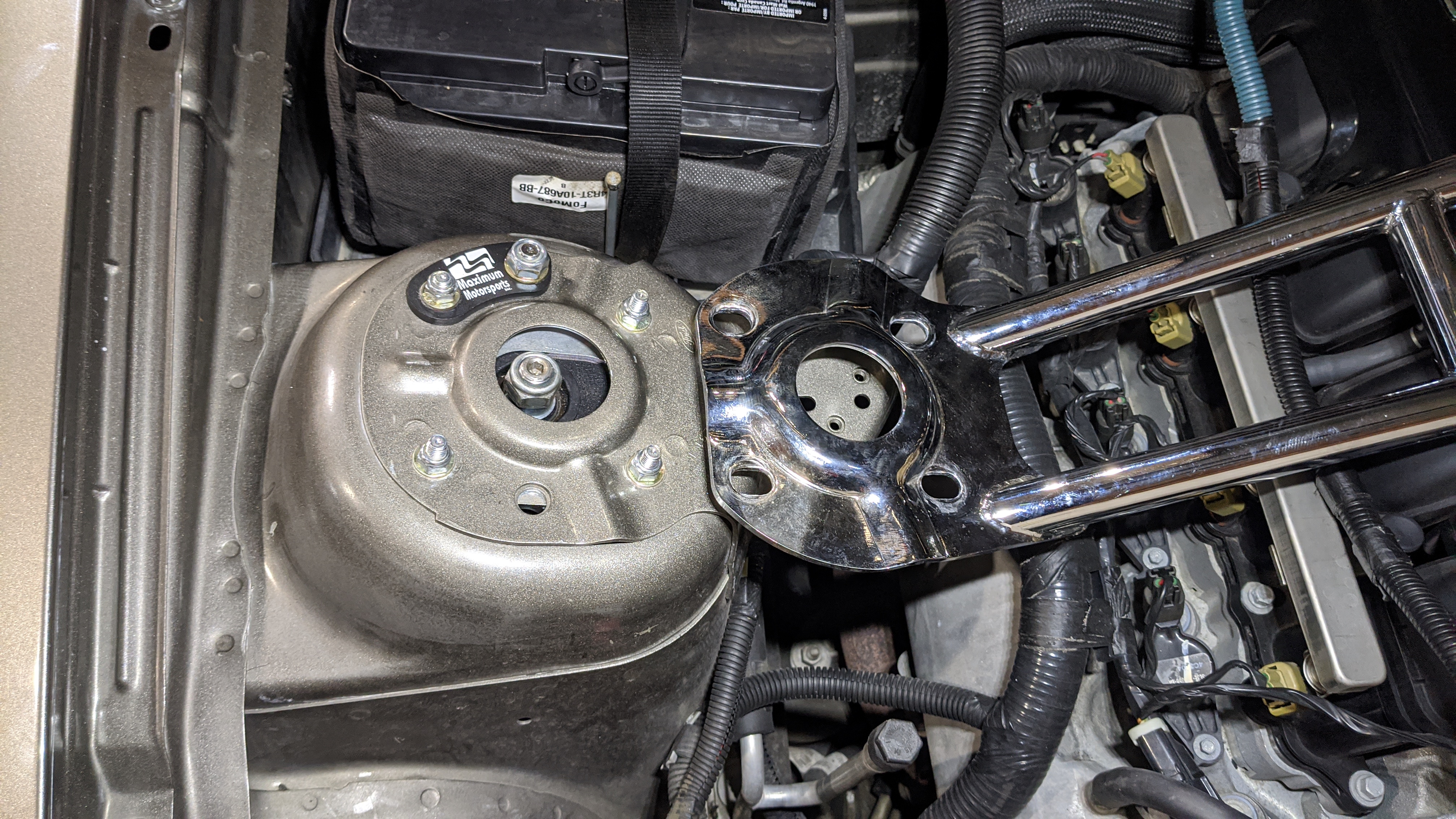

Steeda brace?
Yah, you'll have to remove the two outboard holes and surrounding metal.
Should fit after that.
If you want a clean, unmolested look later, I still have my Ford Racing GT brace.
Fits like a glove and no evidence of having cut anything.

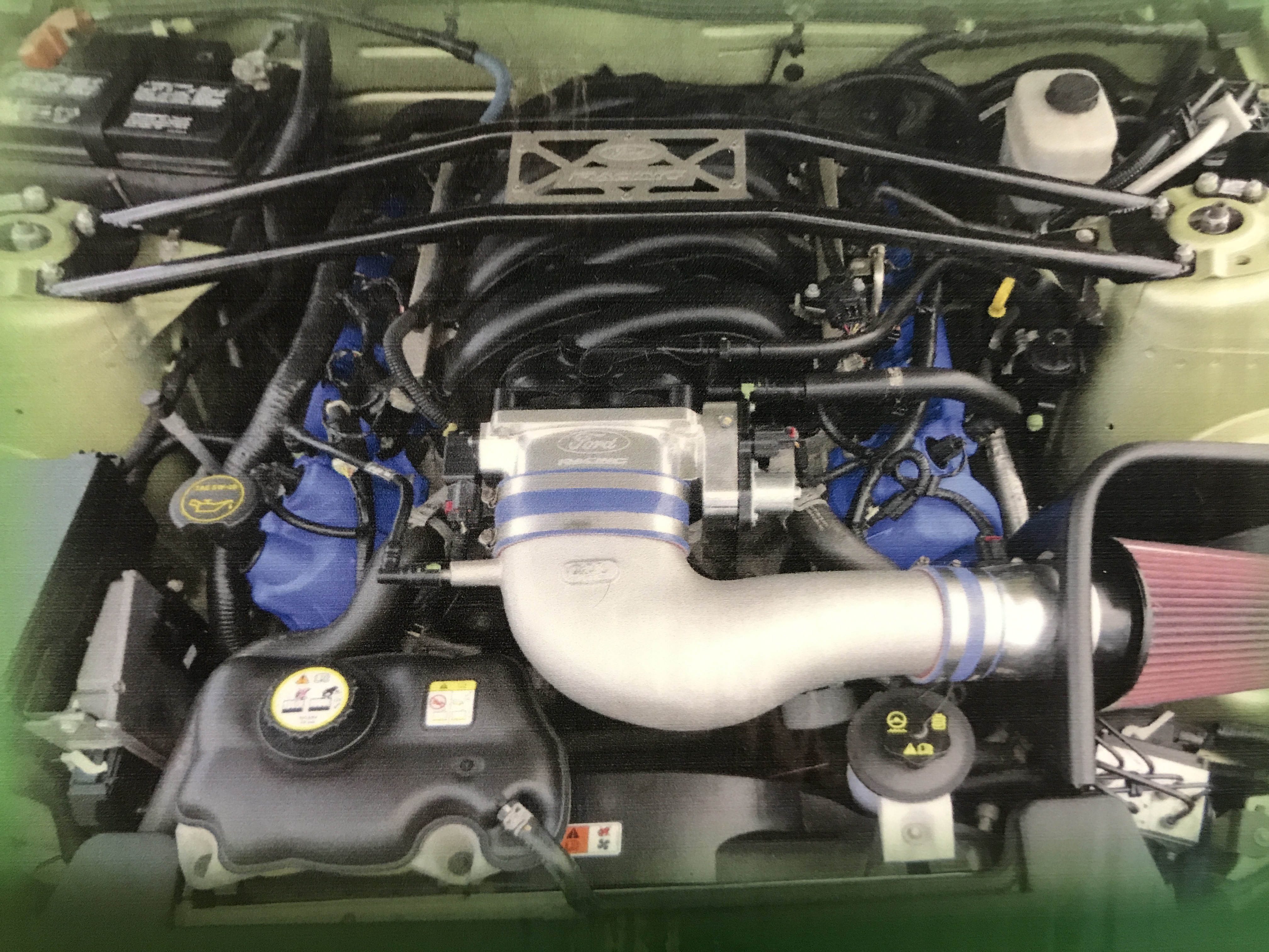

Had this pic in my phone from few years back.
Prior to JLT CAI and ported heads.
I believe its a Stack Racing strut brace ..
I will trim it down for now , but i do like the black instead of chrome ..might hit you up for it

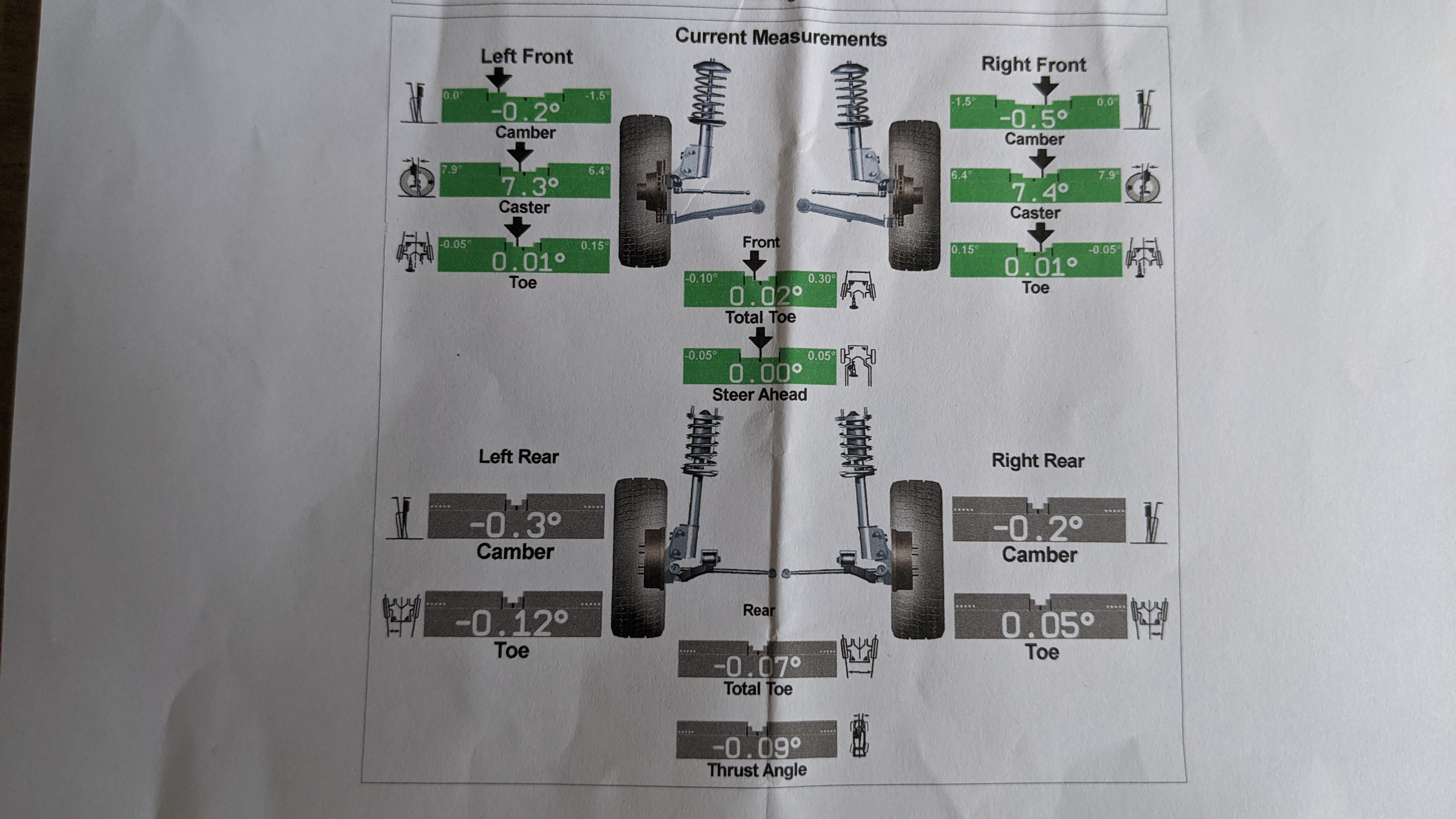

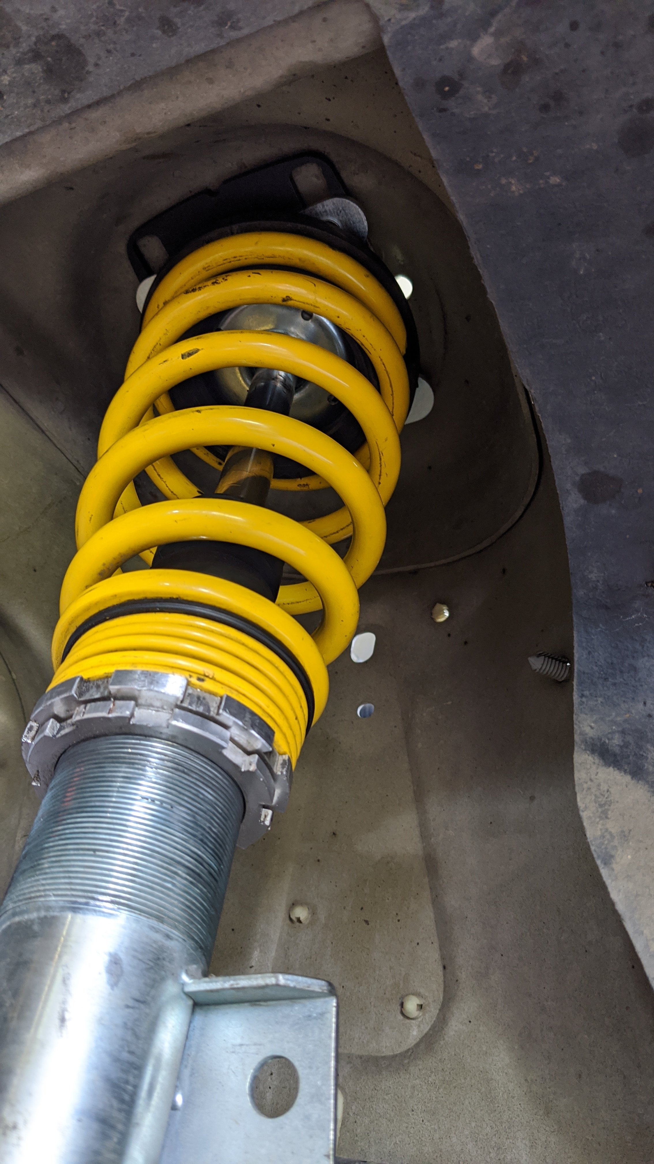

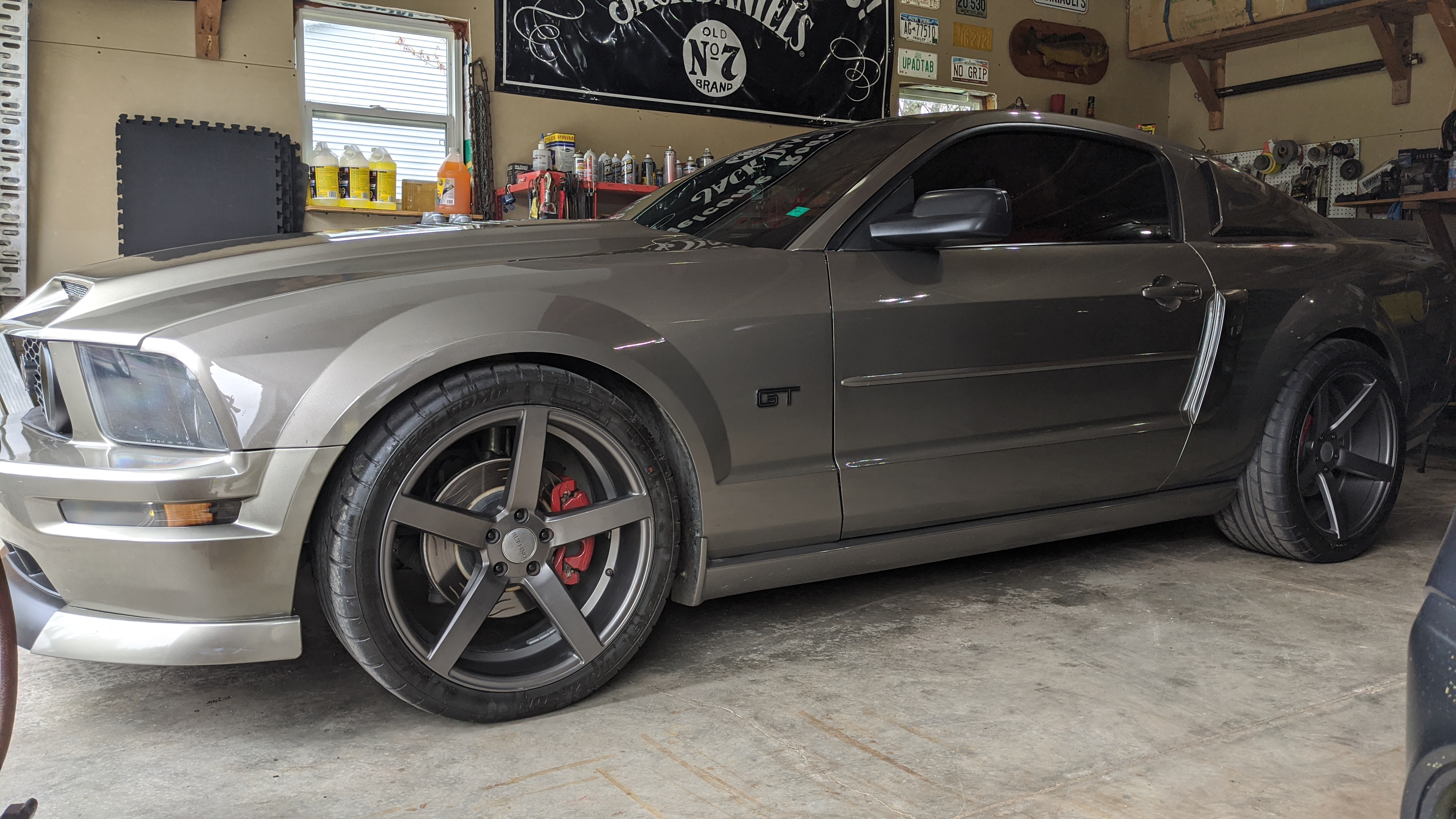

Got car in for an alignment yesterday afternoon after some coilovers tweaks, car seems to drive a bit smoother than before, does not ride as rough over our far from perfect roads , so far pretty happy with the all new suspension , and new JLT cold air .

Just missing the run to Pete's to finish it all off, Al.
Looking good!
Looking good!
Yep , will miss the trip this year for sure , the suspension was needed as front tires kept getting chewed up so replacing everything in the front was the only cure..( new ford racing lover control arms , Moog tie rods, ST coil overs, and MM CC plates feels good. But was planning on new LTH and Ford Racing Camshafts for Pete to dial in for me .. well there's always next year.. might have to come out if retirement to make some money first though ..
