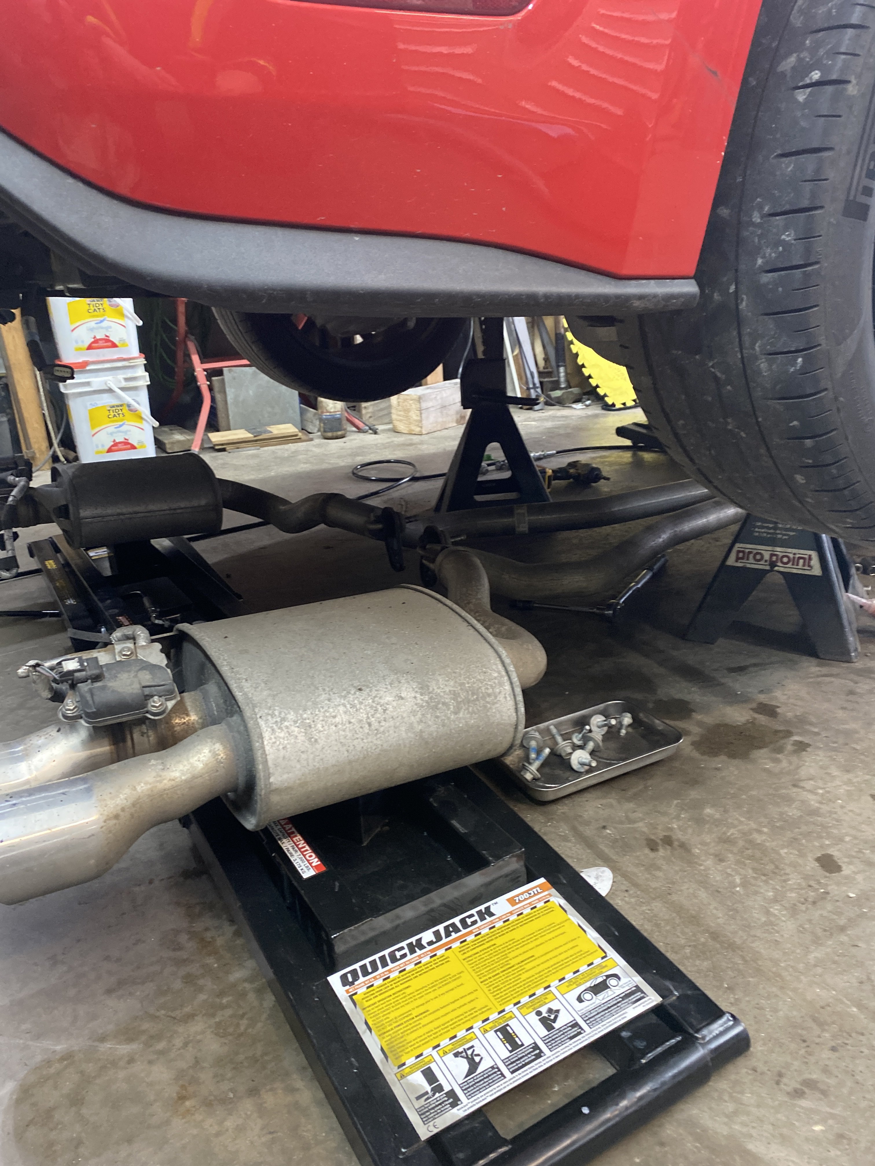

There is a lot of work, parts to remove to make room to drop the transmission 4” so one bolt can come out holding the shifter to the transmission. The shifter mod is simple if all the parts are machined correctly. I found the quick jacks can also be used as a second and third helper when reinstalling that one piece exhaust system !View attachment 93715

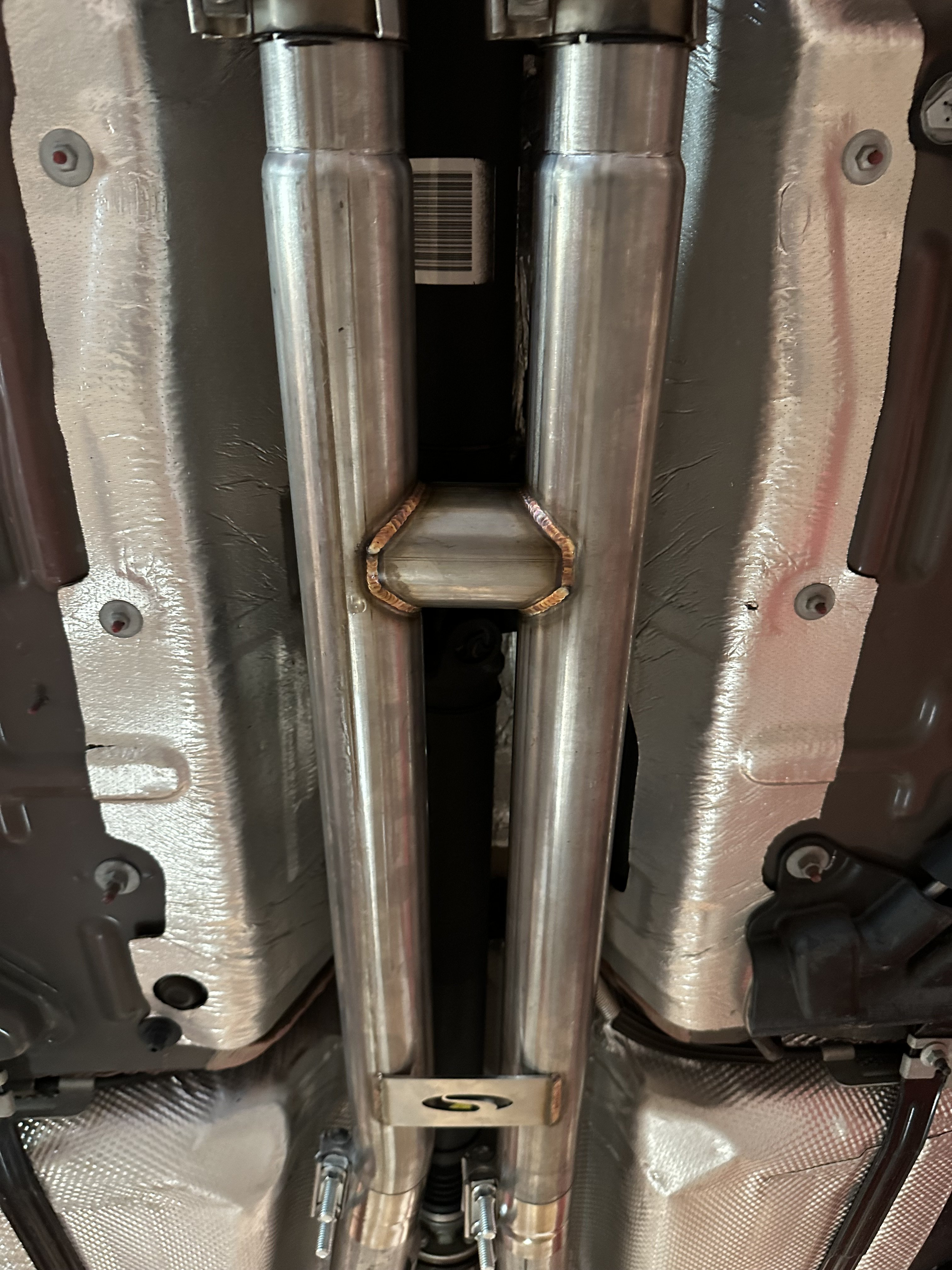

I installed the Steeda H Pipe and its Hands down the best mod I could have done to the factory active exhaust. That Resonator weight a lot.

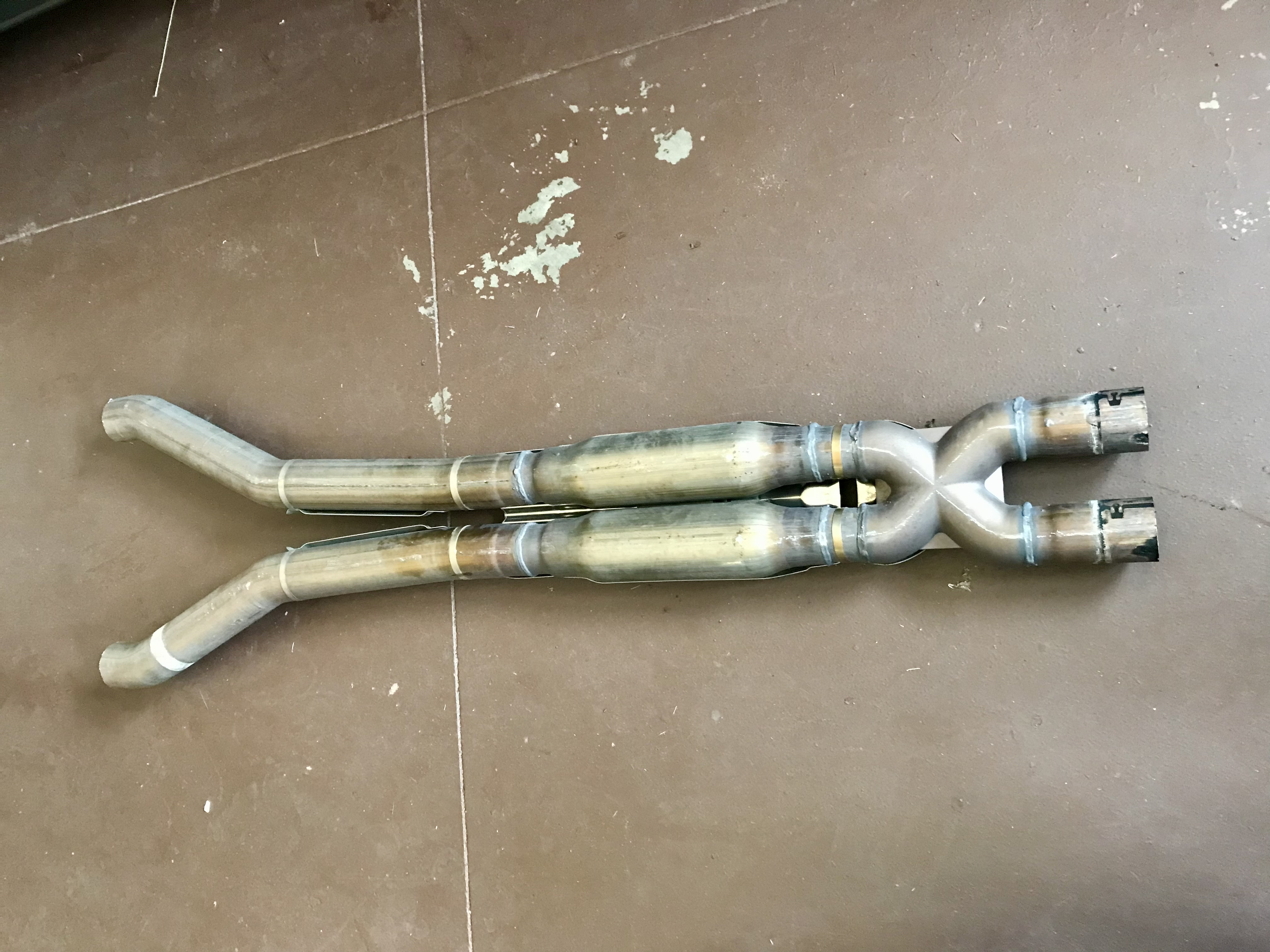

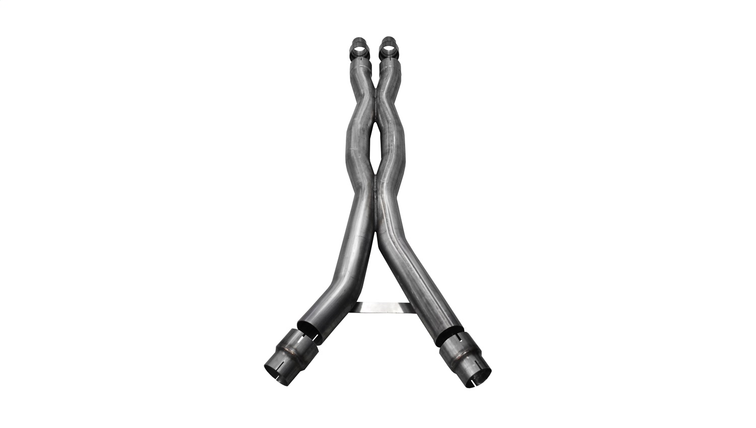

Corsa resonator delete, google pic, but you get the idea. Really happy with this one, did this mod five years ago.

Note: the Corsa res delete pictured above will not fit the GT.
That is a GT350 specific piece.
The exhaust systems of both cars are not the same and parts are not interchangeable.
