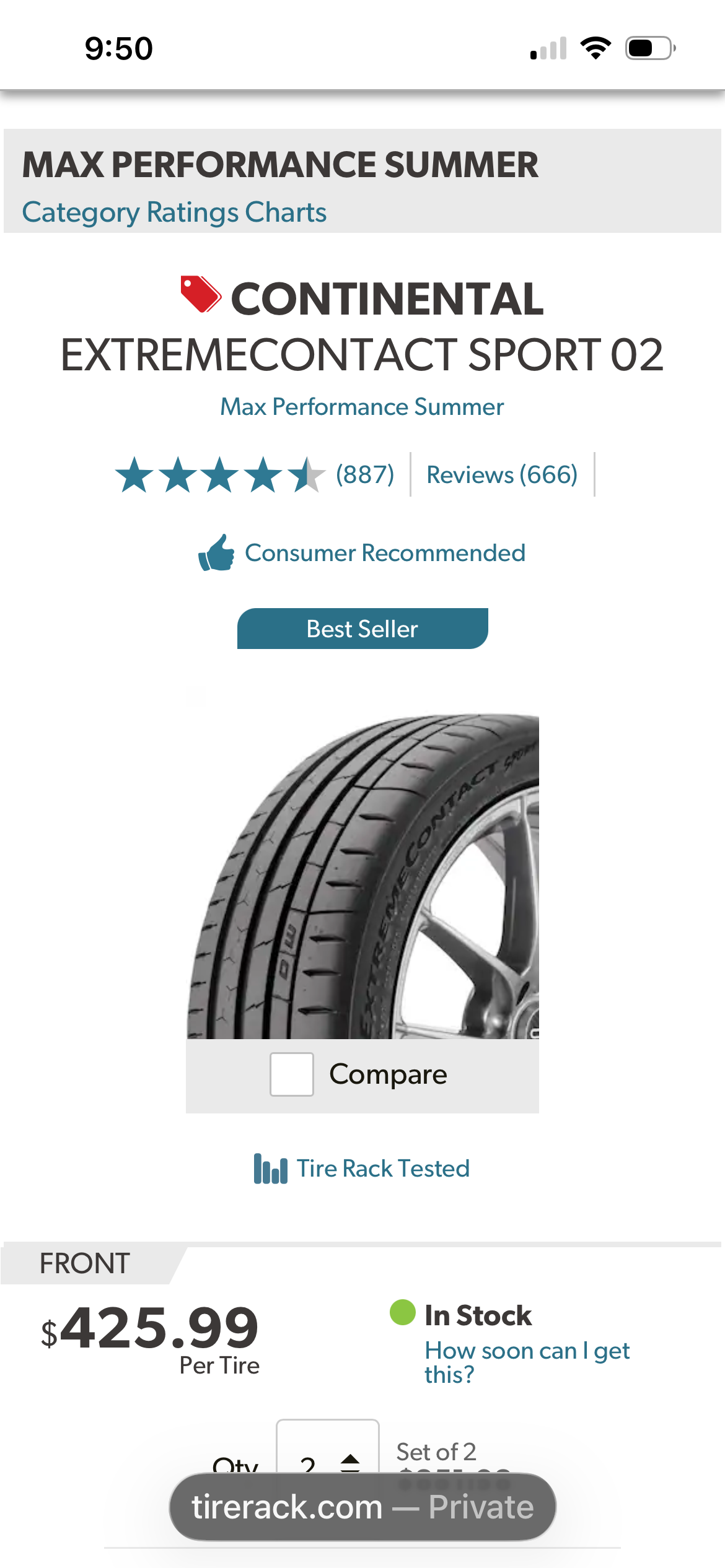

It's tempting to go to the GT350R set up with the Pilot Sport 4S's , from what I can see they're a little less expensive.

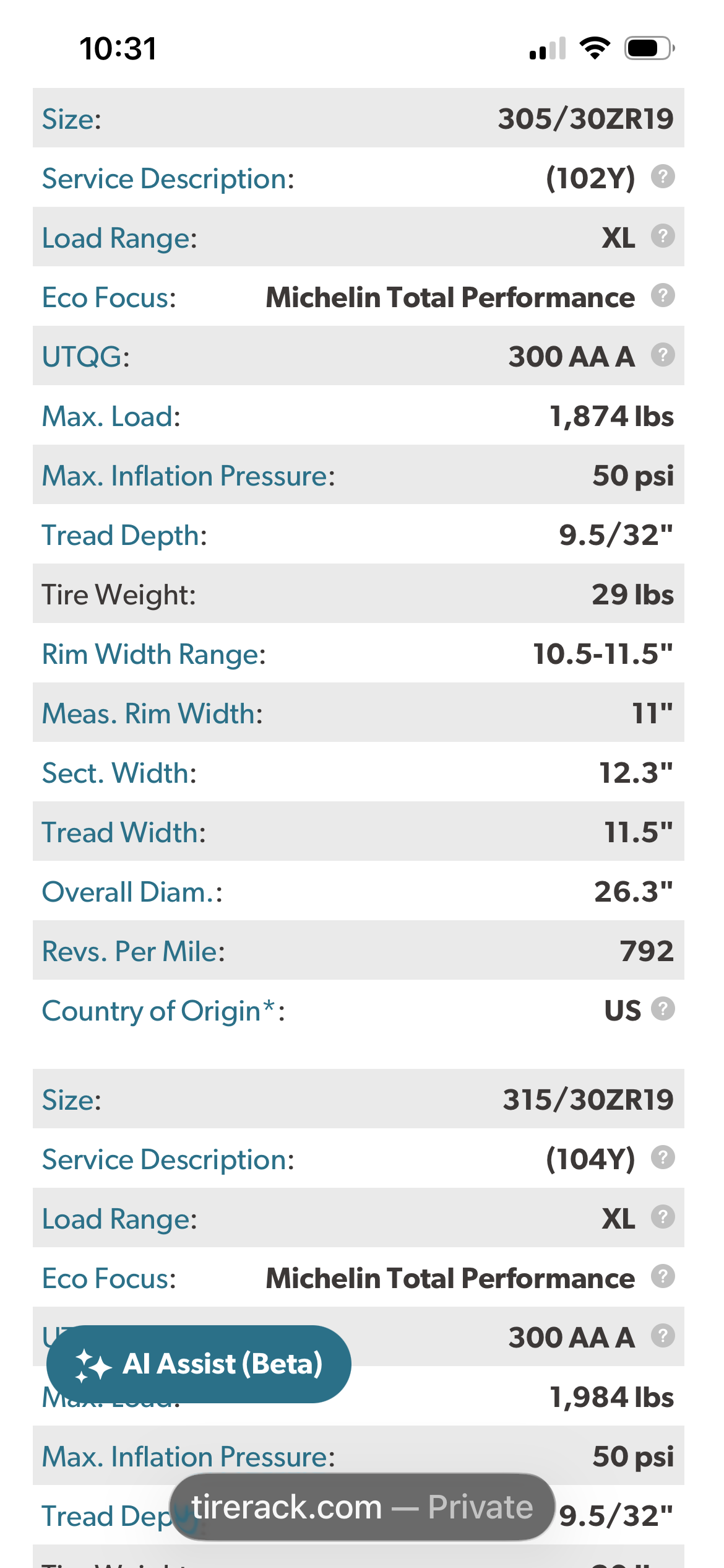

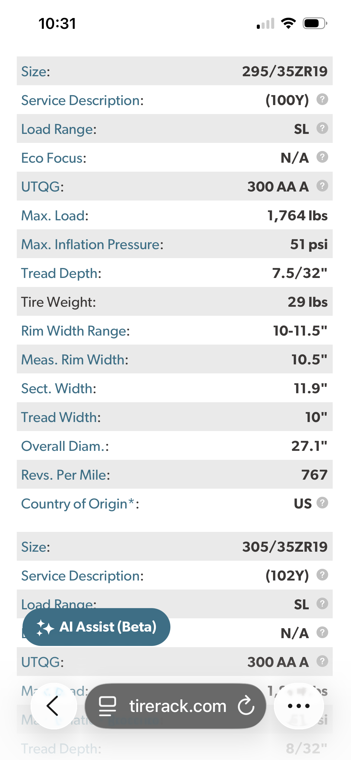

Since you mention this option is a possibility, and in case this variable is not on your radar, be aware that if you do go with the GT350R size tires, your car will be almost a half (1/2”) inch lower than with your original size tires.
The reason is due to the 30% sidewall ratio on the R tires as opposed to the 35% ratio on your OEM tire size, making the overall diameter of the R tires smaller.
Your front splitter will be that much closer to the ground.
The diameter of the front R tires is 0.8 of an inch smaller and the rears are 0.9 of an inch smaller.
I attach screen shots of the front tire specs from the Tire Rack site.
Look down at the overall diameter numbers.
Screen shots #1, 295/35/19 specs
Screen shot #2, 305/30/19 specs
