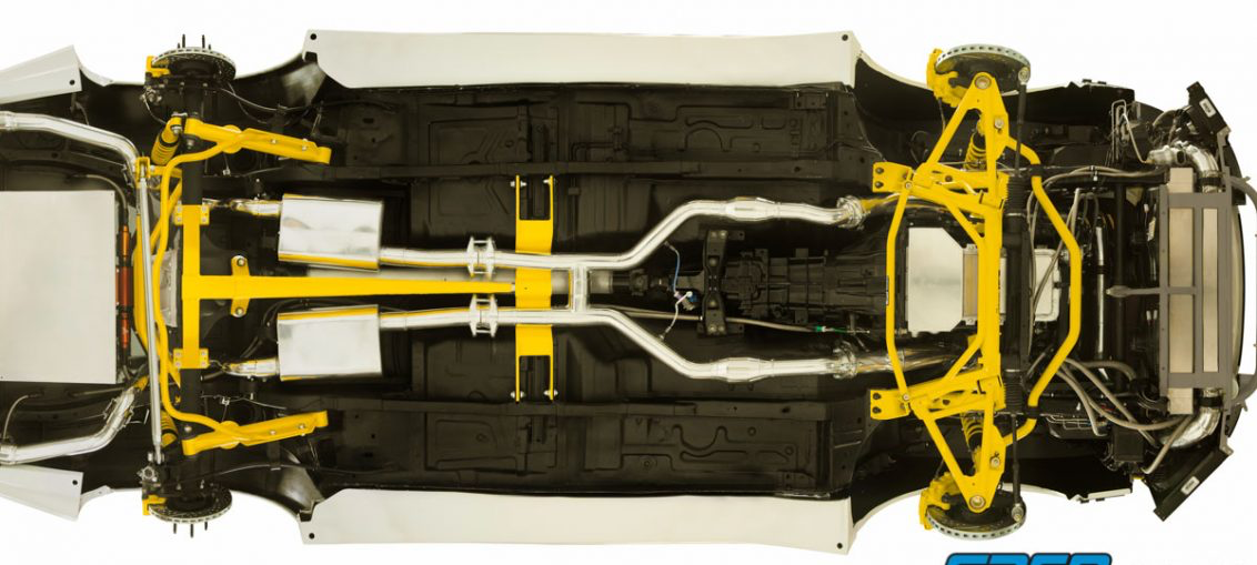

Rear sway bar location will likely affect fuel cell placement
Will be tight, but should be ok, fuel cell is smaller than orignal tank.
but everything will be tight.
Cool picture. Explains quite a few things about the grip package. The 4 link of the fox body becomes a 2 link with the upper 2 links being eliminated by the use of a torque arm and a pan hard bar. The angle of the lower links means you still have to use a 4 link rear axle. The sway bar and lower control arms in this picture are not the sway bar and lower control arms shown in the grip package. The question now being does the sway bar mount ahead or behind the axle in regards to the fuel cell. I would assume it mounts behind the axle and may restrict room for the fuel cell.
You could be right and I might be wise to wait on install of fuel cell
until after the suspension is done, ( this was not original plan)
It would not affect the over all build by much and would not cause delays.
waiting just means one more trip about 1km down the road is where my weld
shop is, so not a big problem.
