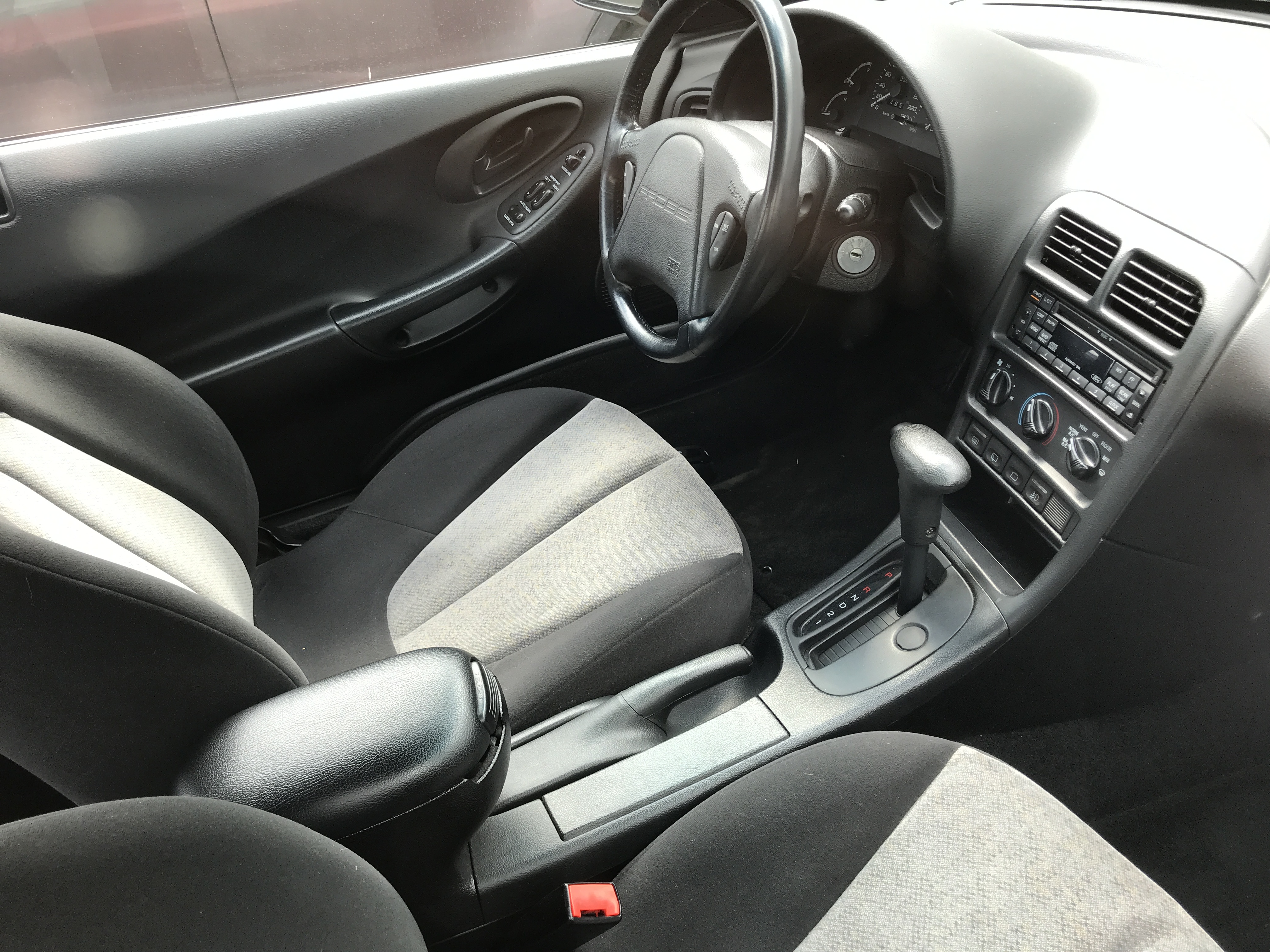

You’re right Trevor.
Probably too easy of a question but I thought using the pictures would be a nice change
This particular example is a 1997.
I took these pictures Friday afternoon.
It belongs to my cousin who owns the dealerships.
That might be right about non Ford parts.
I took a pic of the engine bay.
It’s a 2.5L 24 valve V6 and the first thing I thought of when I saw it is how it reminded me of the Yamaha engine in the old Thunderbirds.
The name plate on trunk to confirm what it is.
