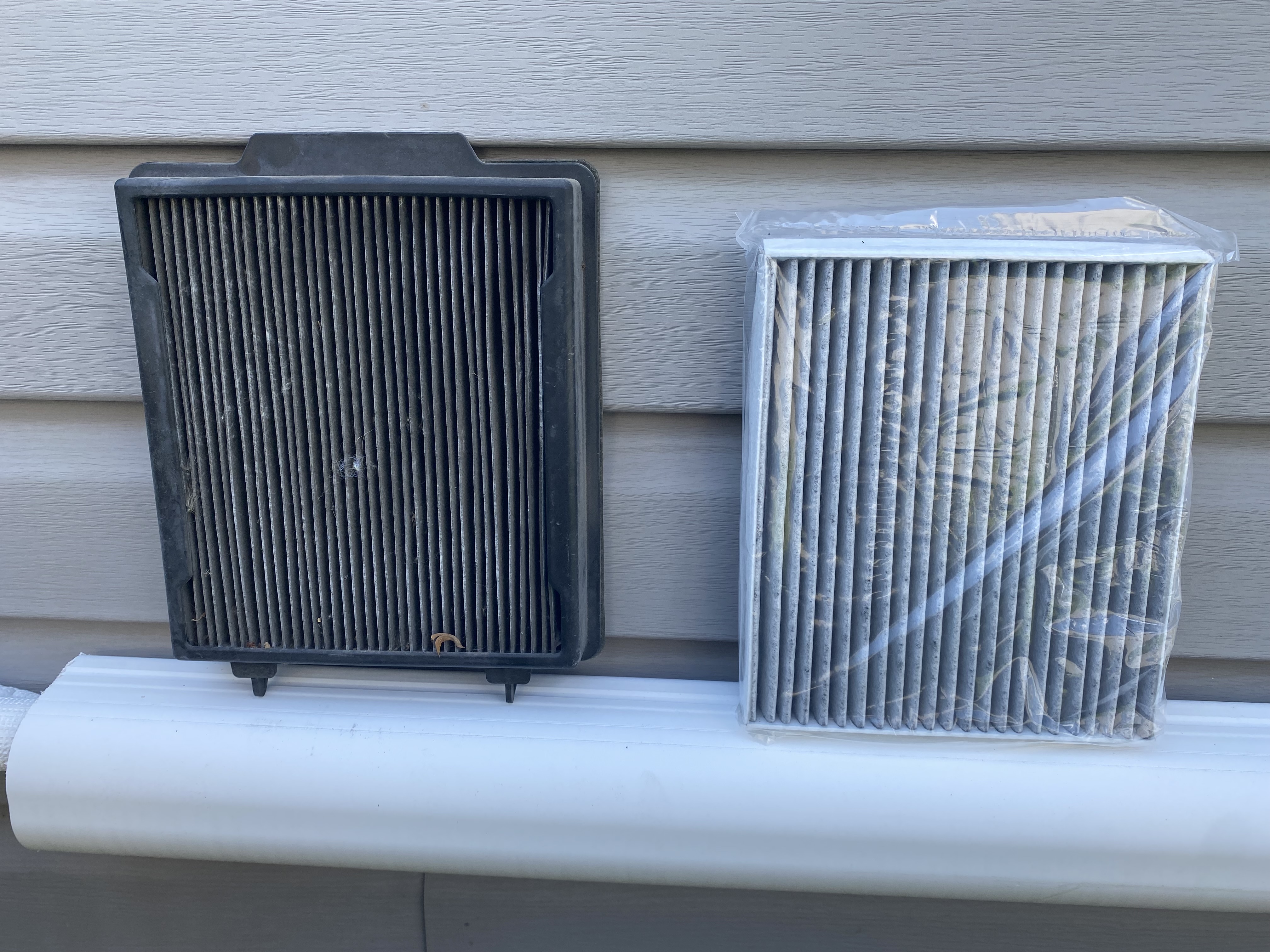

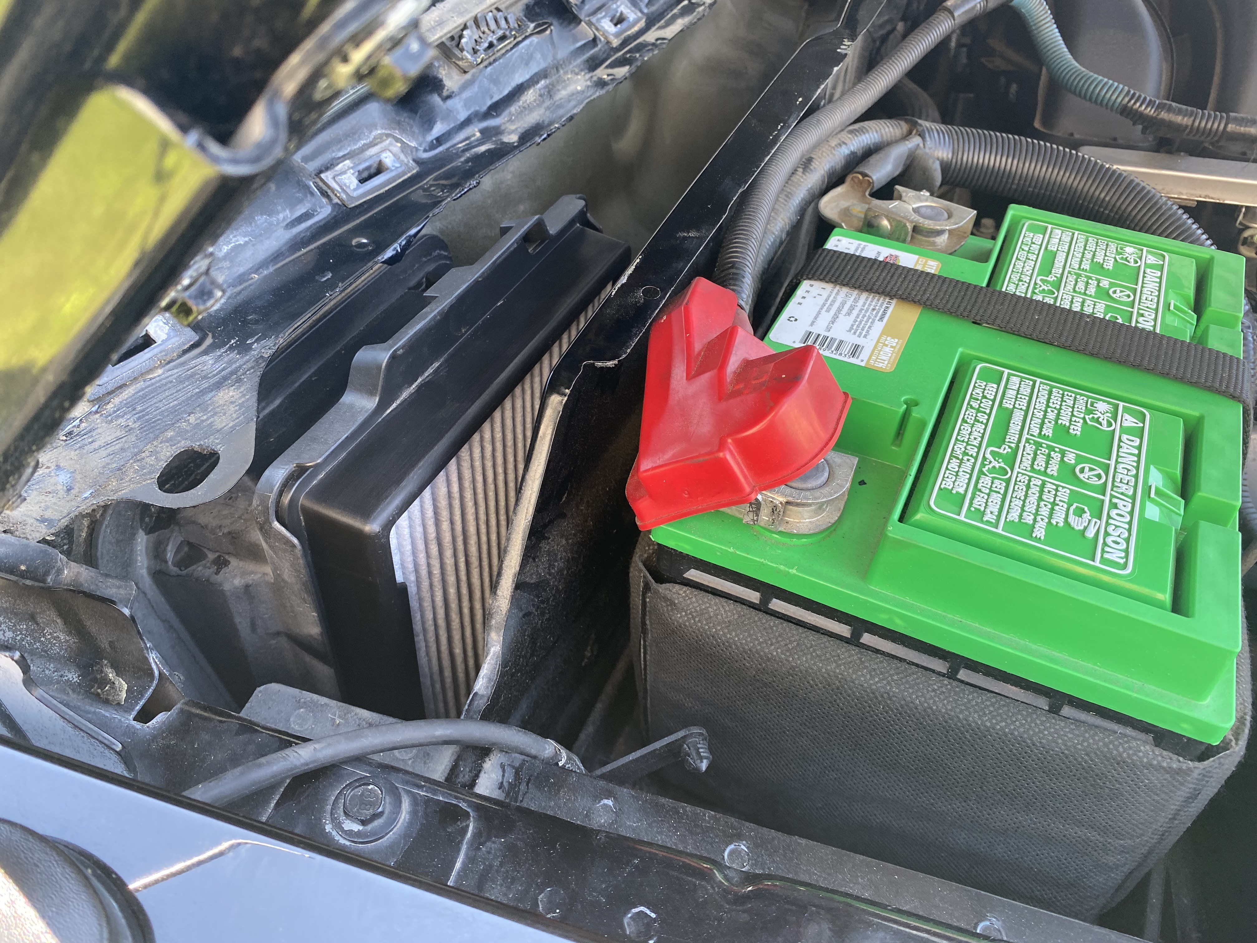

So, two weeks ago (same weekend as above post), I have also opened the cowl & replaced the cabin filter, which was in a more than due condition...
I've also proceeded with performing the test Gerry is referring to in the above post, but it didn't change how the car ran. I've, since being under the car to unplug, have replaced the evap solenoid that is with the charcoal canister at the back of the car as well.

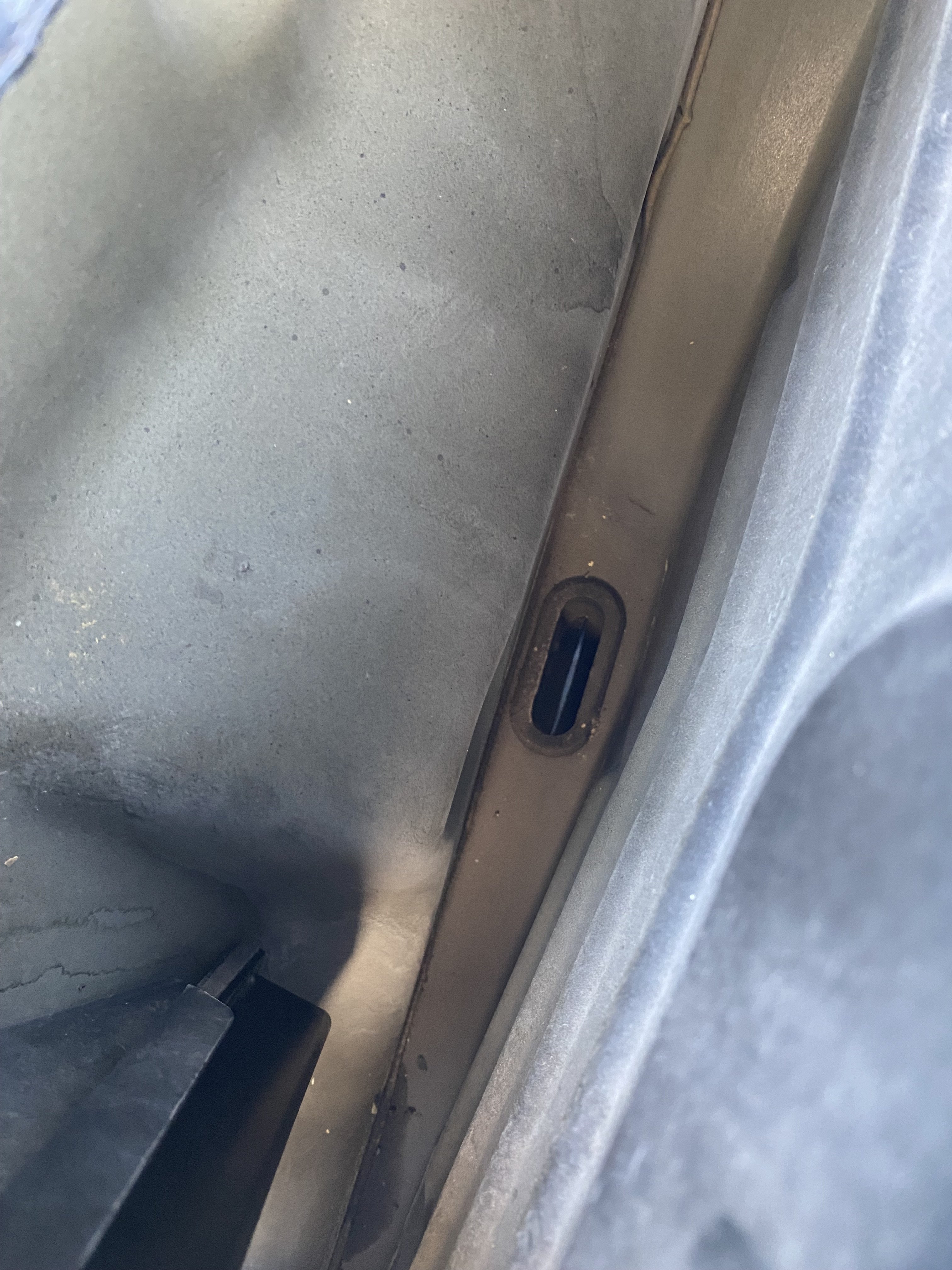

What I haven't confessed yet here is that I also discovered the day of the X pipe install that I have the mysterious water leak in the passenger side floorboard that plague a lot of S197. The first thing I looked for was the two drains in the cowl. As you can see from the pictures following, mine was clean and clear (can see daylight through). Not so much as a twig in there! I instantaneously knew I had something else going on.
