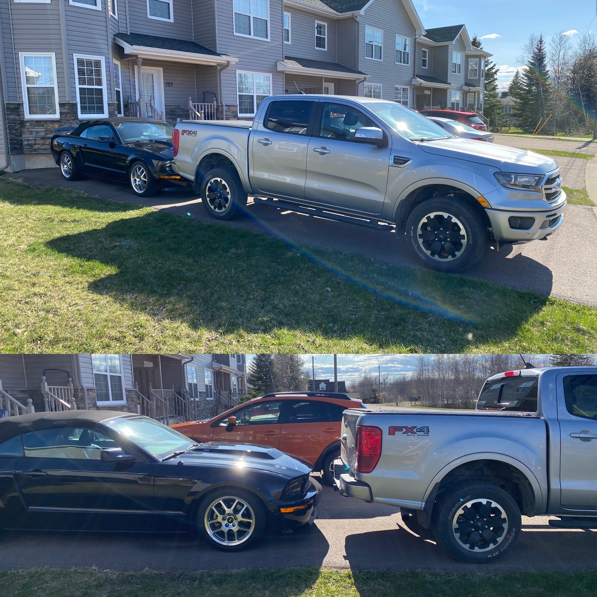

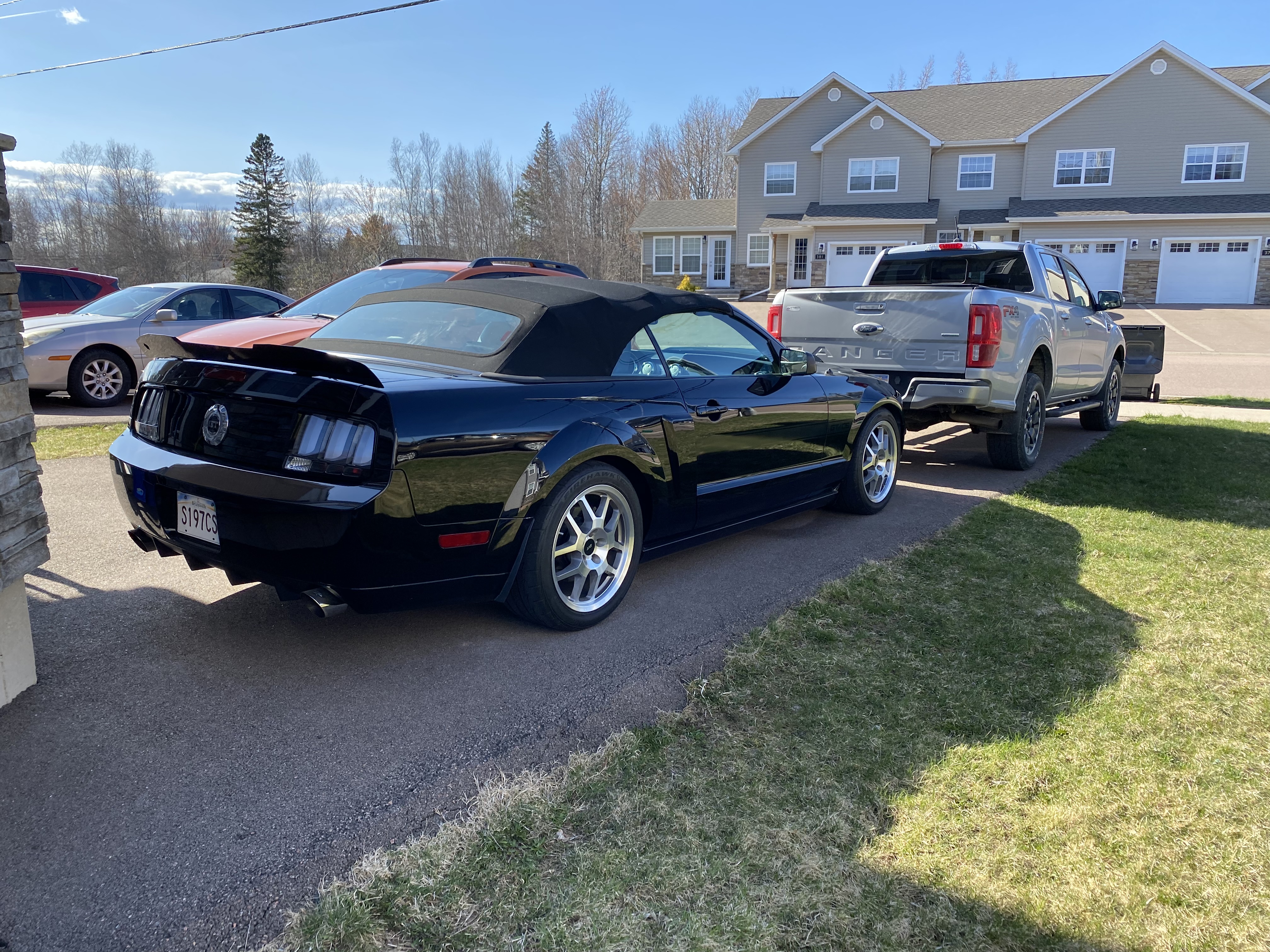

Well, She's now back home to start a new season. First order of business in the coming weeks will be to have it checked over to try and find whatever is still going on.
I have unplugged the fuel sensor vacuum line yesterday to test a theory right at the sensor, and at least no fuel got out of that side, good thing for the test itself, but it didn't either alter the idle that much (maybe went up a few 100RPM?). Next up compression testing.
At least the driveway fit passed! Everything fits in the yard, even with the Jetta replacement! Win/win!.
View attachment 55246View attachment 55247
