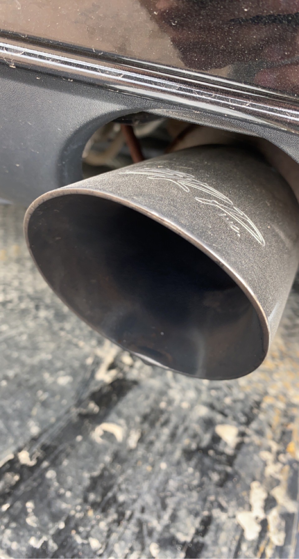

Quick update on this matter.
While chasing this problem, I am scouring the internet in hopes of finding somebody somewhere that had the same kind of issue and got it resolved or started to get a resolution.
Found a case on another forum where the symptoms were very similar: misfire at idle, misfire at little/no load, can kind of feel it misfire when it happens and hear it in the exhaust note, burnt matches/surphur smell occuring here and there. All the plugs were tight and good, pulled all coils and quickly checked and they're good. Long and short term fuel trims are hovering just around the 1% mark, telling me there's no leak at the exhaust on the vacuum system. To note regarding Marc's post above, WOT pulls feels 100% clean and powerful. If the fuel filter would be clogged, it'd be there that I would feel it. I remember it from my 2000 Escort ZX2 when I changed that clogged filter around the 260K mark.
What I started to think about after reading that tread, and it kind of make sense. THE CATS. Hear me out. When the PCM failed, it wasn't reading the Fuel Rail Pressure and temperature sensor, so it tried to correct the fuel pressure by upping it, therefore dumping more and more fuel, effectively drowning itself up. The car was pig rich, thick black smoke and bad fuel smells to boot. Now that I think of it, when pulling it on the wrecker, fuel was coming out of the exhaust (see below picture), hence why I start to believe that the cats may be having a part to do in my problems....
Am talking with my tuner right now and will send him datalogs of a drive I'll take tonight, we'll see where that goes. But if I recall correctly, for my MY car it doesn't use the O2 sensors in the tune, which would make sense why I didn't have yet a check engine light flagging them up. For what it's worth, I'll also be looking at my cats tonight with an infrared camera, to see if there's anything showing up weird that way.
Regardless, the car is going in storage as is this weekend. I am done with her for the season and do not have the $ to chuck at it right now above what it just costed me if the cats are really gone. I'll take care of that next season.
Anybody has a clever idea in the meantime of something I am currently overlooking, I am all ears.

I just feel it’s a good idea to change the fuel filter every once in a while.
Especially where you suspected taking a full tank of bad fuel.
I change mine every 5 years, along with the plugs.
Some injector misfires you can’t feel either, even at WOT.
My issue gave me a code for misfire on a particular cylinder.
Of course, the tech jumped to conclusion and changed the coil.
Issue still there.
Change plug.
Issue still there.
Now do that test that I described before.
That revealed injector as culprit.
Change of injector.
All is fine, no more codes and Bob’s your uncle.
However upon trying to tune the car on dyno afterwards with some new parts, would not tune right.
Small misfires that did not throw codes but tuner could tell they were there.
I advised of my earlier issue with one particular injector.
Tuner did not waste any time.
Grabbed 8 slightly used FR injectors of the back parts shelf and put those in.
Car tuned right up and laid down good numbers.
I’m thinking your tuner should be able to talk you or your mechanic through a way to eliminate or confirm catalytic as trouble.
Cars can run without cats.
That’s what off road setups are.
Just need to remove or swap O2 and exhaust sensors, with appropriate instructions to computer, to bypass or simulate cats being gone.
See if that changes anything.
I wish you luck with that.
If you do conclude, next year, that cats are faulty, be opportune time to do long tubes with high flow cats.
They would maximize the output of your cams.
Filters are cheap and I change the often, fluids are also cheap, I change that often as well.
My 08 had problems after installing SC and checked coils, all checked out according to computers at Ford.
Could find miss, starting changing one at a time, sure enough one was bad, computer siad it was ok, but ahh NO.
I changed them all.
I agree with Marc, between tuner and Mechanic, they should be able to sort out.
I get the $$$$ but even if not fixed now, I would need to know problem before putting away lol
Long winter of driving you crazy LOL. find the problem and fix in spring IMO.
