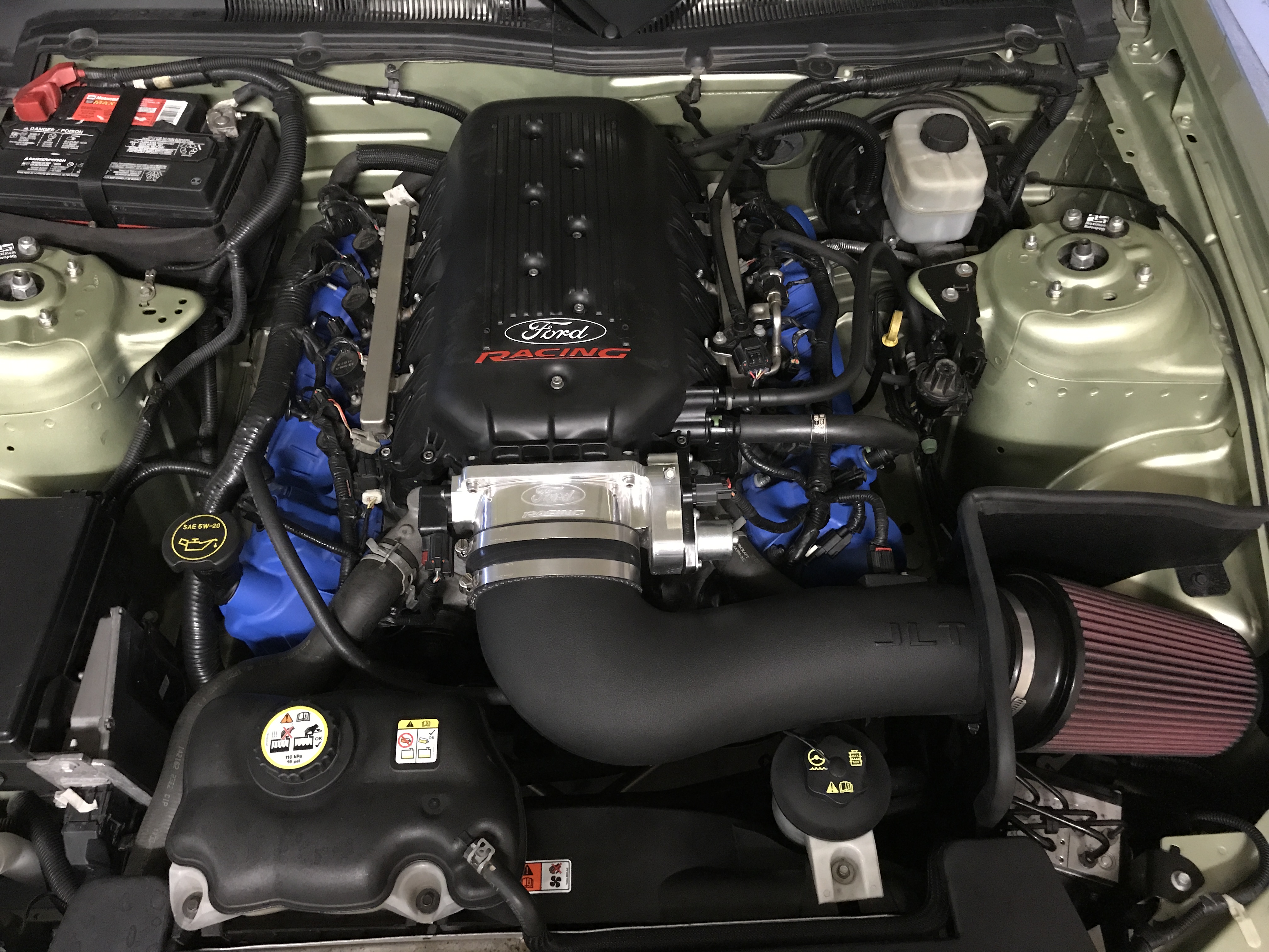

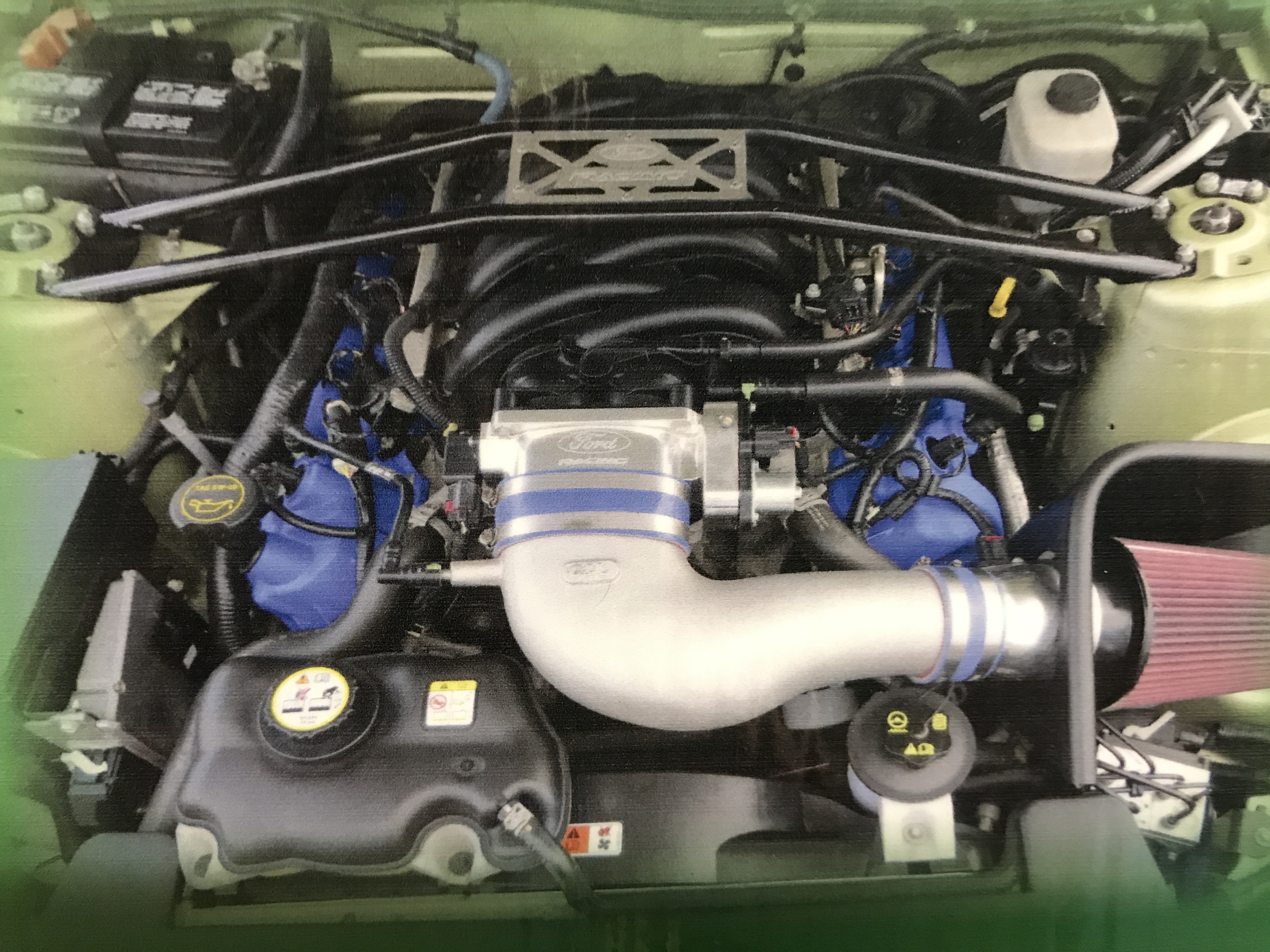

If you are looking at adding a supercharger or an aftermarket intake manifold that requires the removal of your strut tower brace, such as was the case for me with the Ford Racing intake, I thought I would show you a few things I did to compensate and provide some chassis stiffness minus the strut brace.
Before, with brace.
After, minus brace.
BTW, the brace from the Boss will clear this FR intake easily on 05-09 V8’s but it will not fit under the OE hood or similar profile hood.
It requires a cowl or quite tall hood to clear it.

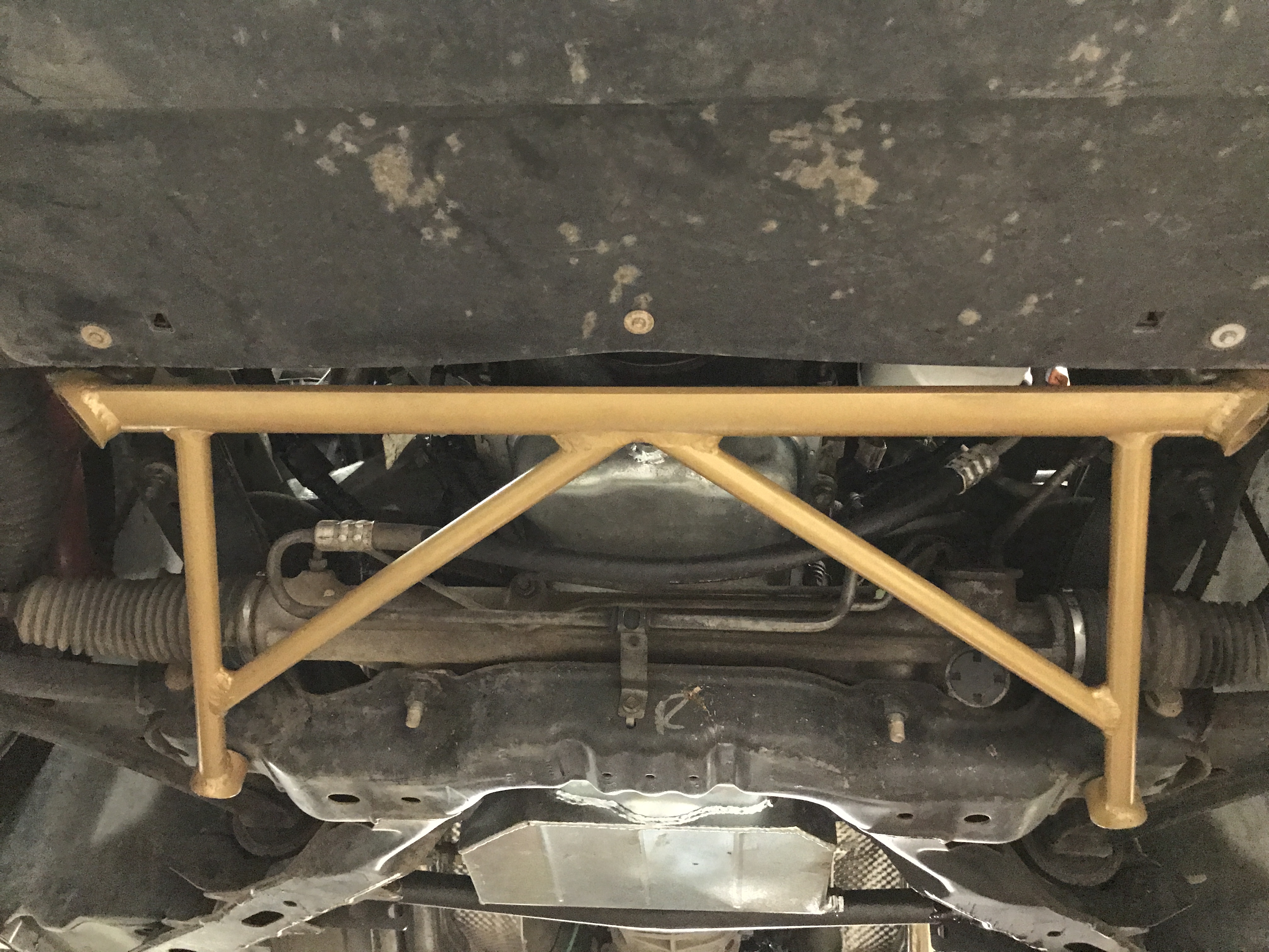

In pic 1 bellow, this is the front end.
Easily visible in gold is a k-member to rad support brace by Whiteline. They also call it an A arm support.
It’s made of aluminium but well triangulated and strong, as well as light.
Along with that, if you look further back, behind the oil pan, you can see a k-member brace running horizontally.
It’s a BMR piece and ties the two rear legs of the k-member together.

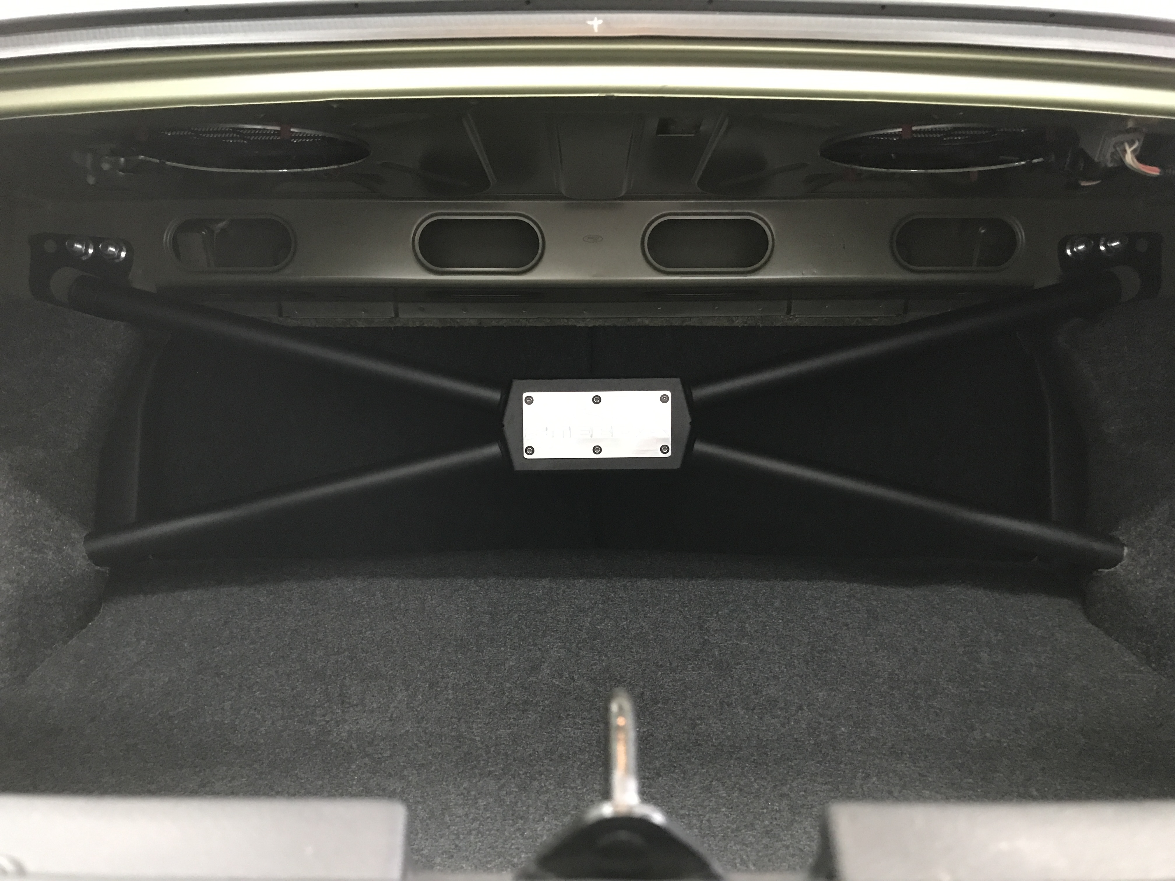

In pic 2 is the Steeda X brace that I have in the trunk to give stiffness to that part of the chassis.
It’s made of chromoly and ties onto the shock mount points down low and bolts to the bulkhead behind the backseat up high with two stout bolts on each side.
This piece provides very similar chassis strengthening as the brace in the Boss Laguna Seca but allows you to keep the rear seat.
The Boss X brace is no longer available but this piece is.
For ultimate corner carving, these can’t replace the strut tower brace but they compensate pretty well.
Before, with brace.
After, minus brace.
