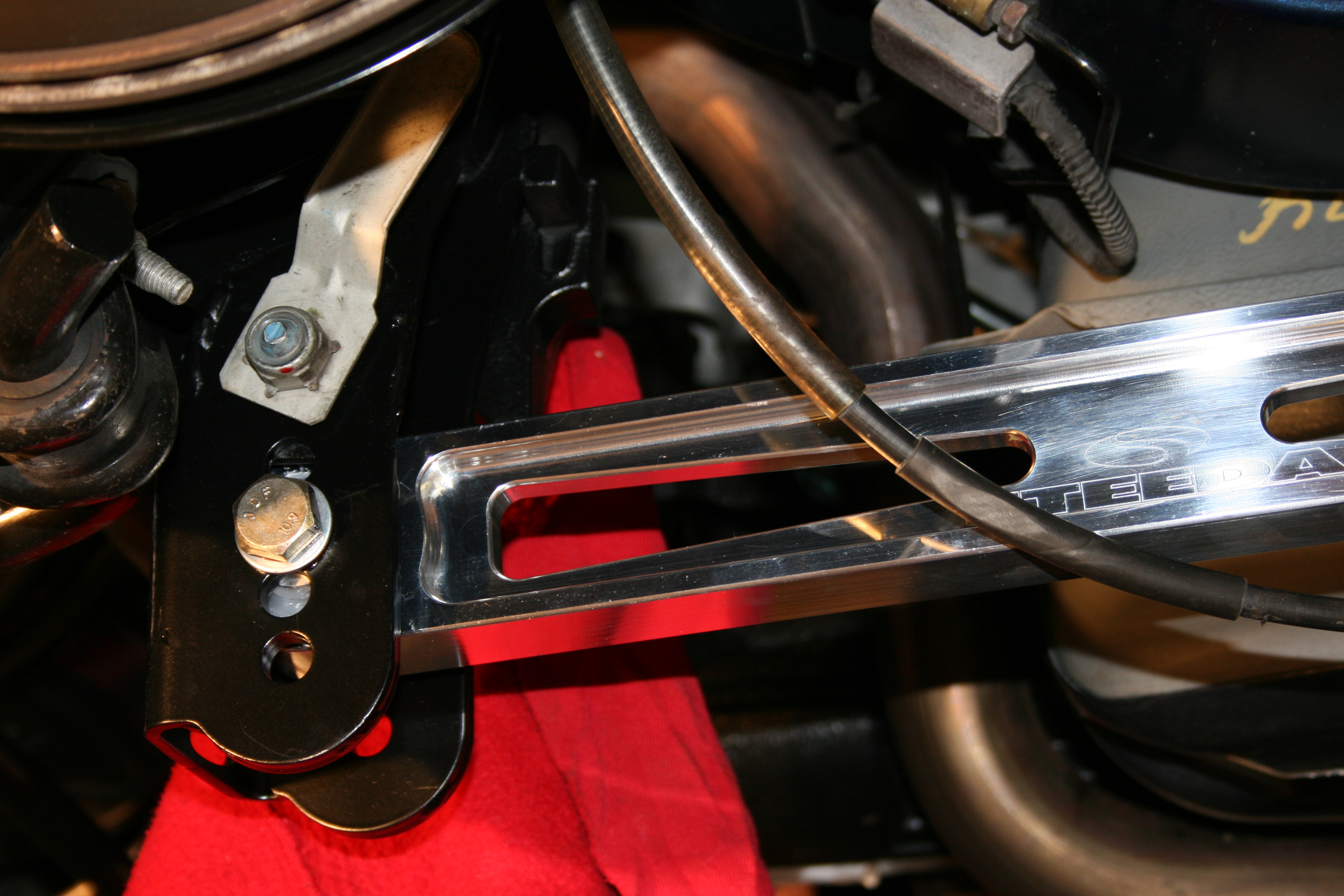

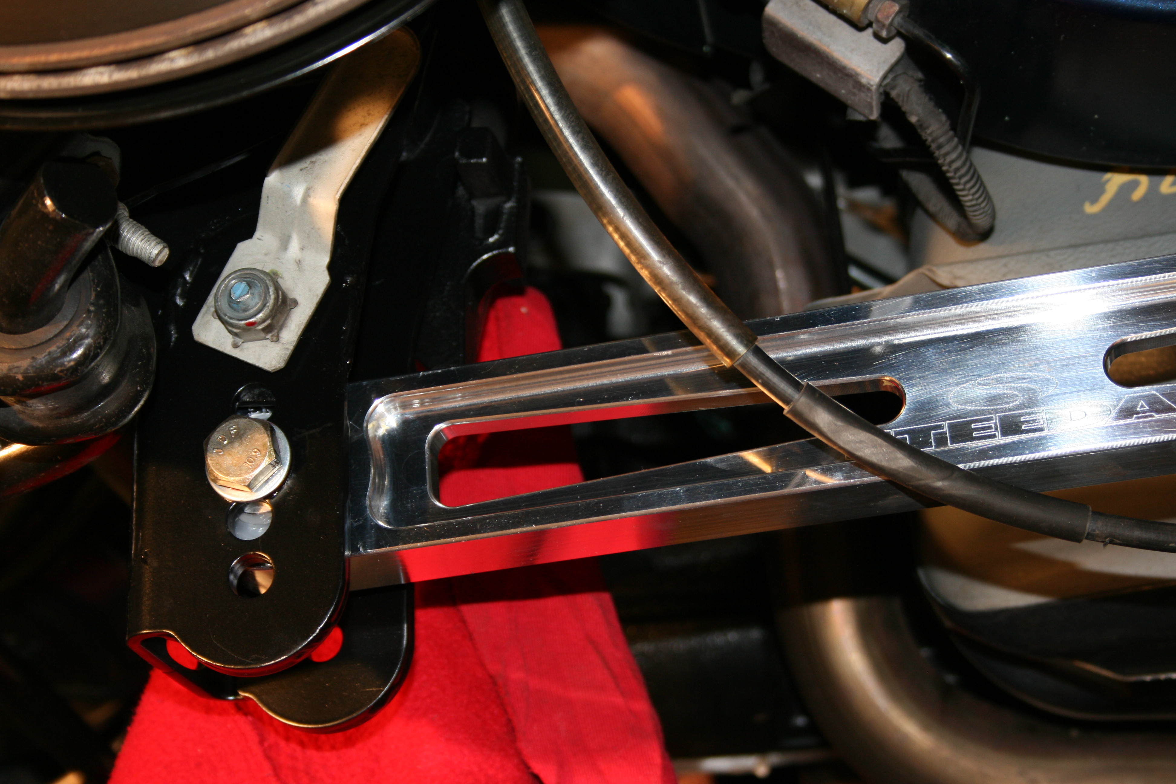

My suspension mod are are almost identical. I went with mostly Steeda stuff. The one difference I did go with a longer than stock upper control arm. You can see pics of the mods on my build page here.

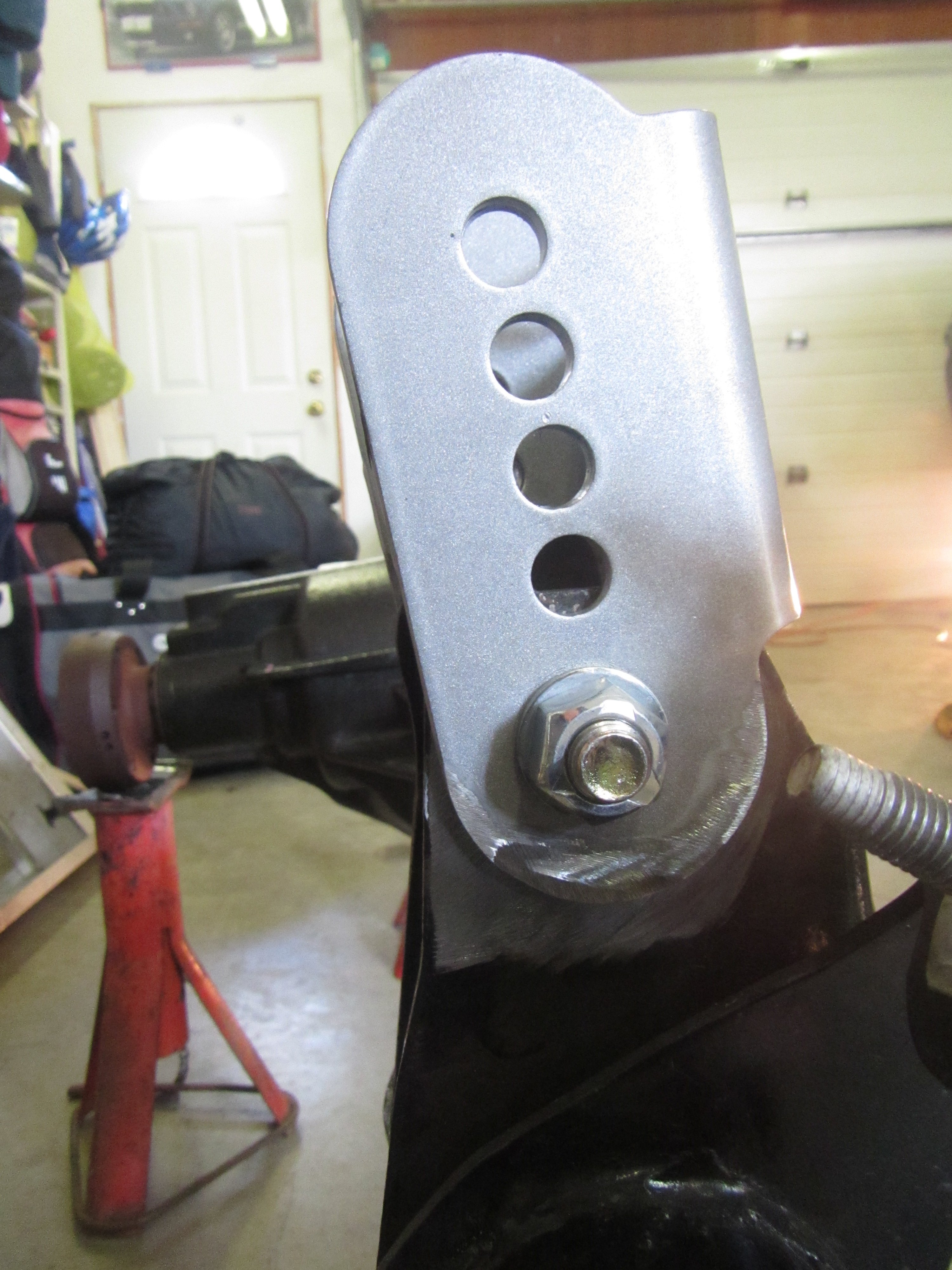

When you added LCA relocation brackets, did you onlynbolt on or weld in? I'm thinking with a car not track nor strip bound....and Mexico being so far away....I may not experience overstressed on the factory installation instructions.
The ones that I used were weld on only, heres a couple of pics
In the early days I saw some pics of mangled brackets, so I went the welded route. I believe that's been sorted. Buy them from a reputable supplier like BMR, or MM and you will be fine.
Welding very strong, of course.
But between those two brands, BMR still best.
They have an extra bolt anchor that none of the others have.
I don’t know if their design is patented but just better than others.
I’m not saying BMR best at everything, but for relo brackets on S197, they pretty much are.
And, for discussion sake, if one had 1000 plus hp FI race car with wide slicks, they can be combination bolted and welded.
