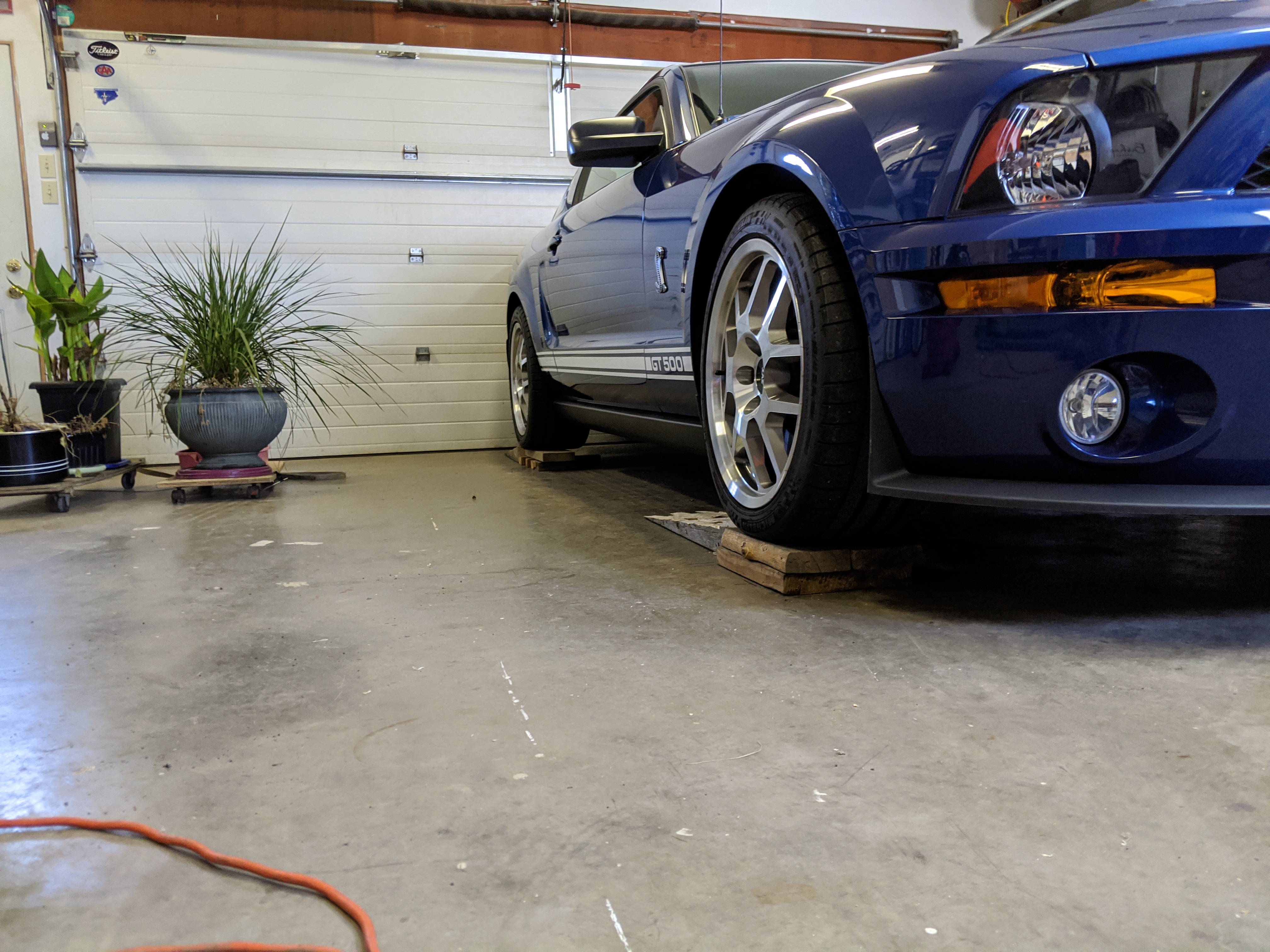

Coming out of hibernation tonight. Cant wait to wake the neighbors! Suspension swap booked for May 6th and would have been ready for action on the planned spring run. Will try to get some pics of the setup.
Questions to come regarding MM caster camber plates. Looking at -1.7 front & -1.8 rear as a start. It's been a long winter and I think I'm due for some different physical distancing!?
I would suggest 1.5 negative camber is a decent starting point for front camber.
1.7 a bit aggressive for a car that does not get tracked.
And you could track 1.5 no issues too.
1.7 is pretty aggressive for front.
Also, so your tires wear decently you may want to consider a slight tow in of about 0.3 to 0.5 each side.
If you go dead center 0.0 or slight tow out you’re going to wear the insides of the front tires very prematurely.
Since your car is a solid rear axle car, there is no adjustments to the rear.
There are no cc plates or parts for the rear.
Only adjustments would be if you bought adjustable control arms and Panhard bar.
Those only control pinion angle and center axle from side to side.
No affect on rear camber.
