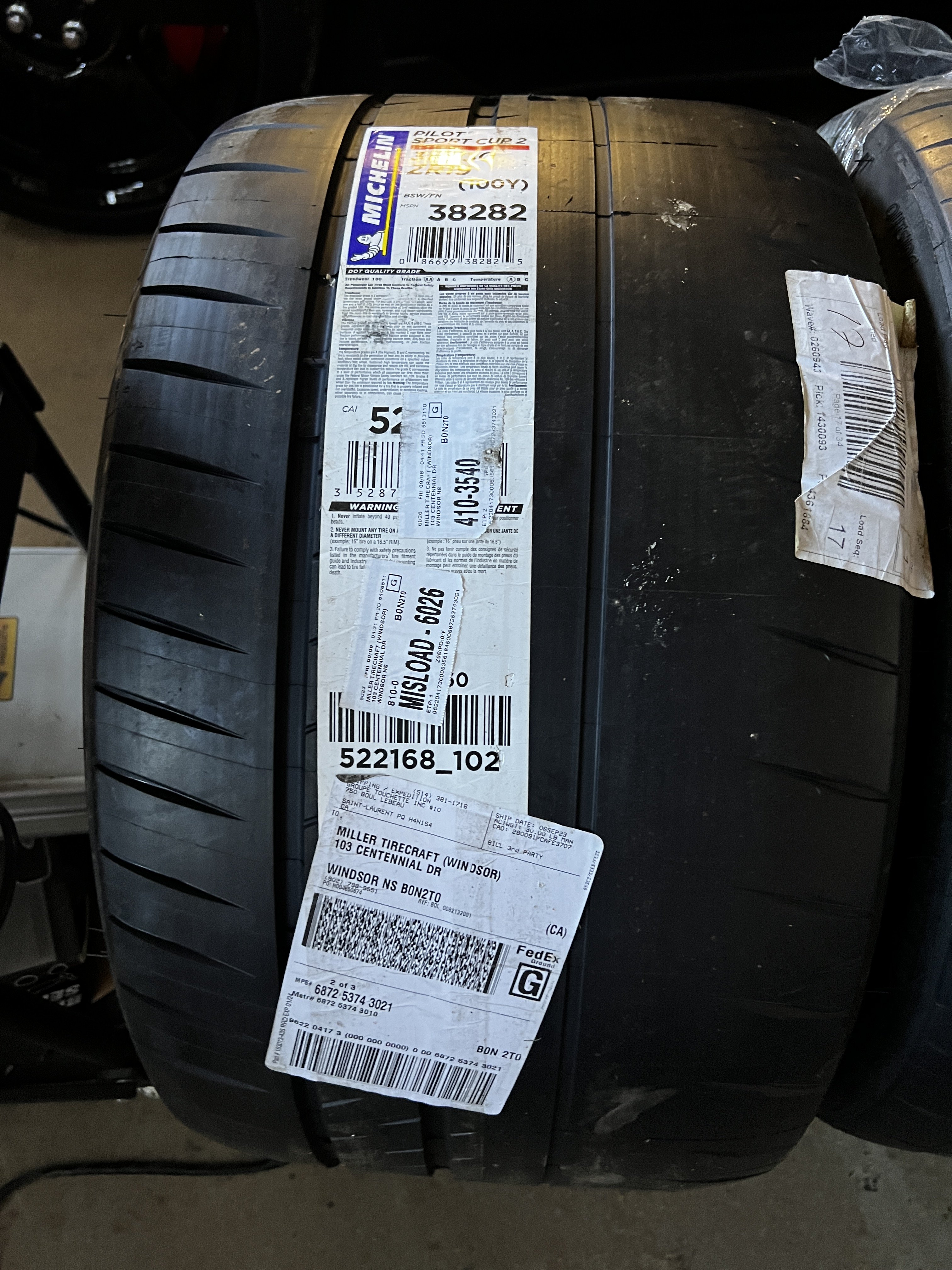

If your order ( normal ) sport cup 2's they have about twice the trewad you see on mine,
I melted a set of Fronts at AMP 2nd year, and went to ford to order,
they got it wrong thats when I leanred how big a difference the non spec tire was for my car.
I had to use the fronts or not drive it,
I don't remember the difference in numbers but tread difference was very noticeable .
Another tire I would consider is the Continental extreme contact,
not sure if they have in our sizes, but great reviews

to be honest not 100% sure,
other than when ford ordered them they were wrong,
said sport cup 2 on sidewall had most markings the same if I remember right,
I did the reserch and thats when I understood they were spec'd to this car,
I think yours maybe same as mine.
Also Michelin may not even do that anymore,
I can do some snooping after Christmas if you want, I have a friend who works at
Michelin who can check it out.

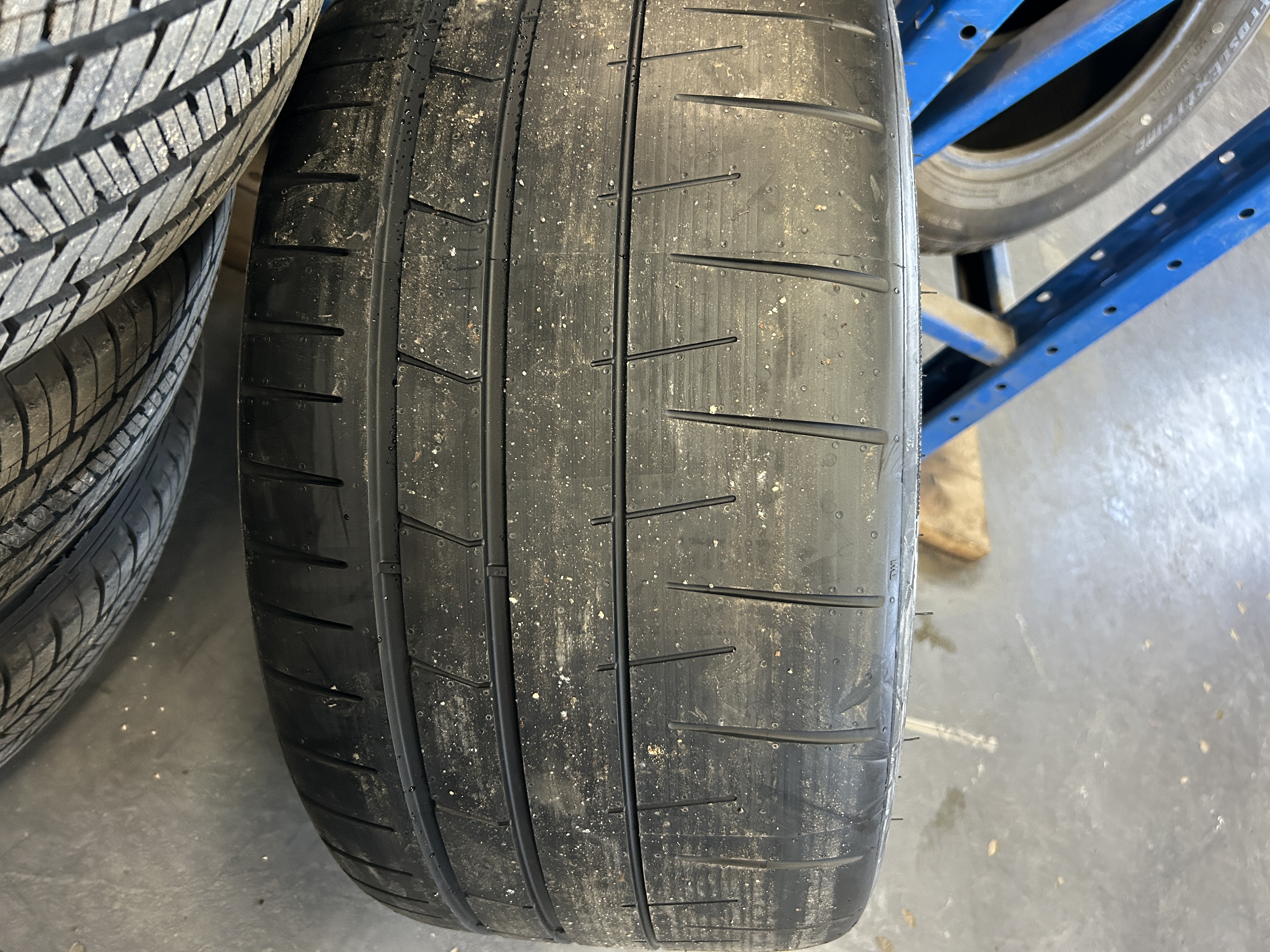

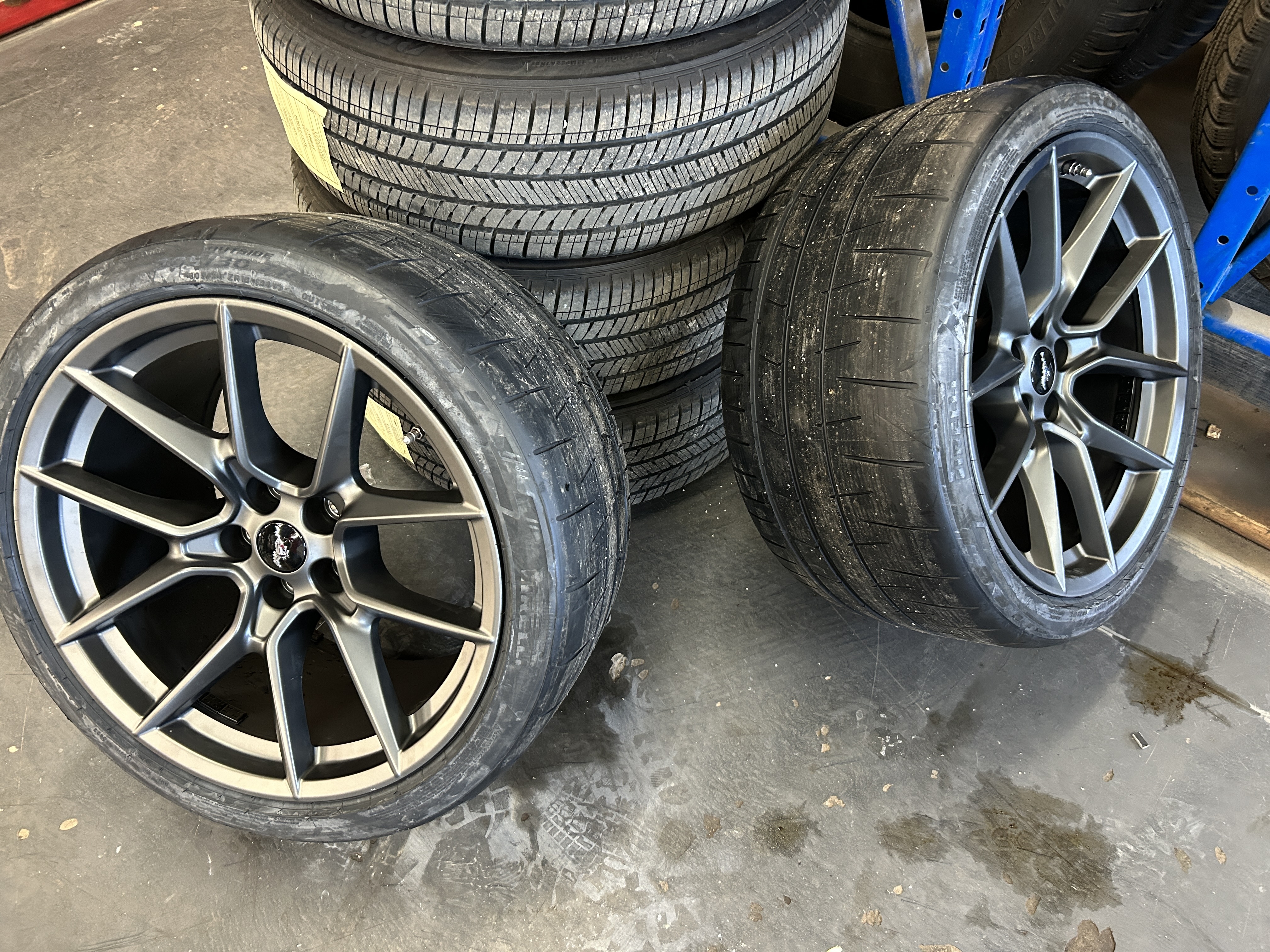

Thanks see what you can find out would be appreciated, my rear sneakers are still not bad but the front ones are gone, i think from the Mods I did and possibly never aligned perfectly, once I removed the lowering springs and Ford could actually get in on the alignment machine late last summer it runs good now, but too late for the front. But I will replace all four at the same time this spring. I may get my money out of the back ones and put some colour in front of the house on the pavement. Lol

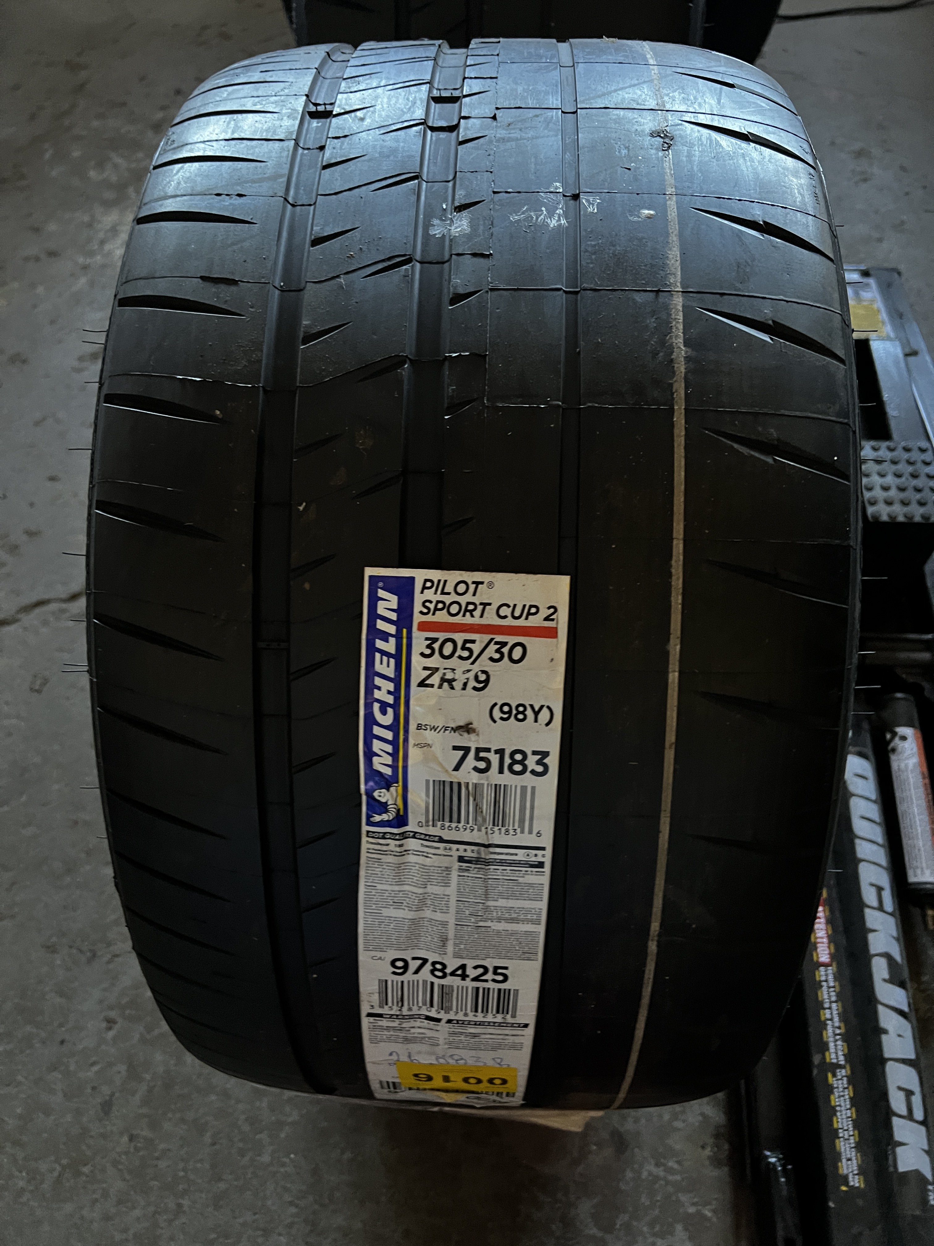

I did not fact check and don’t pretend to be an authority but from close observation on Mach 1 HP that spent winter in our showroom 2 years ago, the Cup 2’s that came on that Mach were identical to the shoes on Trevor’s car.
I theorize that when 350’s came out in 2015, the Cup 2 was still a fairly new tire and remember reading that Ford worked with Michelin to develop tires for the Shelbys.
Several years on, not impossible that the Ford formula of the Cup 2 has been adopted as the standard.
Would easily explain why the Mach HP Cup 2’s are seemingly identical to he ones on the 350R’s.
For the regular 350’s, the OE tire was the Pilot Super Sport and sizes are slightly different.
Slightly narrower and slightly taller sidewall.
295-35-19 front and 305-35-19 rear.
As opposed to 305-30-19 and 315-30-19.
