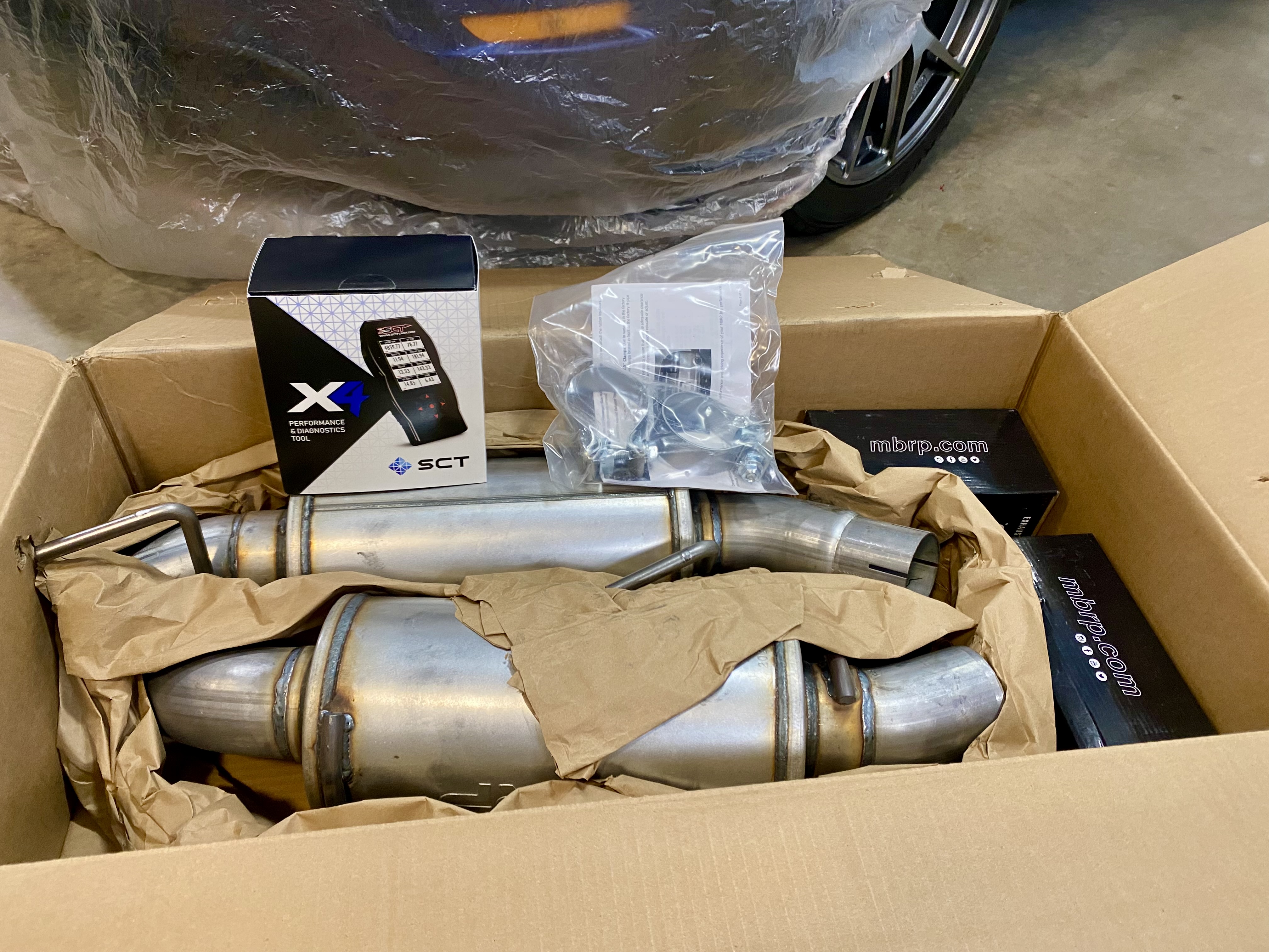

Picked up JLT Series 3 CAI, along with a set of GT500 springs. SCT X4 tuner should arrive tomorrow, or next day via FedEx, and MRBP cat back exhaust shipping via FedEx from CJ Pony Parts today. Lots to work away at. Spring cannot come soon enough.
