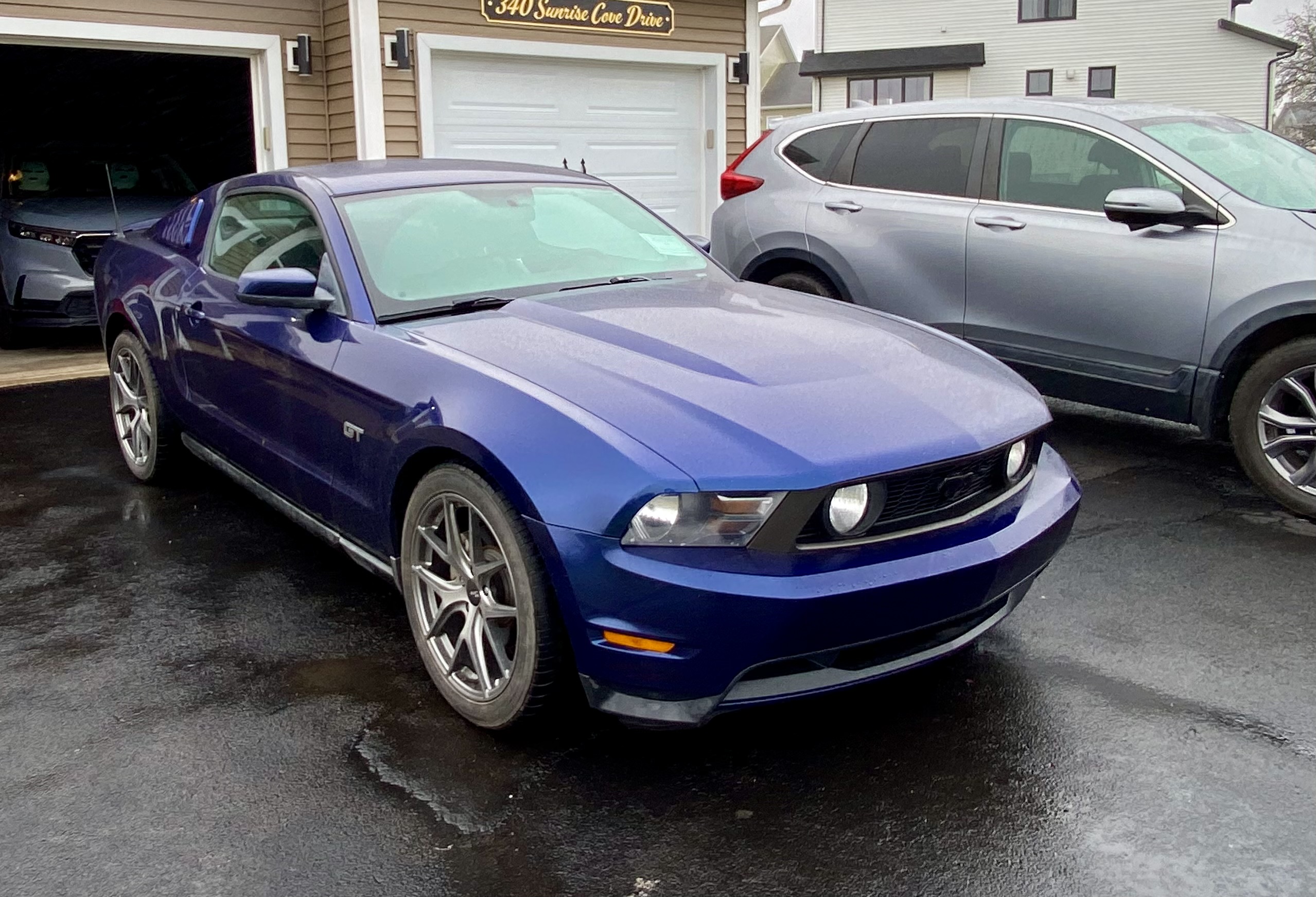

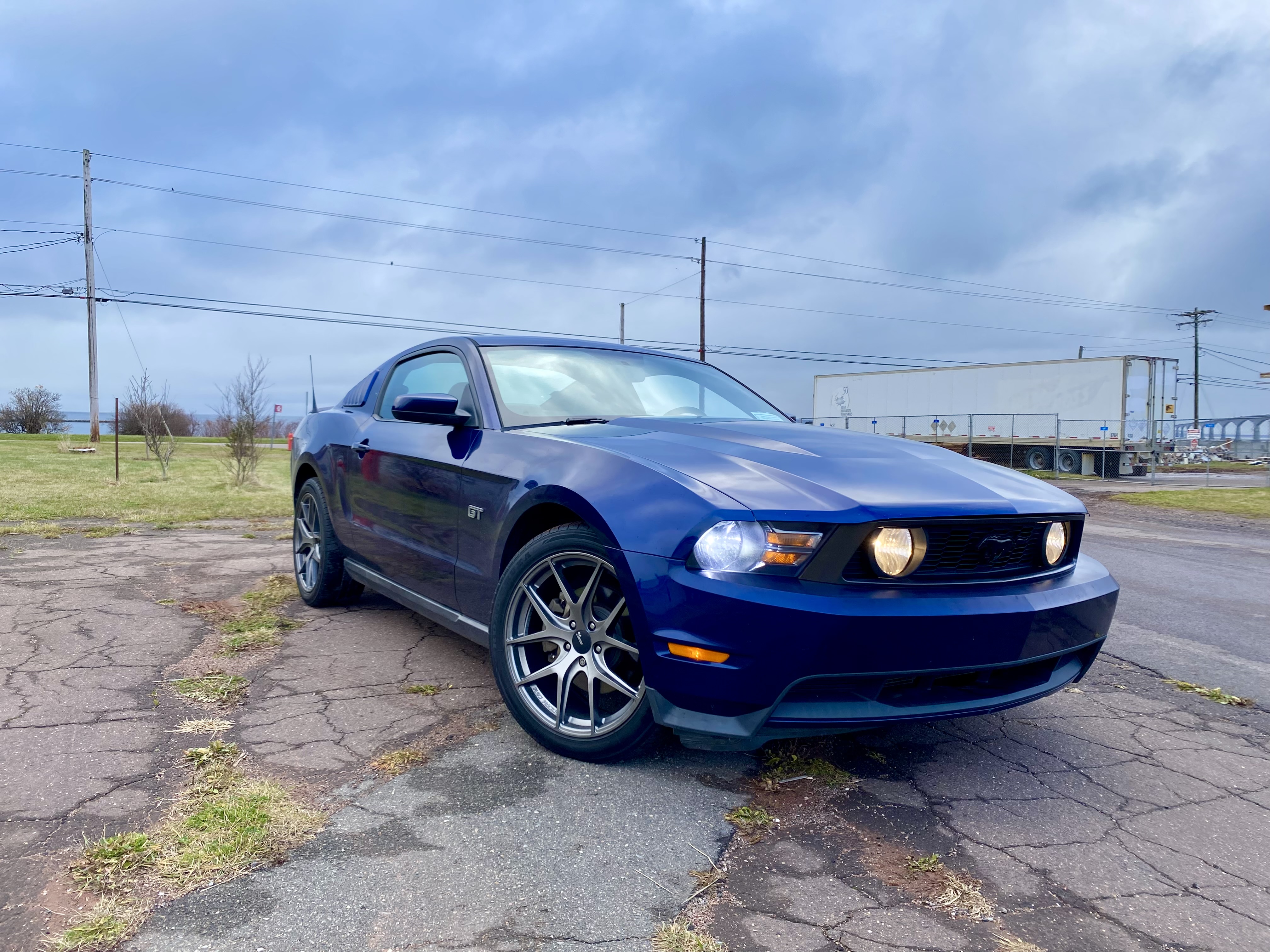

Picked up a 2010 Hardtop GT

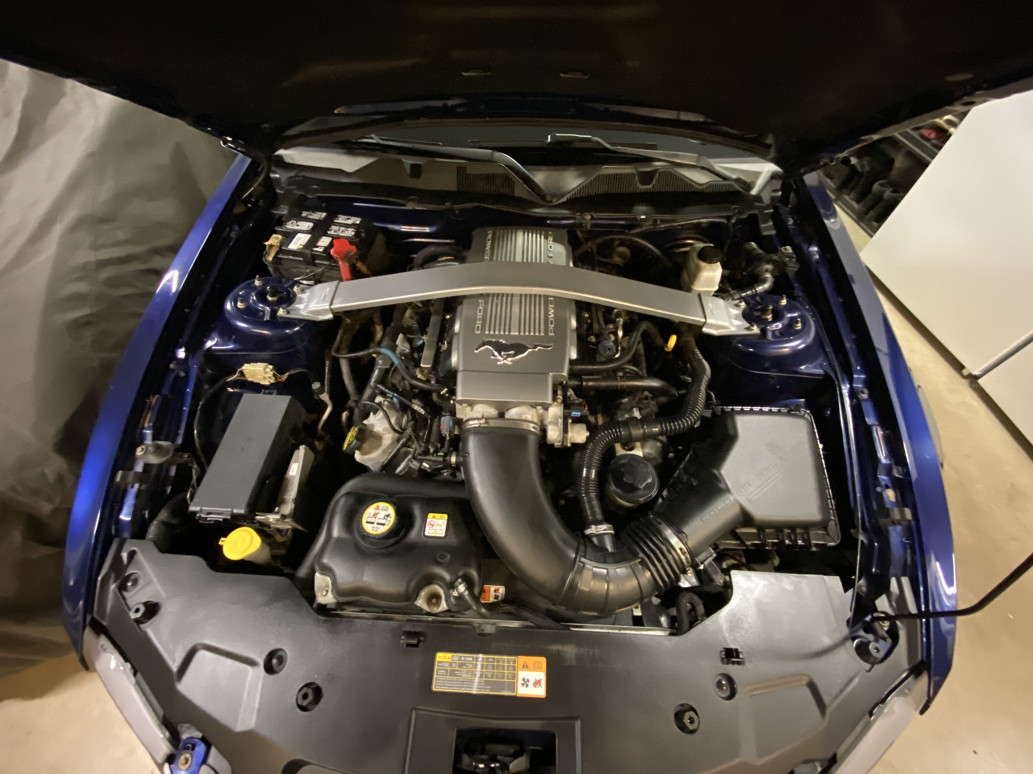

As said, these cars don’t have a resonator like the new cars, so the piping between Cats and mufflers is good quality stainless steel where pipe for pipe, there is minimal to no gains possible with cat back exhaust.
By deduction the most important place for improvement is the mufflers.
Wether getting cat back or axle back(meaning mufflers only), the main characteristic to look for in order to put in place building blocks for future power improvements such as long tubes, cams or FI, is to source mufflers that flow better than the OE mufflers.
Otherwise you are just changing sound but not much else.
The biggest restriction in the exhaust system from the factory is all before the mufflers.
It’s in the factory manifolds and the cats, which are incorporated in the factory H mid pipe.
Should you decide to go with long tubes later, the long tubes will come with their own mid pipe where you can research and source, depending on manufacturer, an X or H pipe with high flow cats.
Not all manufacturers offer both. Most offer one or the other.

Great information, and I appreciate that you are speaking from experience. I am not sure that there is anyone in PEI that has the level of experience and expertise in modding these cars that can be found in NB or NS. At some point I will be looking for a shop recommendation. Also, should I be looking to buy a tuner at some point once I start some mods? I see tuners advertised for a range of years of Mustangs, up to the 2023. I don’t think Ford had unlocked the tuning on the 2024 yet. When I get a tuner, I would like it to have the capability to tune the 2024 once Ford unlocks them. I hope that makes sense.
Good question.
Both Trevor and I have mentioned it already.
CAI and “Tune”.
Emphasis on tune.
So, big Yes, you will need a tuner.
I’m almost afraid this bit of information may be late for you.
I think I read that you already ordered a CAI.
But what I did not read is what I picked up on.
I did not read that you also have a tuner coming with that CAI.
If the CAI you ordered does mot require a tune you are basically wasting money because it will not give you significant gains.
It may not give you much at all except a different look when you open the hood.
So not much more than eye candy.
Except for the under drive pulleys that I described before, any power mod worth doing absolutely requires a tune.
If it does not require a tune, then it’s not increasing the air flow in and out of the engine significantly, so not much gain.
If no tune is required, it means your mass air meter and computer can cope with the difference. If they can do that then it’s not much of a difference.
Or put another way, a significant difference.
A difference worth doing will throw engine codes if you don’t have the proper tune.
SCT is the most common and widely used tuner for our cars.
If you deal with experienced and reputable sellers, they will sell you the appropriate tuner for the mod you are buying.
For your car, the best CAI is the JLT series 3 and it absolutely requires a tune.
If dealing with the big American sites like American Muscle, CJ Pony Parts or LMR, you should call and speak to someone.
They will ask a few questions to get it right.
Such question as what octane tune do you want?
It’s important here to tell them that you want a 91 octane tune because that’s all we have in the maritimes.
So a 93 tune is useless here and if downloaded into your car will damage your engine’s valve train with detonation, because of not enough octane in gasoline.

Thanks for all of that. I spent a good part of the evening reading about tuners and looking at different ones. I also found the JLT series 3 CAI. As you said, it appears that the 4.6 has potential, and a good tune can help bring it to life. I also read some mod threads and a number of people stated, as you did, that 3.73 gears are the way to go. I watched the video on how to install the under pulleys. Didn’t look too bad, other than the puller, I think I have everything else I would need. I appreciate all of the advice and comments.
It seems that Bama and SCT are the big names in tuners. If you buy a Bama tuner on AM, you apparently get free lifetime tunes. Is this worthwhile? Is there a significant difference in these two brand names? I think 8 am going to go the tuner route, but want to buy the right one.
If you need a crank pulley puller got the 4.6 I have one you can borrow. Also crank bolt is a one time use item, need a new on each time. I have a longer bolt that can be used to pull the damper part way on, the original / new crank bolt is too short to pull the damper in at first.
Bama is the in-house tuner (humans testing parts on cars, writing code and developing tunes) for American Muscle.
They use blank SCT tuners (hardware) and put a Bama sticker on them.
Bama does not make hardware, only software. SCT does both soft and hardware.
If you had them both in your hands, you would see it’s the same tuner.
What makes the difference is the software written in the tuner.
Bama’s is developed by Bama people, and SCT’s is developed by the SCT people.
Lifetime upgrades is a good thing.
It promotes my earlier suggestion to try and stay with the same tuning house once you get going.
They should offer support if you run into issues. And subsequent tunes if you want to further modify. Such as cams and long tubes.

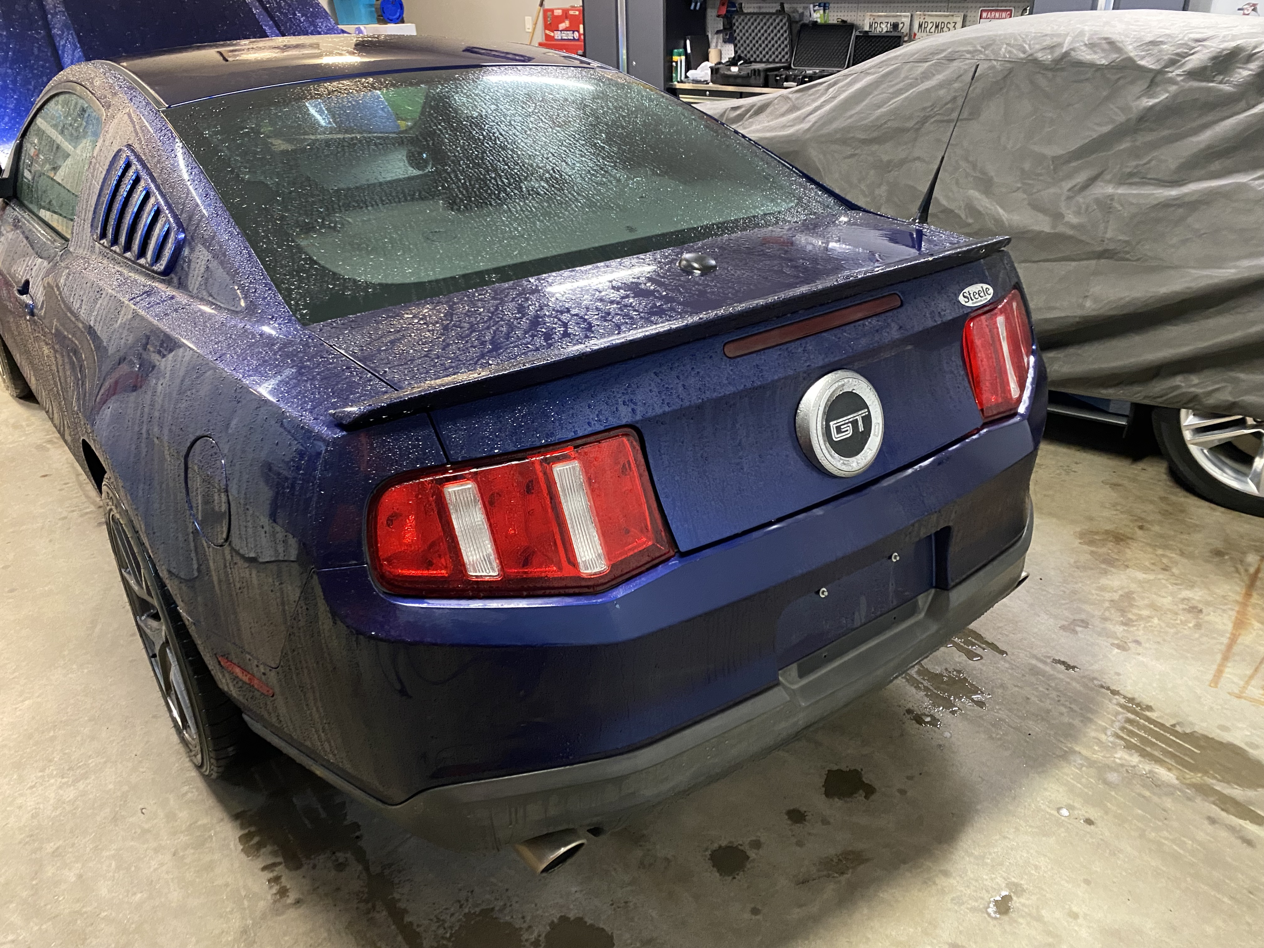

I enjoyed my 2024 convertible, but missed driving a standard after selling my 2003 5 speed last Summer. I also like tinkering with a car over the winter, and the 24 did not need a lot of work. For a couple of months I have been watching Kijiji, Autotrader, Facebook Marketplace, and other sites trying to find a suitable car. It had to be a GT, standard, and preferably blue. Over the weekend, I found the right car at a dealer in Charlottetown. After giving it a good look over, including crawling under it, test driving it, and reviewing the Carfax report, after a lot of negotiation, I drove it away. The car spent most of its life in BC and Alta, and was represented as having never been winter driven. After looking at the undercarriage, under hood, body, and odometer (109,000 kms), I don’t believe it was winter driven.
Tires will need replacement, but interior is in great condition, clutch is good, all accessories work, and it runs well. Paint is original, and has nice shine, but stone chips were never touched up, and it needs a good clay bar, paint correction, and ceramic coat. I almost ordered the same aftermarket wheels for the 2024, before finding another set. New exhaust has been ordered, along with a CAI, front splitter, and a number of items. Dealer sticker has been removed. The mods on this car may never be done.
Interior and under hood needed a good cleaning and have been done. White bulbs for the fog lights coming.
View attachment 80975View attachment 80976View attachment 80977View attachment 80978View attachment 80979View attachment 80980
