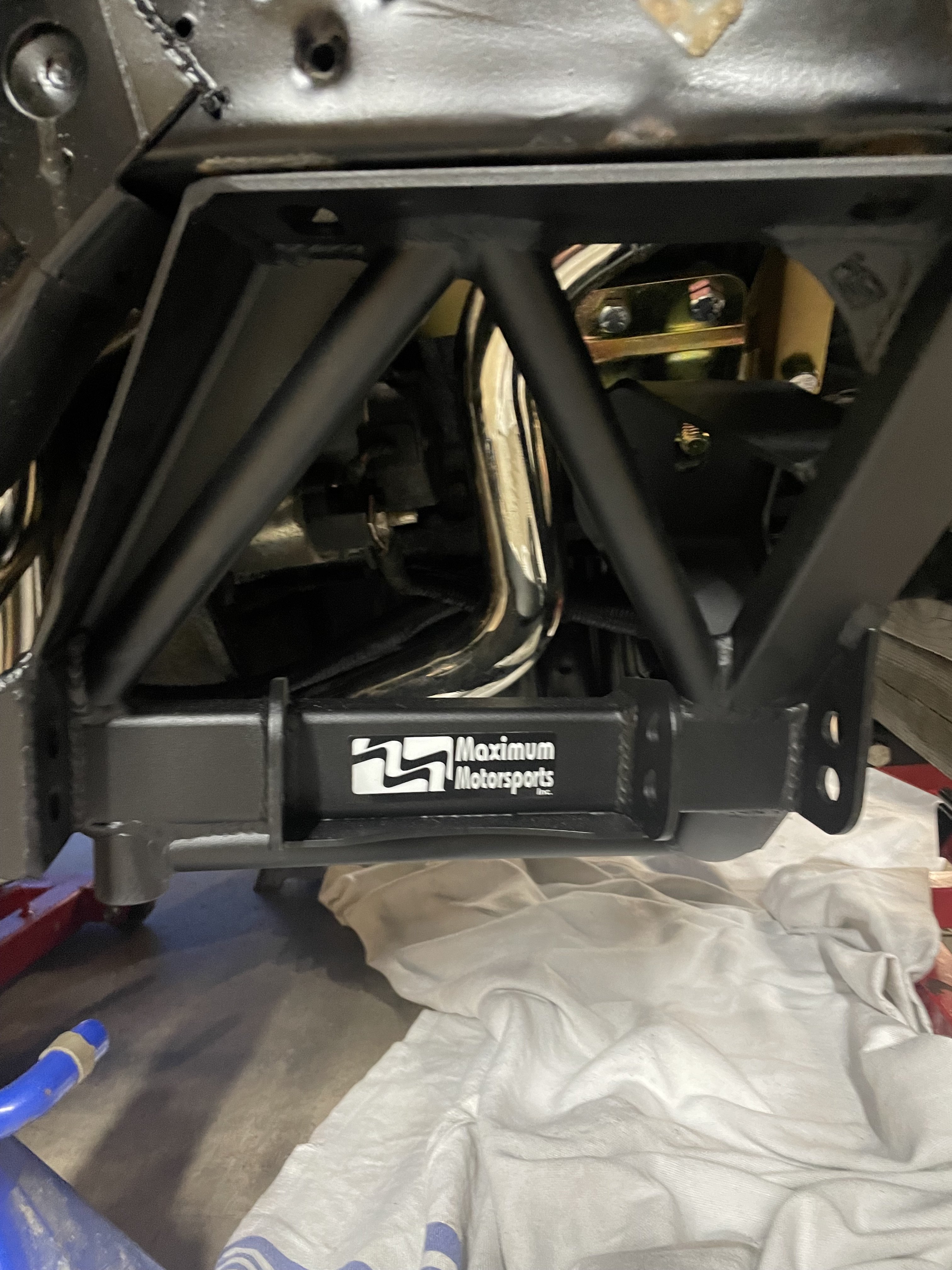

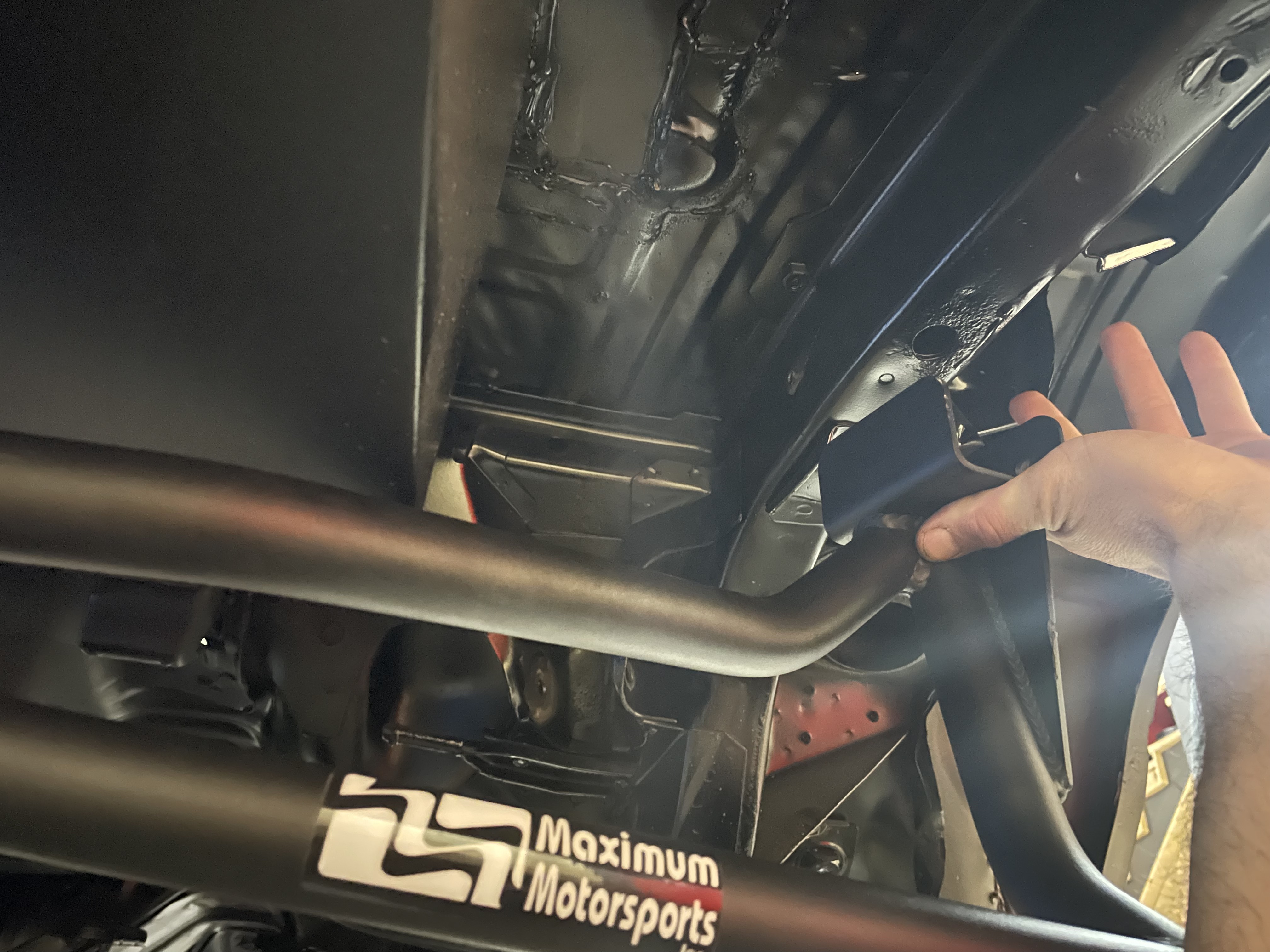

Next step is being arranged, welding in back suspension pieces,
three spots that need to be welded. Also the spot where fuel cell
is going, has to be adjusted as one of the suspension bits needs to be mounted too close.
So small adjustment in desigin needed.

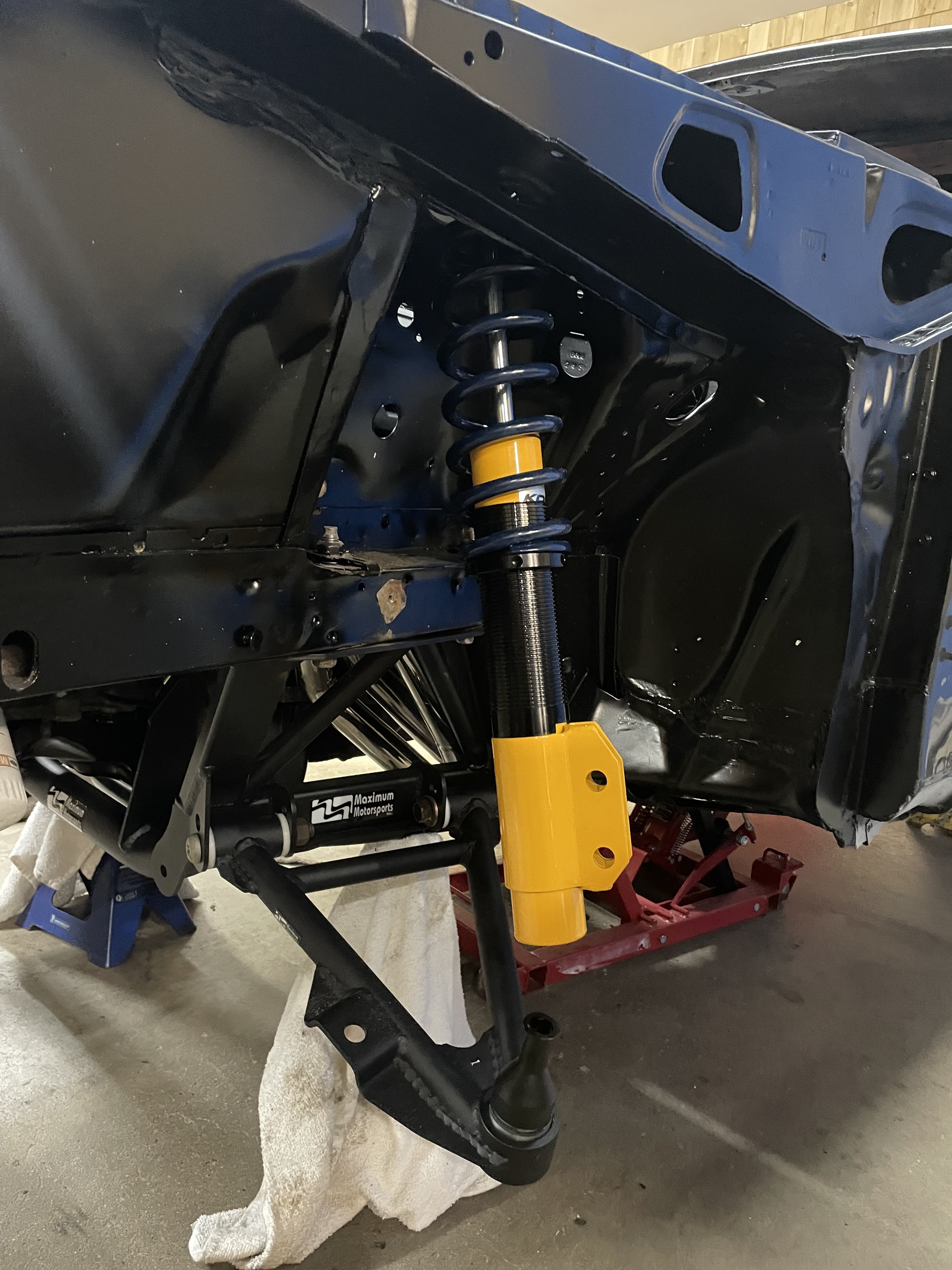

In the case of my build not just coyote swap, it is complete suspension
rear end, new 4 wheel disk brakes, 4 lug to 5 lug, complete rear end build
all new brake lines and fuel lines, relocating battery to trunk
half of interior is new, all needs to be put back in car along with glass.
