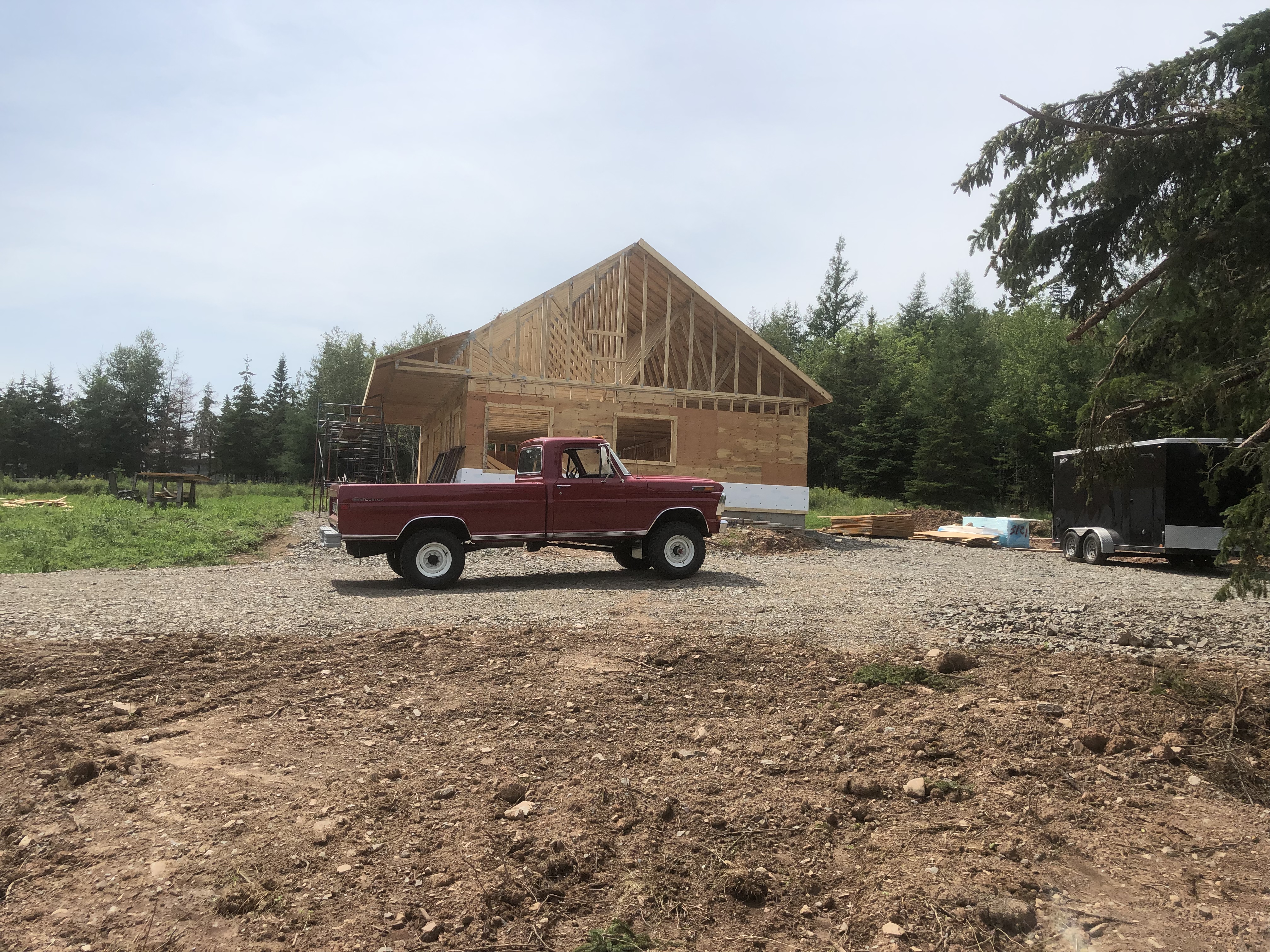

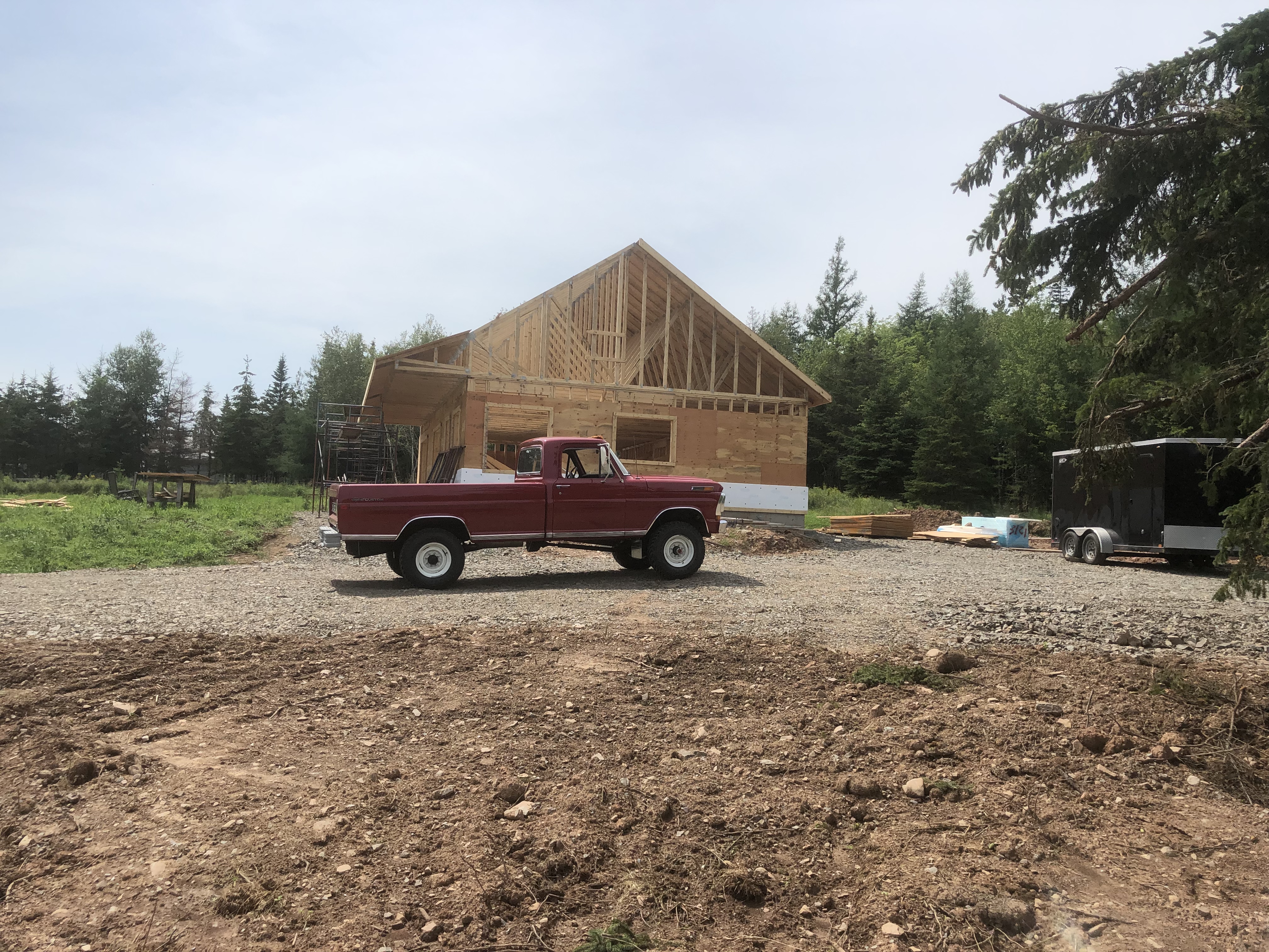

On site of the new house build (Katherine and Roger’s)
