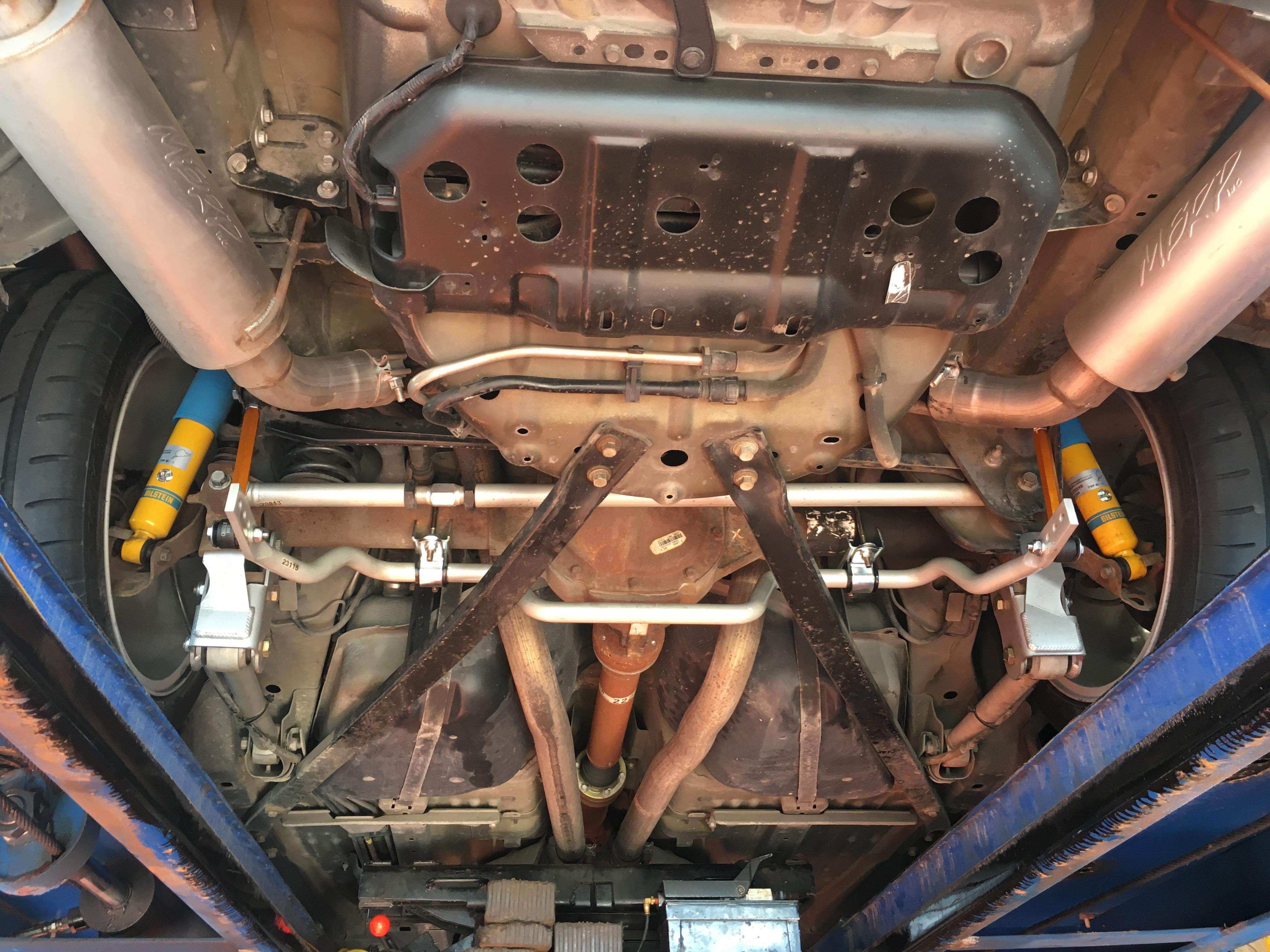

I have a garage, but I remember my 08 looking a little tough underneath.
I spend one winter cleaning a painting the bottom of car.

Here’s a picture of the underneath of mine taken by my mechanic last summer. Actually just sent it to me this weekend, coincidence ? don’t mind the road grimme ?
