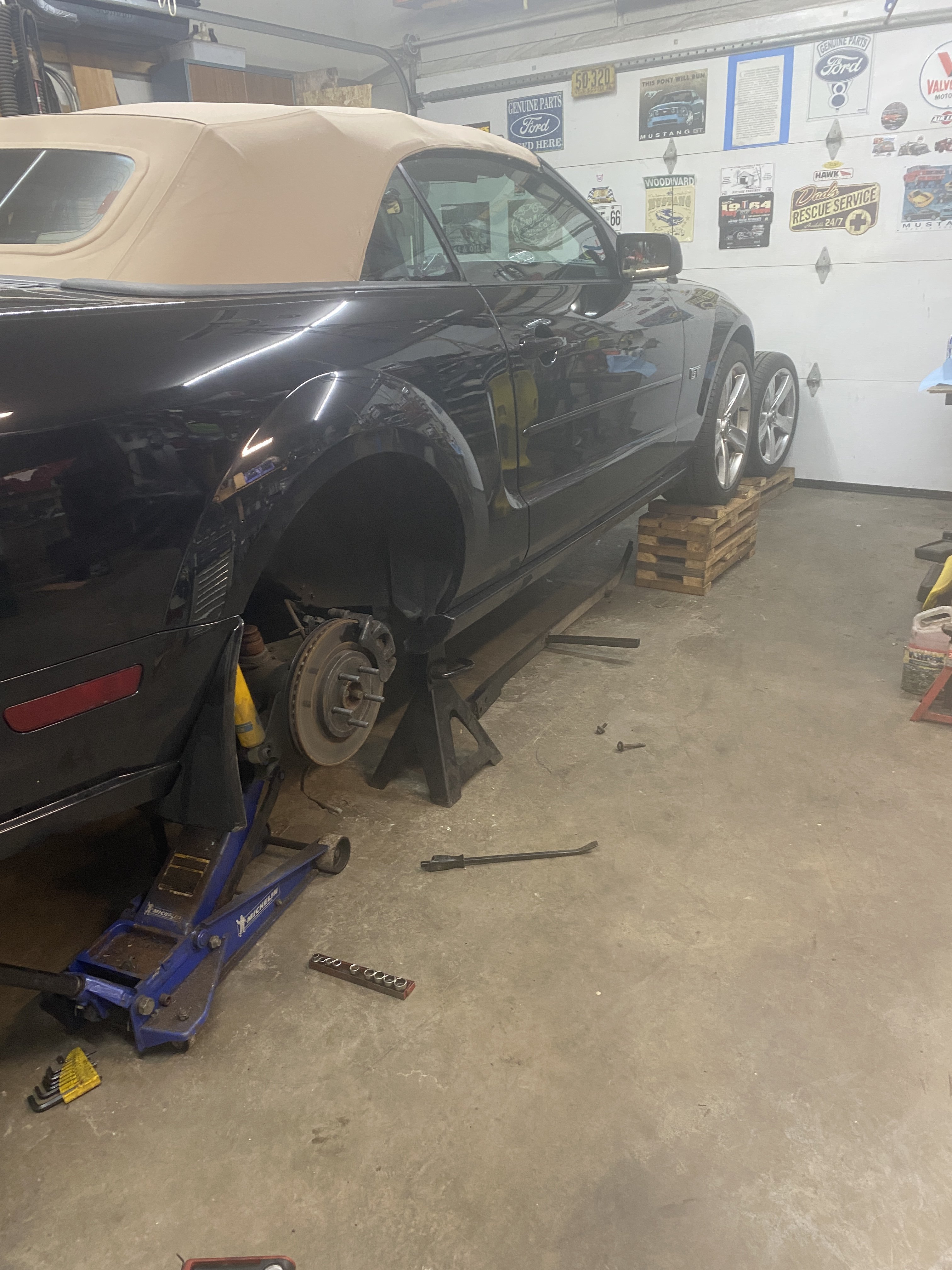

Time to goo um on blocks again

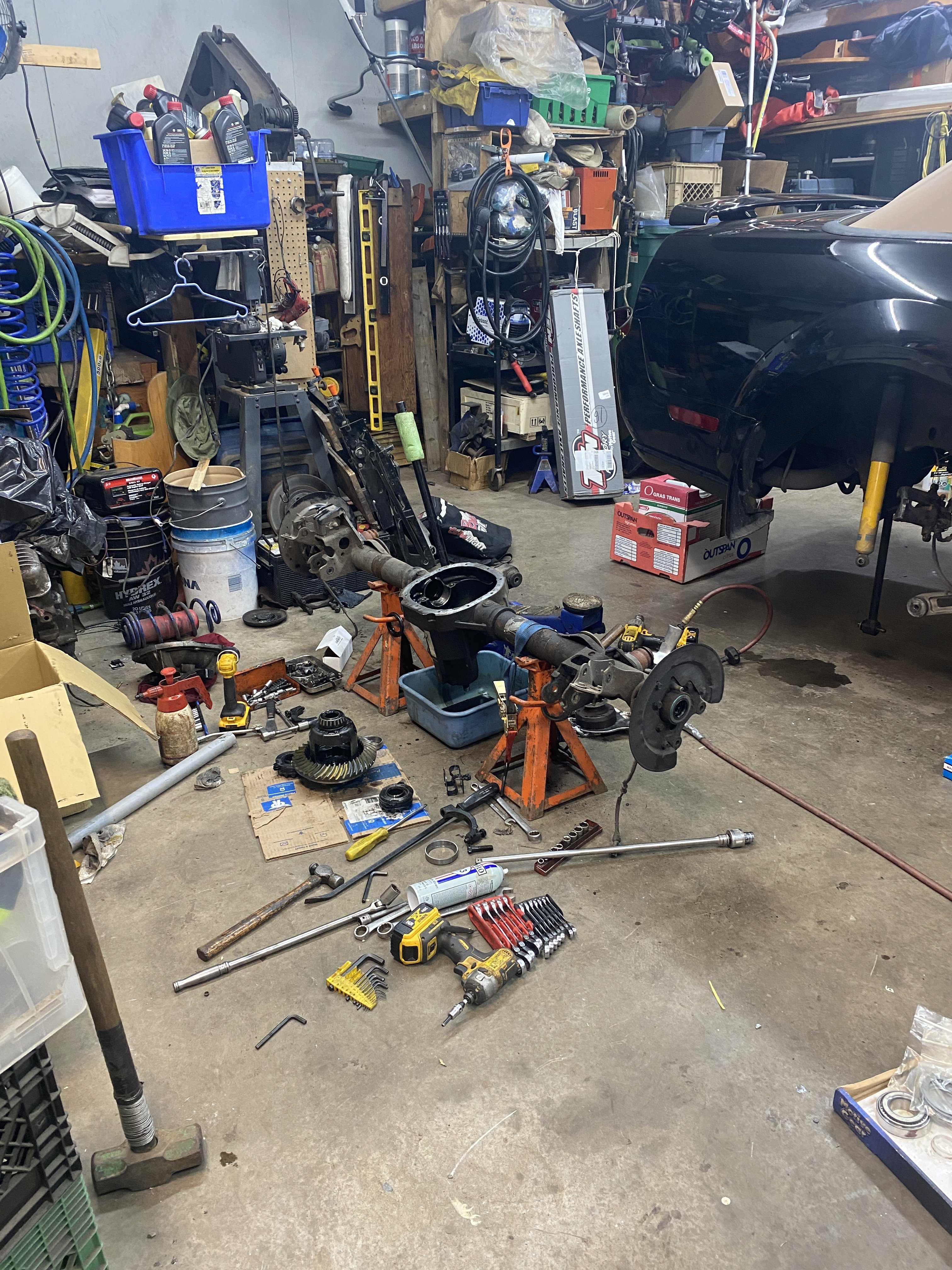

Diff out and apart

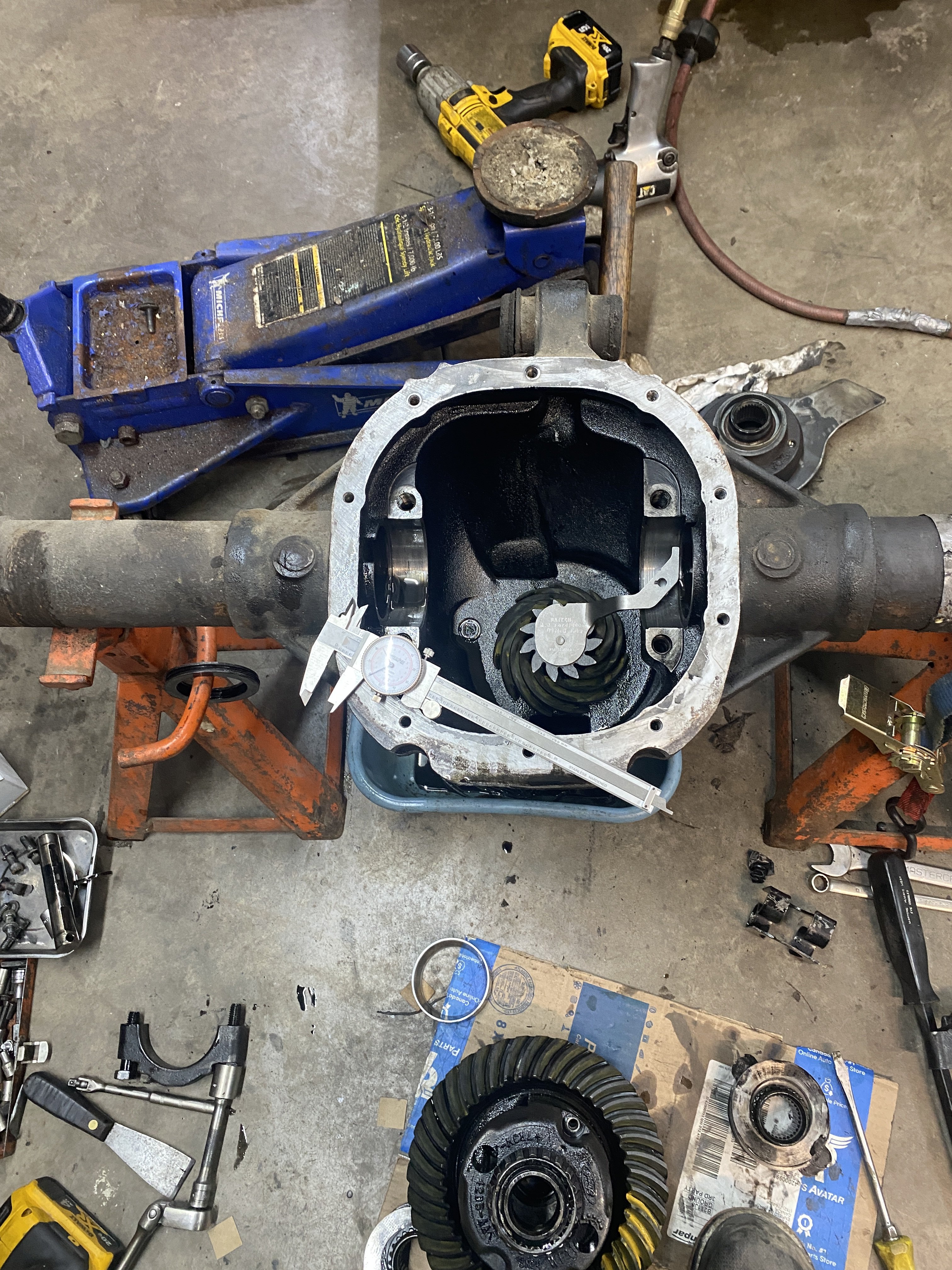

Time to make some measurements - Axle end play was good @ .020" each end, Backlash was larger than i had expected -Measured out to .014". The pinion bearing preload was also quite low. The pattern was higher ( toward heel) on the teeth than i wanted but these numbers help explain the small whine above 60mph.
Clutches look good -They will go back in - RH axle showing more wear on the bearing surface so 2 new axles- new axle bearings - Axle seals - Pinion - pinion seal - carrier bearings and yes Marc -- 3.73's are here for install this time !

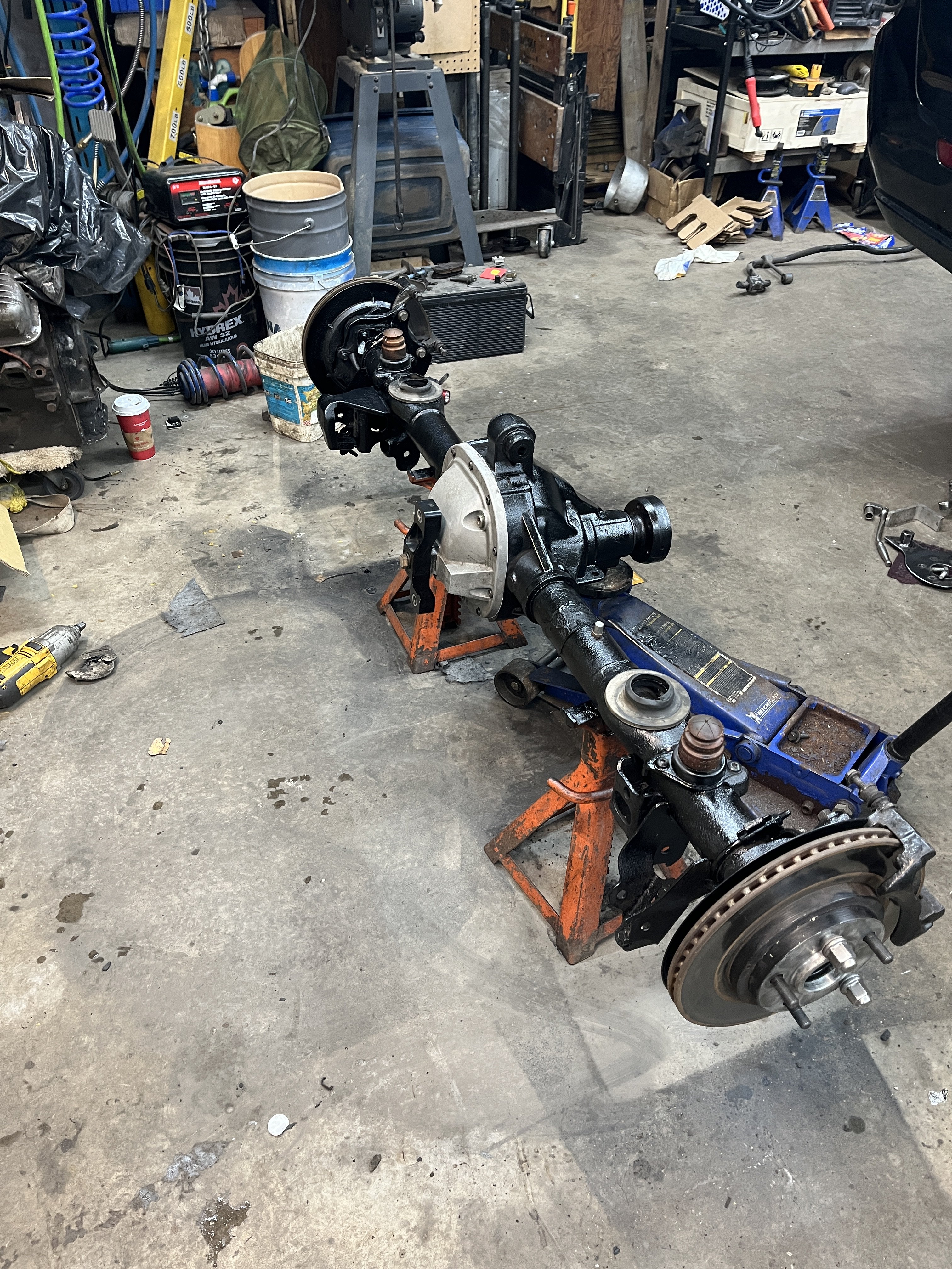

It’s been a busy couple of weeks - not much time for car stuff when sitting in a hotel room in another province. Finally got everything in the axle and it’s back in one piece, now to get it back under the car and hope for a quiet set up when it’s driving time.
Yes. The paint can made an appearance - I cleaned up the shocks and lower control arms while I was there as well . Got axle back under the car and bolted in. Still have driveshaft -rear sway bar and brakes to finish before it gets back on the ground
