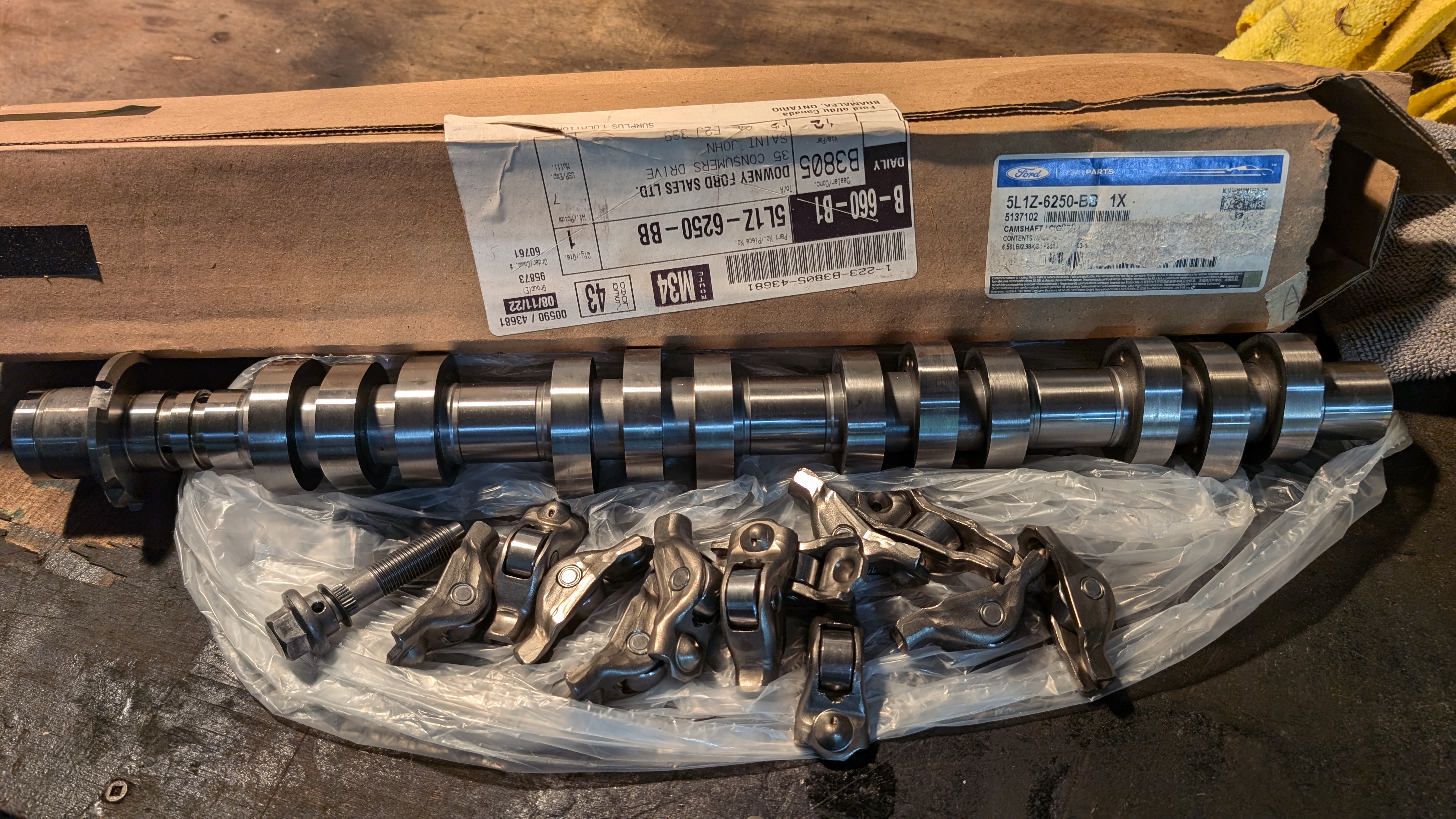

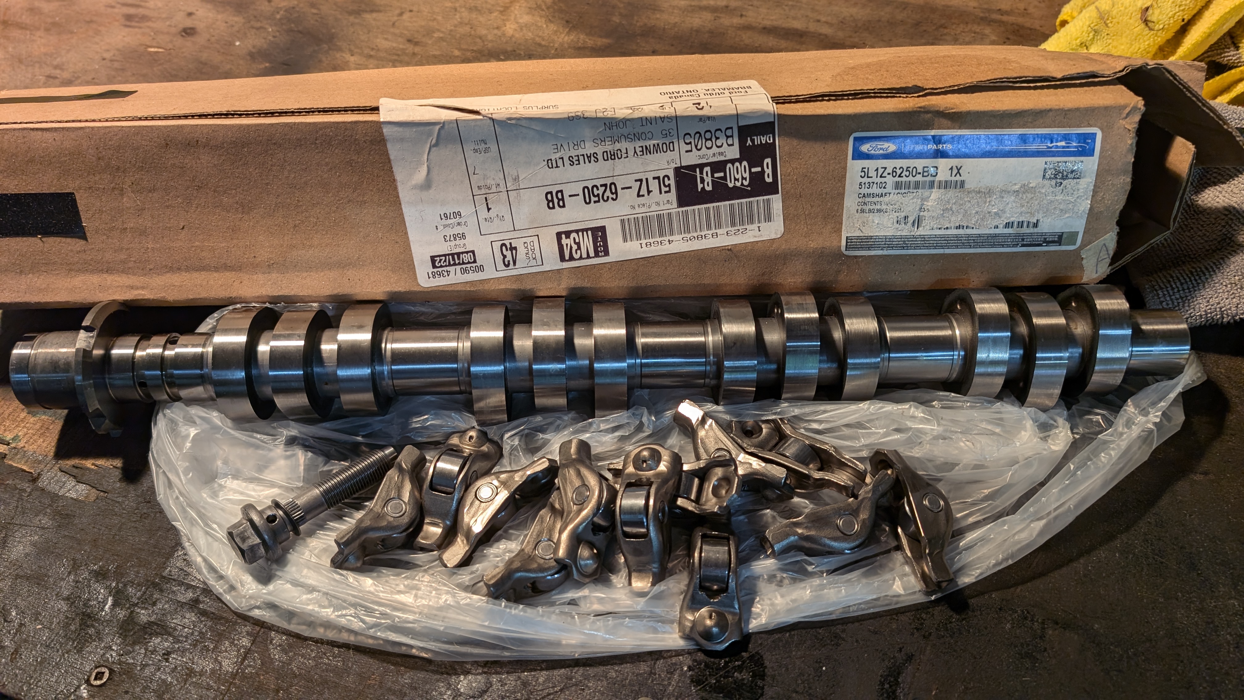

This a a long shot but here goes - Anyone who upgraded camshafts on their 05-06 at low miles still have the originals packed away and would be willing to sell?
Looks like I'm going to be needing a cam soon. Rear lobe on #4 is showing wear, Its on its way out. I'm not looking at high performance mods for the cruiser as I'd like to keep what bottom torque I have and don't want to go through local tuners if possible. Low km Ford cams would last me a long time.
I've got the covers off to replace the VVA solenoids - I'll be putting it back together for now but know I have to start collecting parts.
All new
