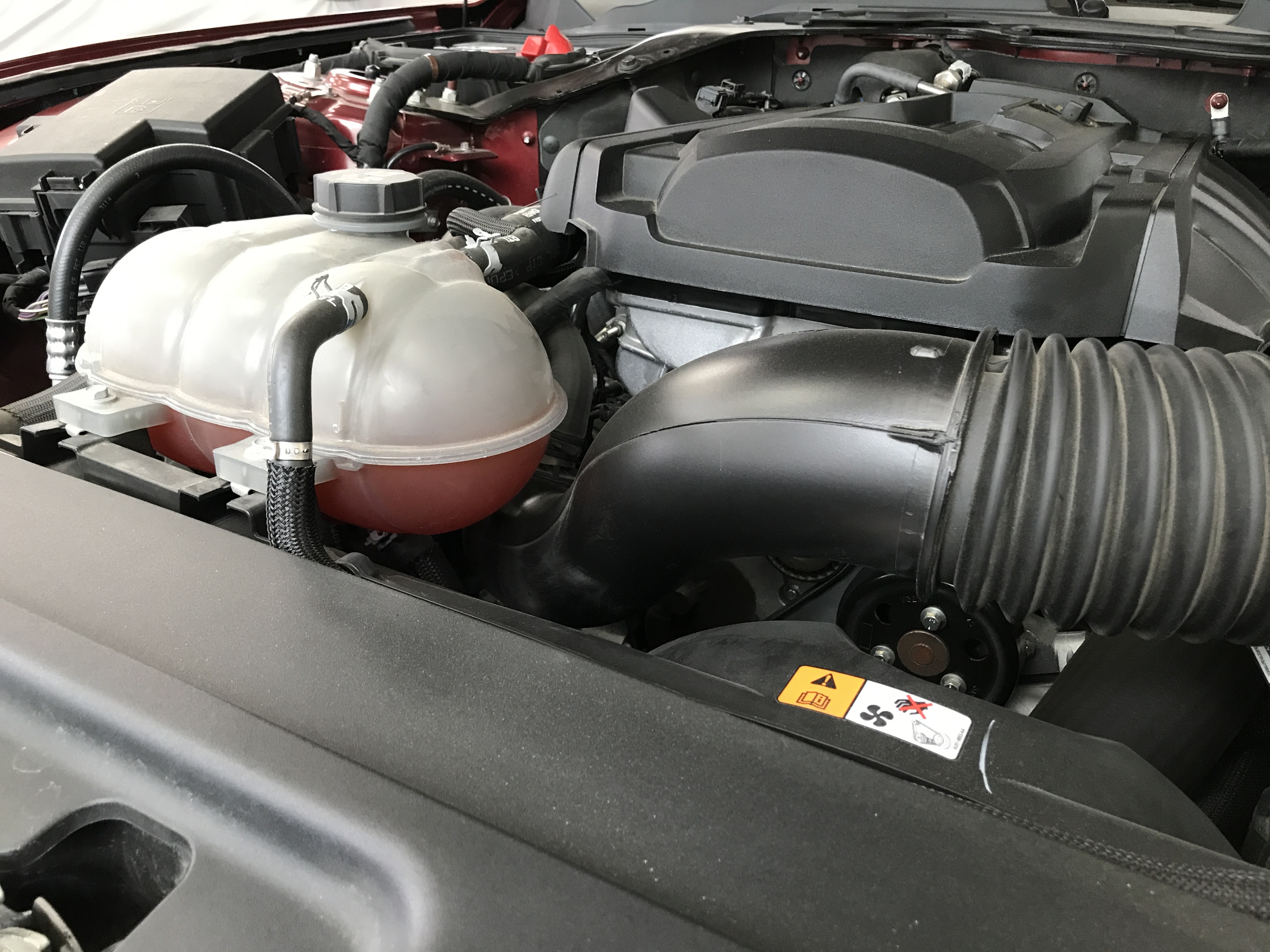

Just FYI for you Ecoboost owners out there.
Had a peak under this 2015 2.3 today and it has the orange coolant as well.
Would be just as advise-able to get it changed in those cars as much as the Coyote cars.
For sure. Flushed and replaced mine ('17 Eco) with the yellow at 90,000 kms as it was about due for a coolant refresh anyway. Dealer said the CVC-13DL-G was the compatible replacement.
