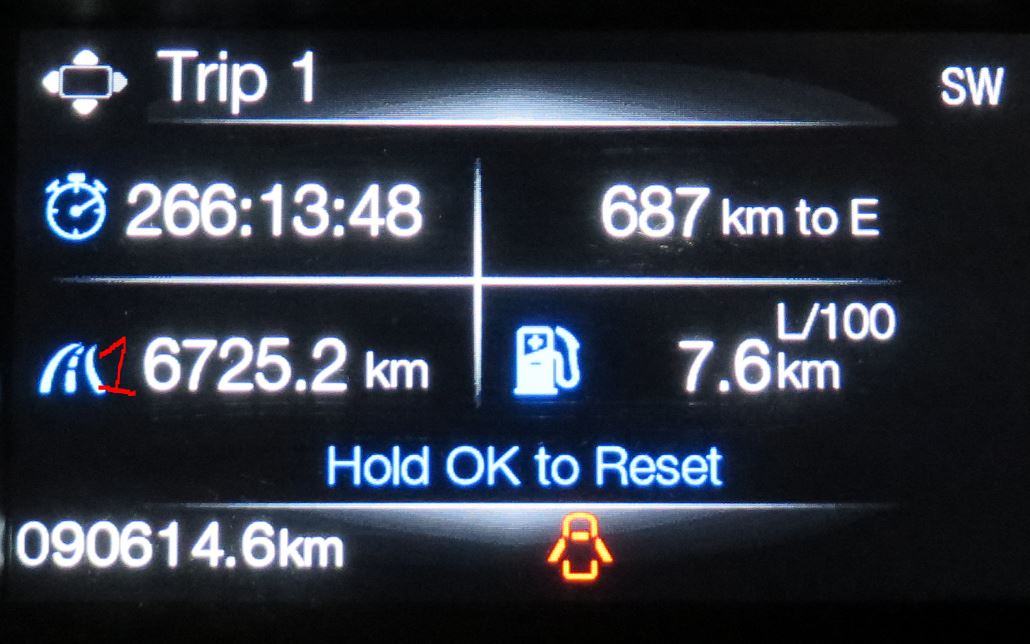

7727.8 miles, 12,429km this year across NB, PEI and a bit in NS.
That’s a pretty impressive total for the year.
I was doing 20 k in the first 3 years of the car but covid took a 5 k bite out of the last two summers of the 5 I have had it. Kids are gone so all open cruising time with nowhere else to be. Not seeing much to get excited for in the 2022 Mustang refresh. Maybe the 2024 60th anniversary might have something. For now just going with the flow.
