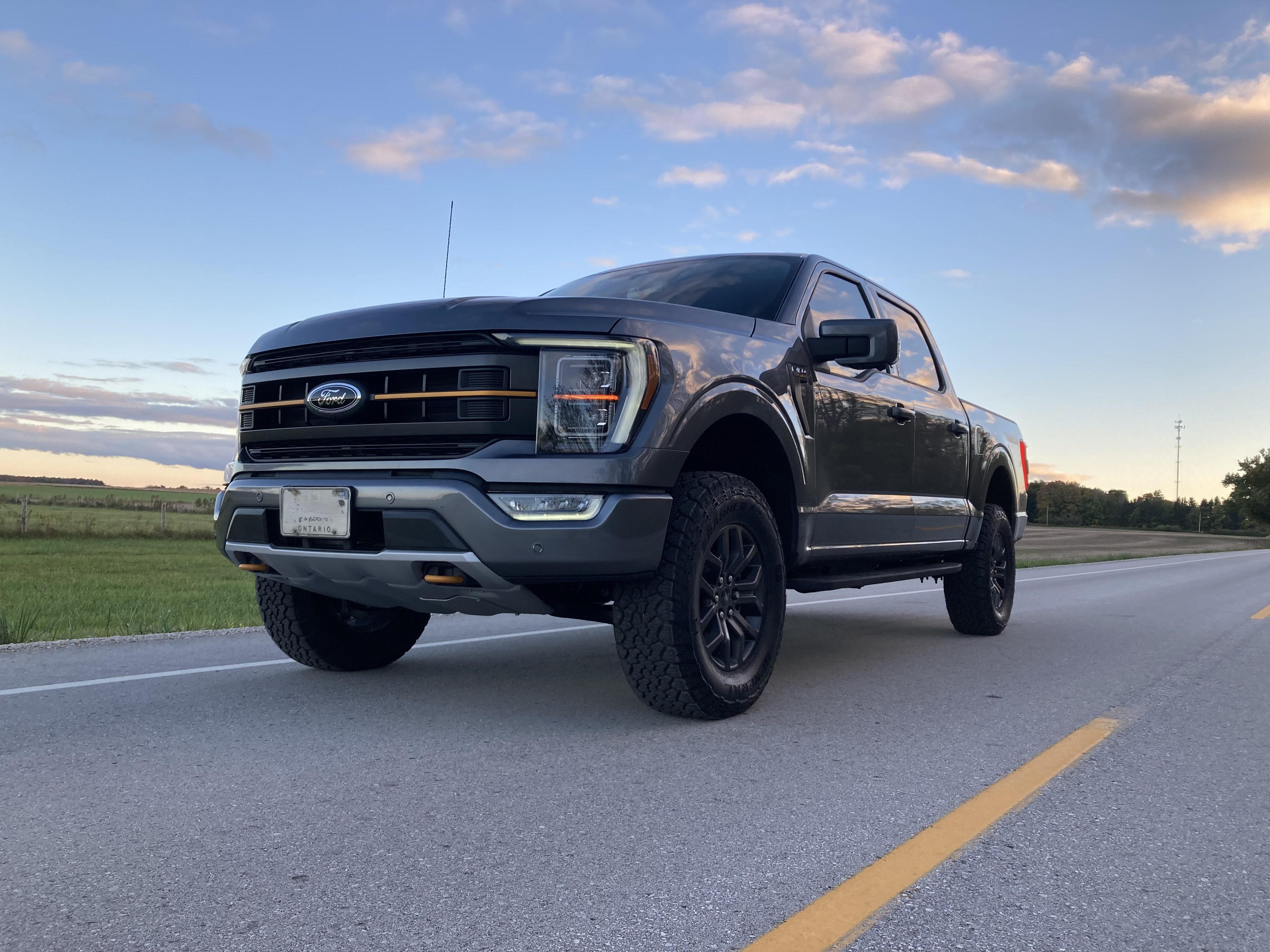

402A, 3.5L EB, Torsen Front Diff, really, really nicely executed truck.
Spray in Bedliner and levelling kit on the front end.
The Ecoboost has been a bit of a revelation, it's way better than I ever gave it credit for.

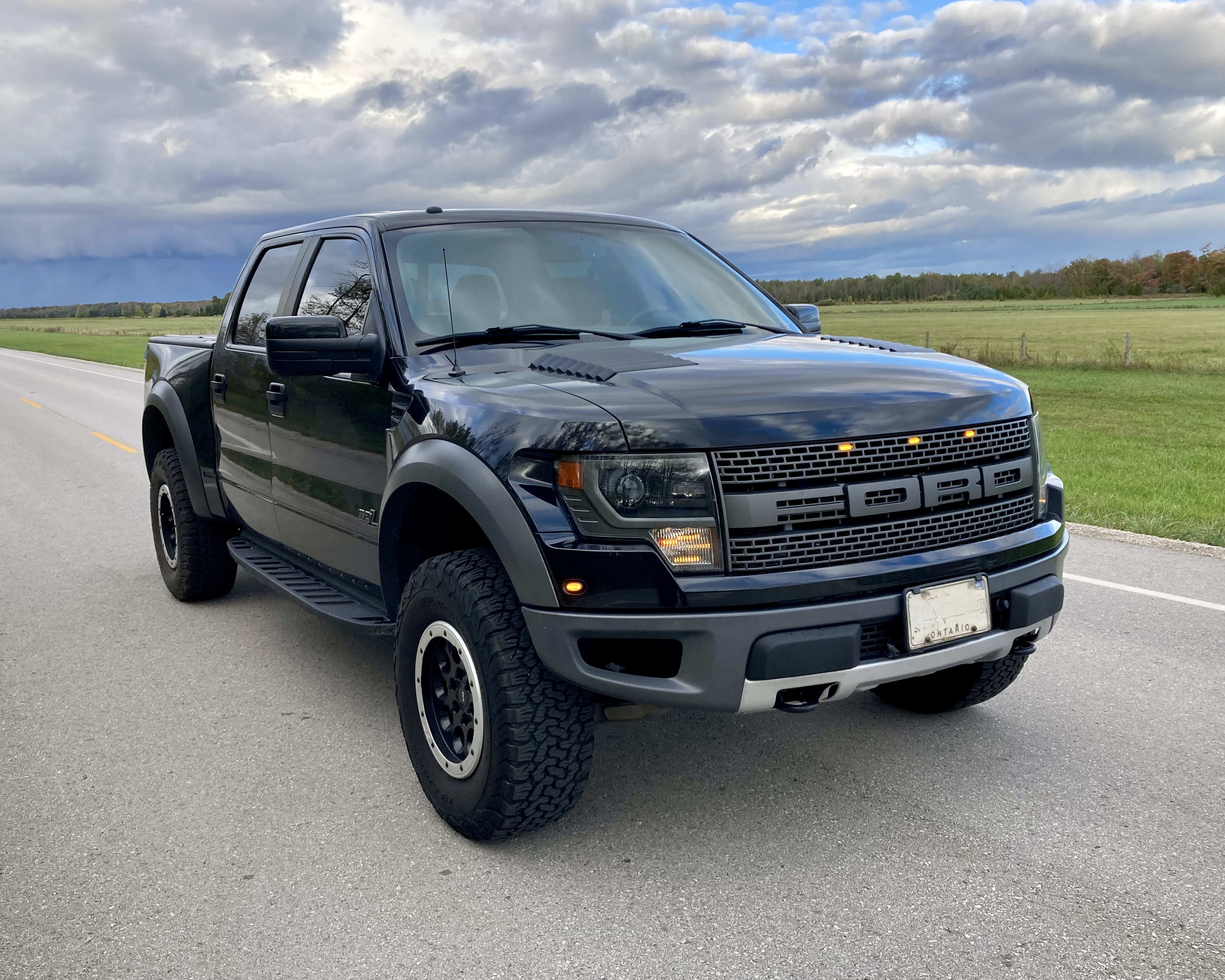

Broke my heart to see the Raptor go, but it was getting to be time, and the new Raptor didn't fit the budget.
Tremor was a nice consolation prize, and for all the off-roading I do, :LOL: , its a good fit.
Thanks guys.
I have to eat a big piece of humble pie regarding the Ecoboost Marc, it's no secret I ripped on it pretty hard.
Having driven 400 some odd km with it so far, I'm impressed with the hp and torque, I'm even getting used to the 10 speed transmission.
Amazes me that the 3.5L EB is only 11 hp less than the 6.2L, but with 70 lb/ft more torque.
The fact the Tremor is 700 lbs lighter means it's faster than the Raptor too. ( The 3.73 gears help too. )
Don't get me wrong, I still think the V8 sounds better, but you can't argue with the numbers.

Congrats Mike, that is sharp looking truck, I cam very close to buying one, when Ibought my Raptor.
Did you keep your Raptor or trade it in?
