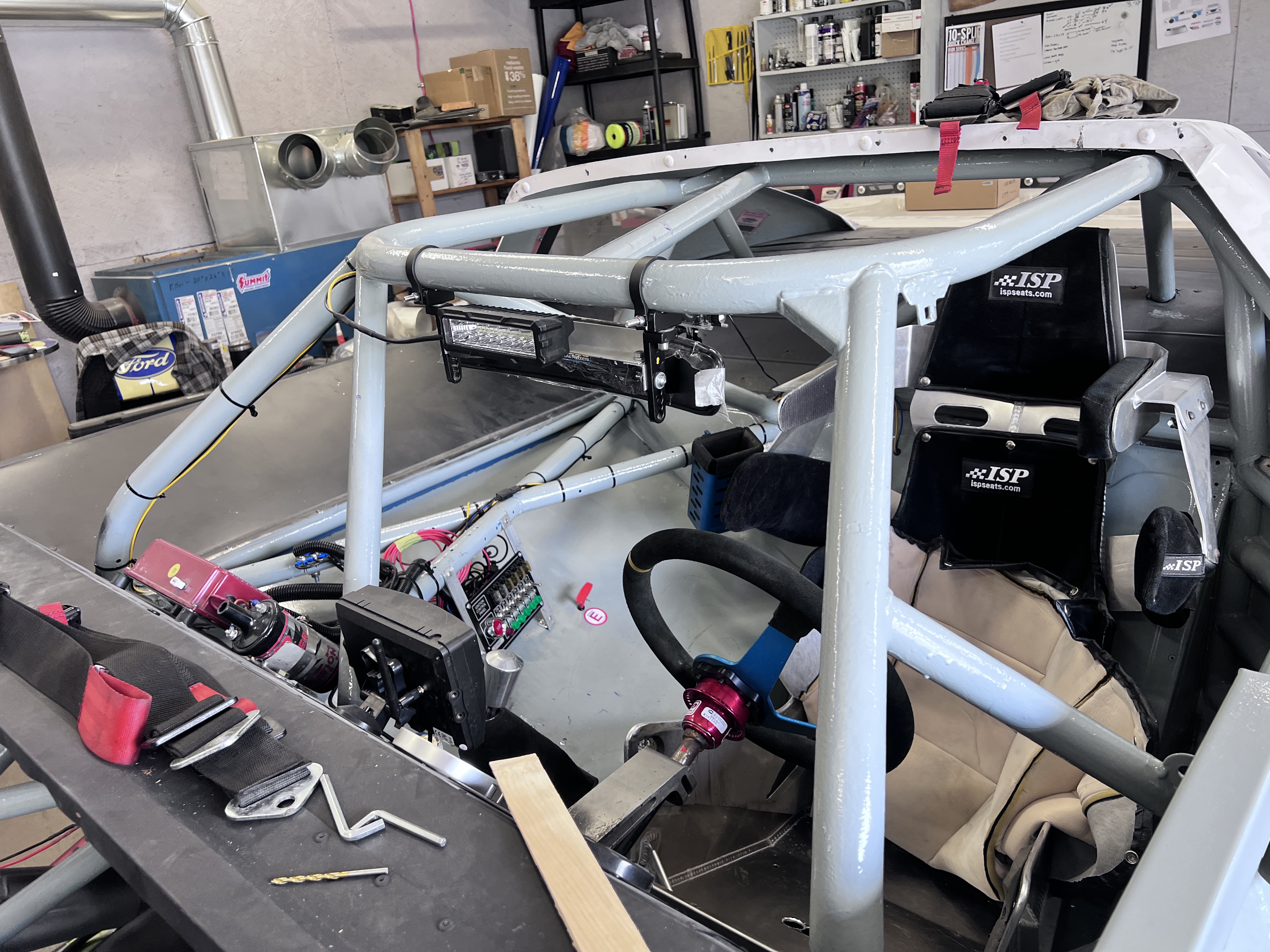

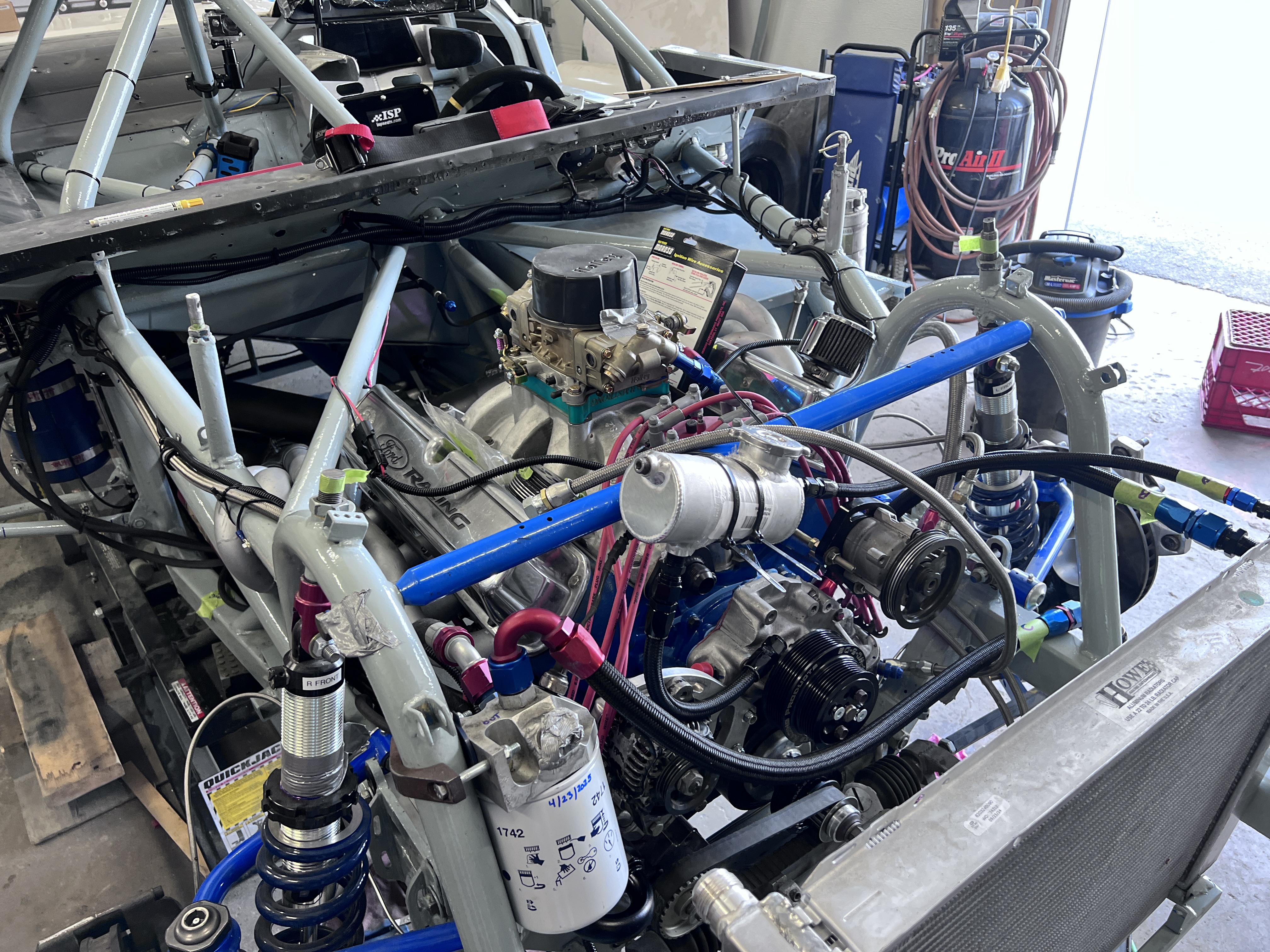

few pics, Day sump in, fire suppression in, peddales in and mounted, exuast done,
fuel system almost done, waiting for one line, Trhottle hooked up.
Gauges , power, battery and most wiring done. I am sure much more, were behind, but gaining.
rear bumper and three body panels installed.

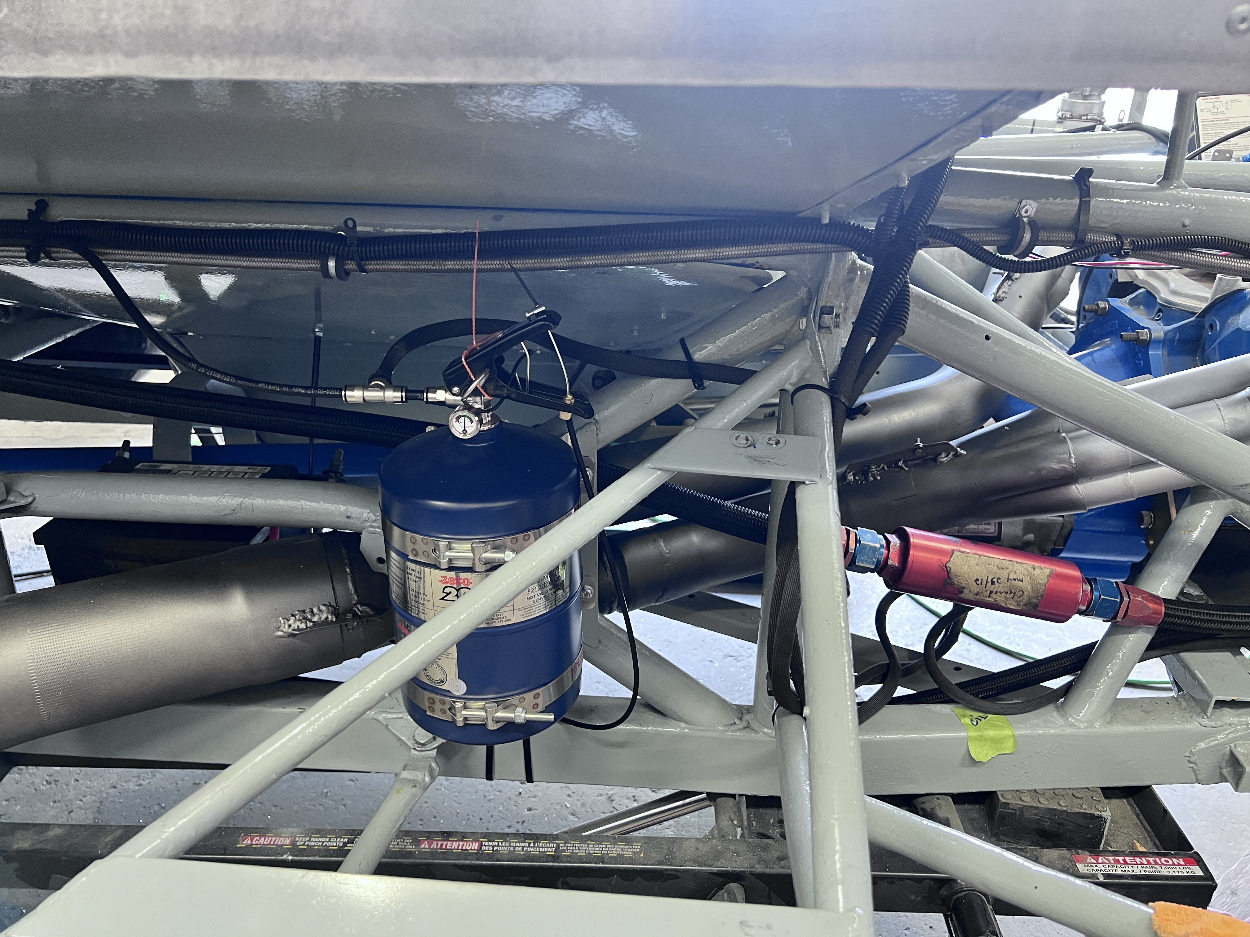

More progress made this weekend, dry sump system done, fire suppression system done, electrical done, tranny fluid in, rear end fluid in, rear lights, rain flasher and brake lights done, rear camera installed, seat and belts installed, fuel pedal installed and hooked up, brake fluid in lines bled, clutch fluid in, fuel cell filler and vent done, Battery all wired and safely mounted, along with external kill switch,
Can't list every thing in last week but getting closer
need couple belts, one fuel line, hose for rad , get that installed, some heat wrap for some electrical stuff that runs near headers.
add oil, water and fuel and we can finally start her. 😁 can't wait for this first start.

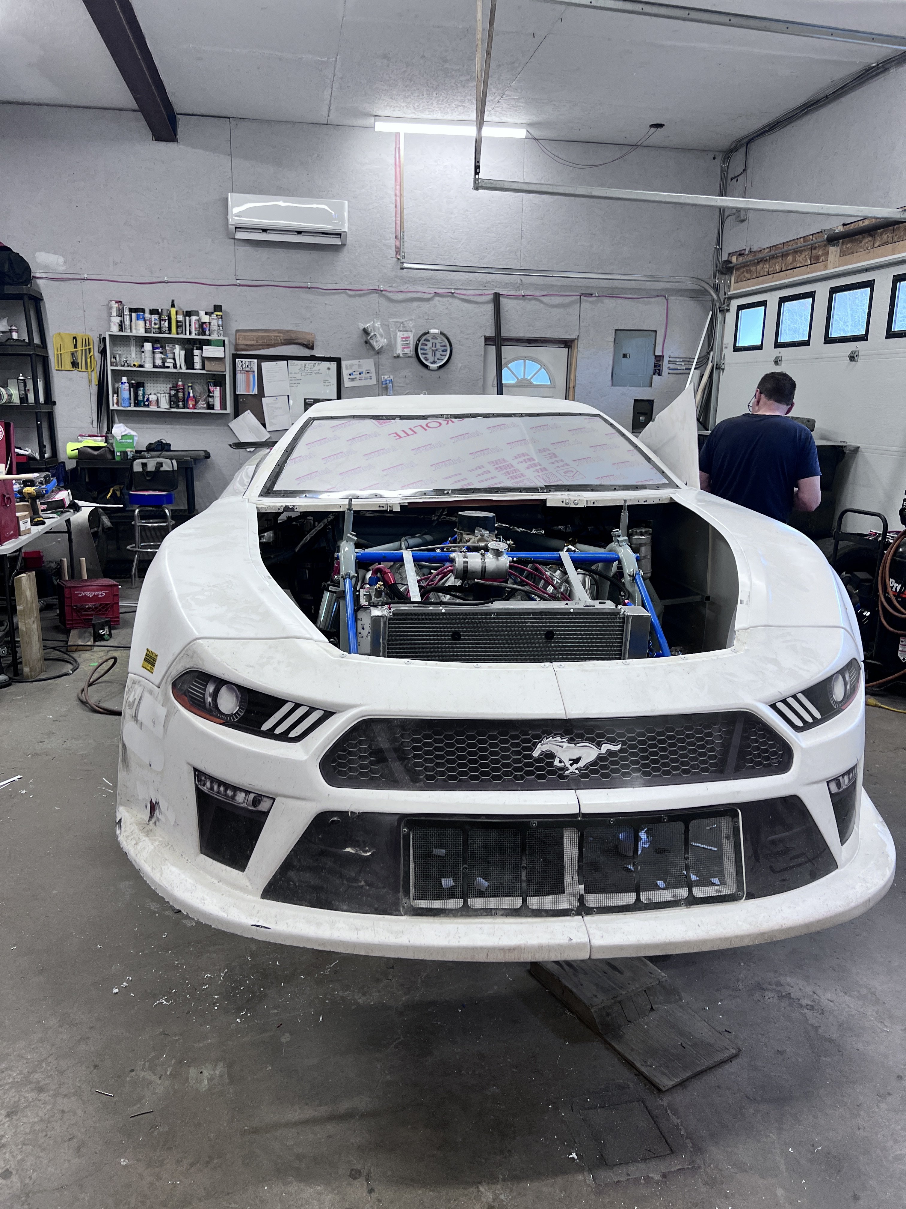

then body, with 2 new door panels and 2 new fenders, it will take some work.
likely full day to mount body, install lean windows. then we can do set up, thats likely 4-6 hours work.
We have a guy coming whose set these up and has scales to help.
three weeks to first race it will be tight to make it.

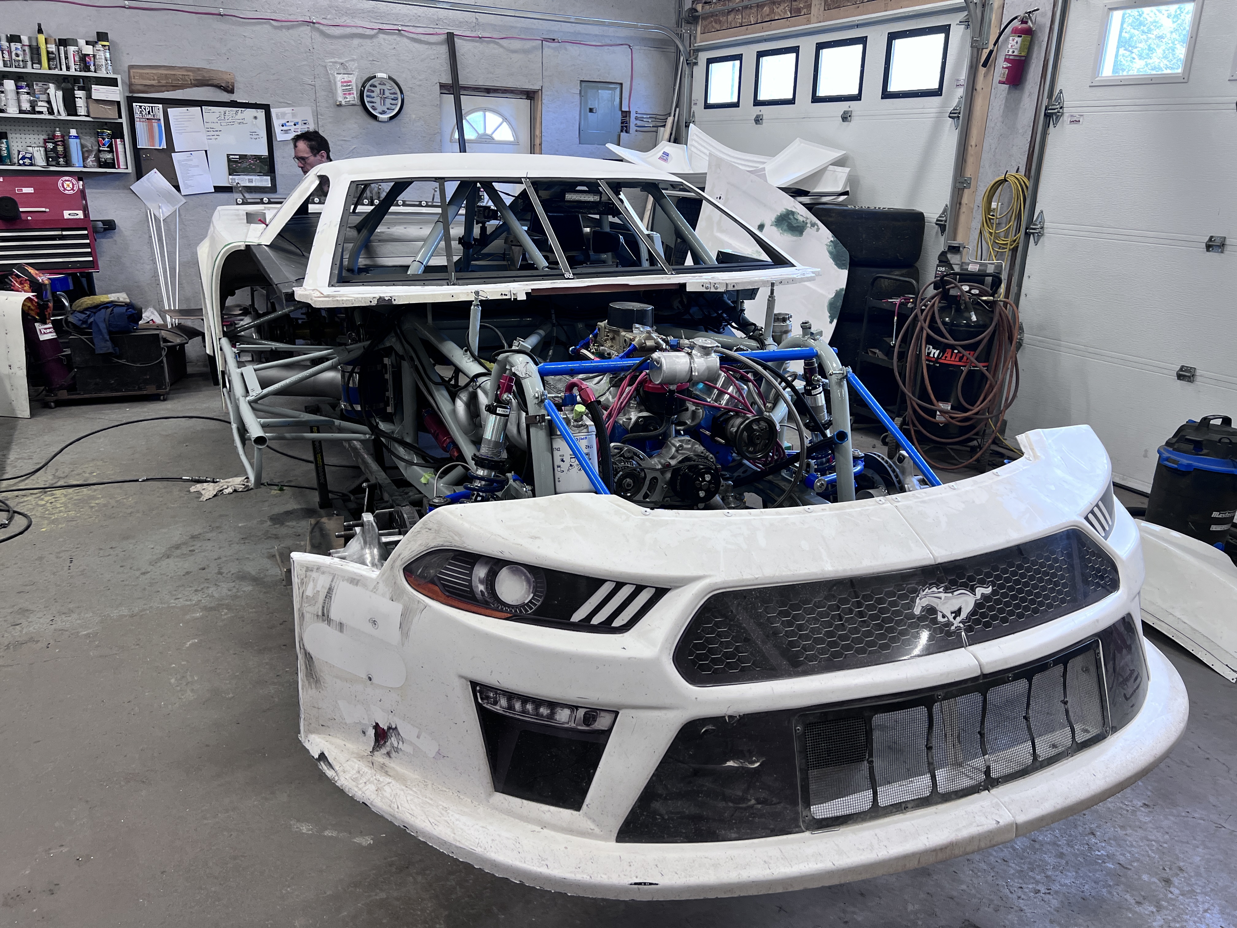

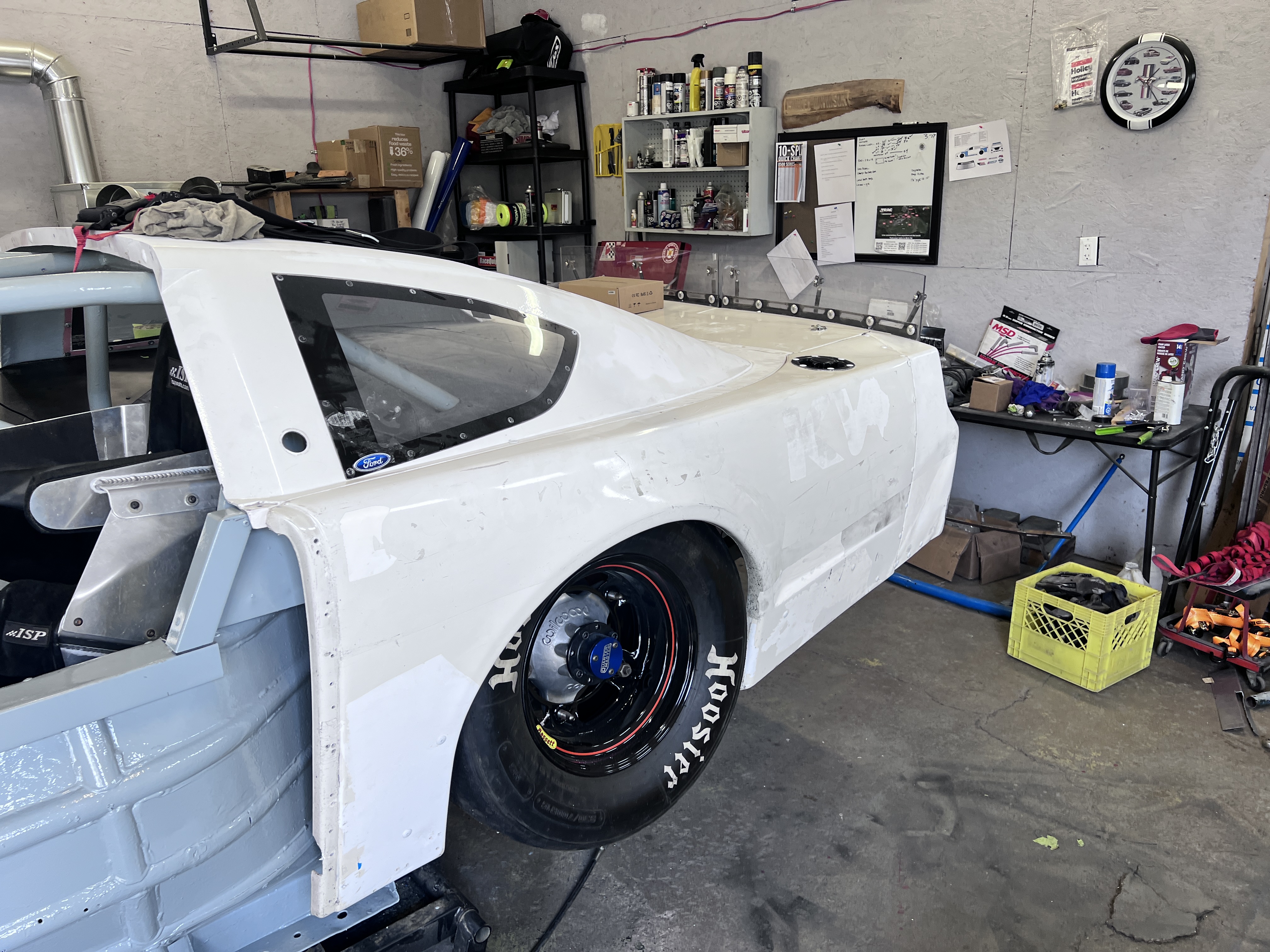

more progress today
Glass installed, two doors mocked up
rest of body tomorrow hopefully
bunch of wiring heat wrapped and tidied up.
few other odds and ends done.
Found a small oil leak, might need to make a new oil line
Of course it is not in easy play, have to remove fuel pump to take it off or do anything with it.
Also oil prssure is way to high, being new to dry sump, ( learning fast)
We think we figure out where and how to adjust pressure on side of pump.
