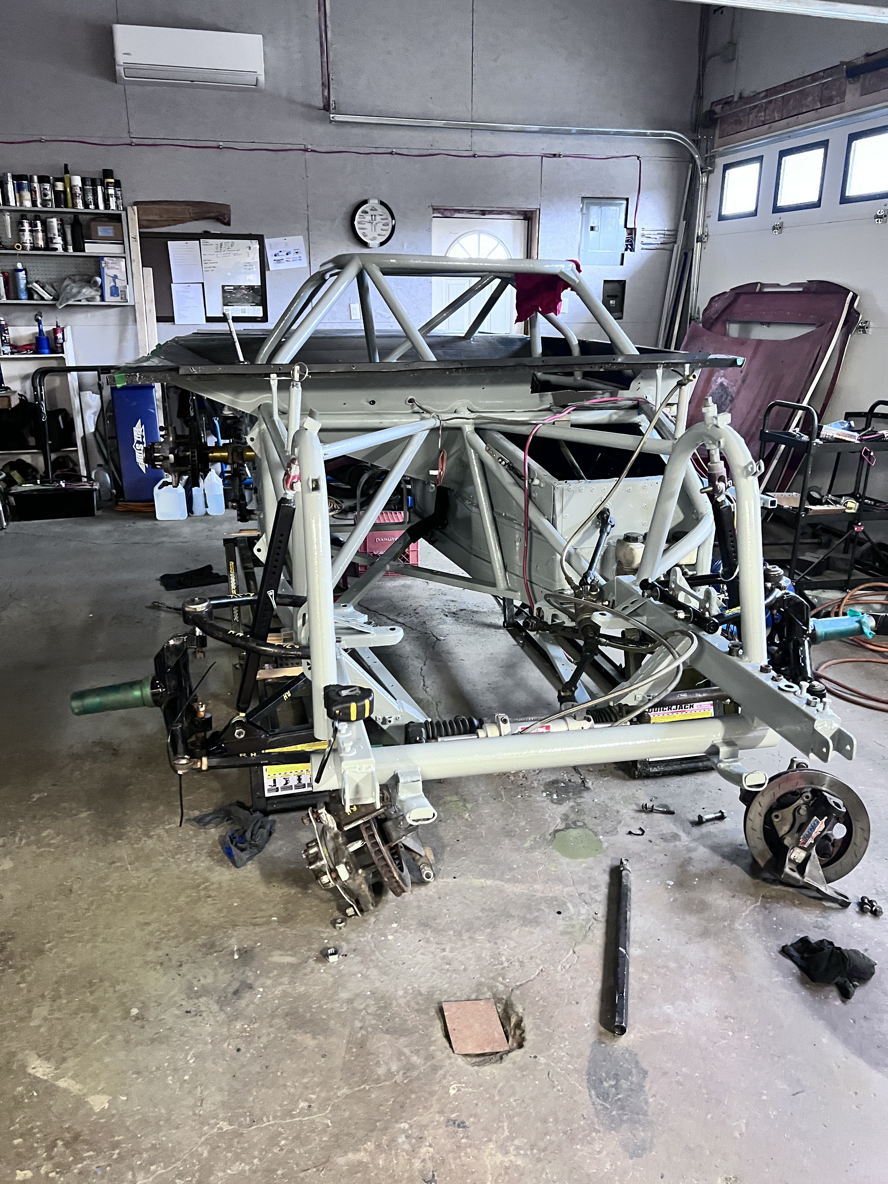

2018 Ford Mustang Pro Stock

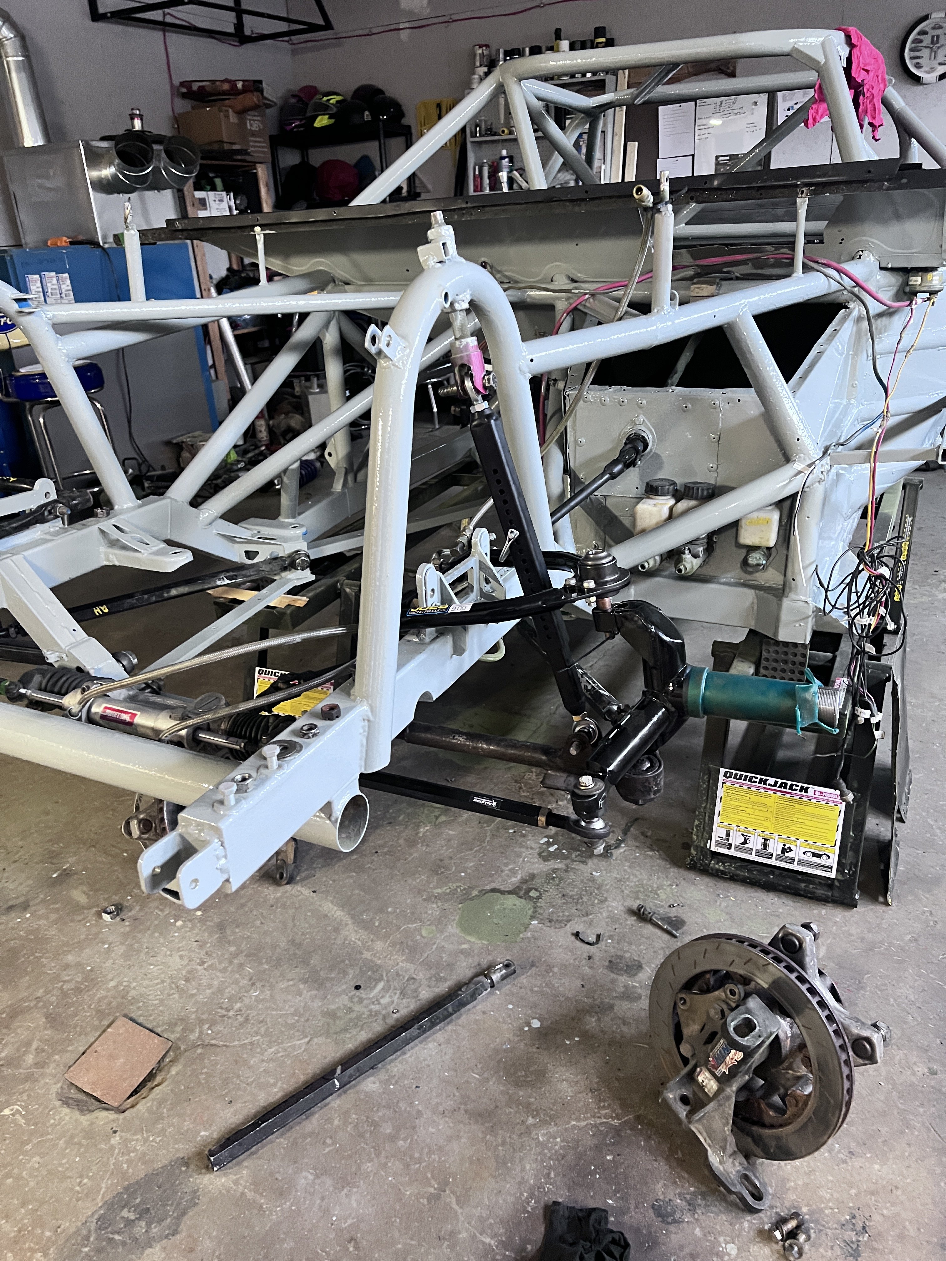

Frame sanded and painted this week, looks a lot cleaner now.

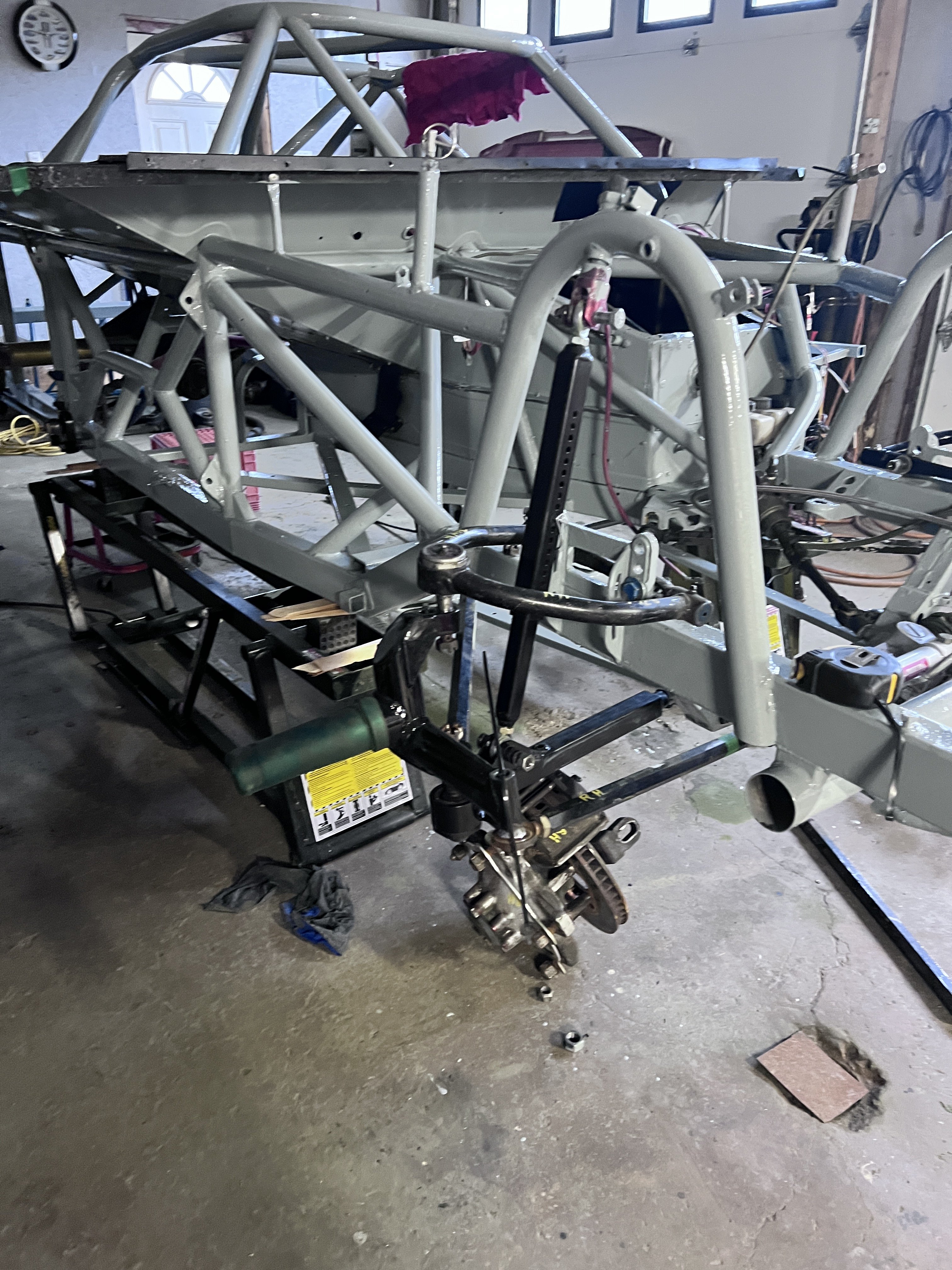

Mocked up front suspension yesterday, this now gives us shocks and springs lengths
also upper and lower A arm sizes
let the ordering begin
Also bought new fender and two new doors, so body will be good to go when ready.
need to make new front windshield and back window, we will do those out of lexan
at Glass shop, hopefully this week.

Some suspension stuff showed up, started mocking up front end
One of the new QA1 Shocks on display.

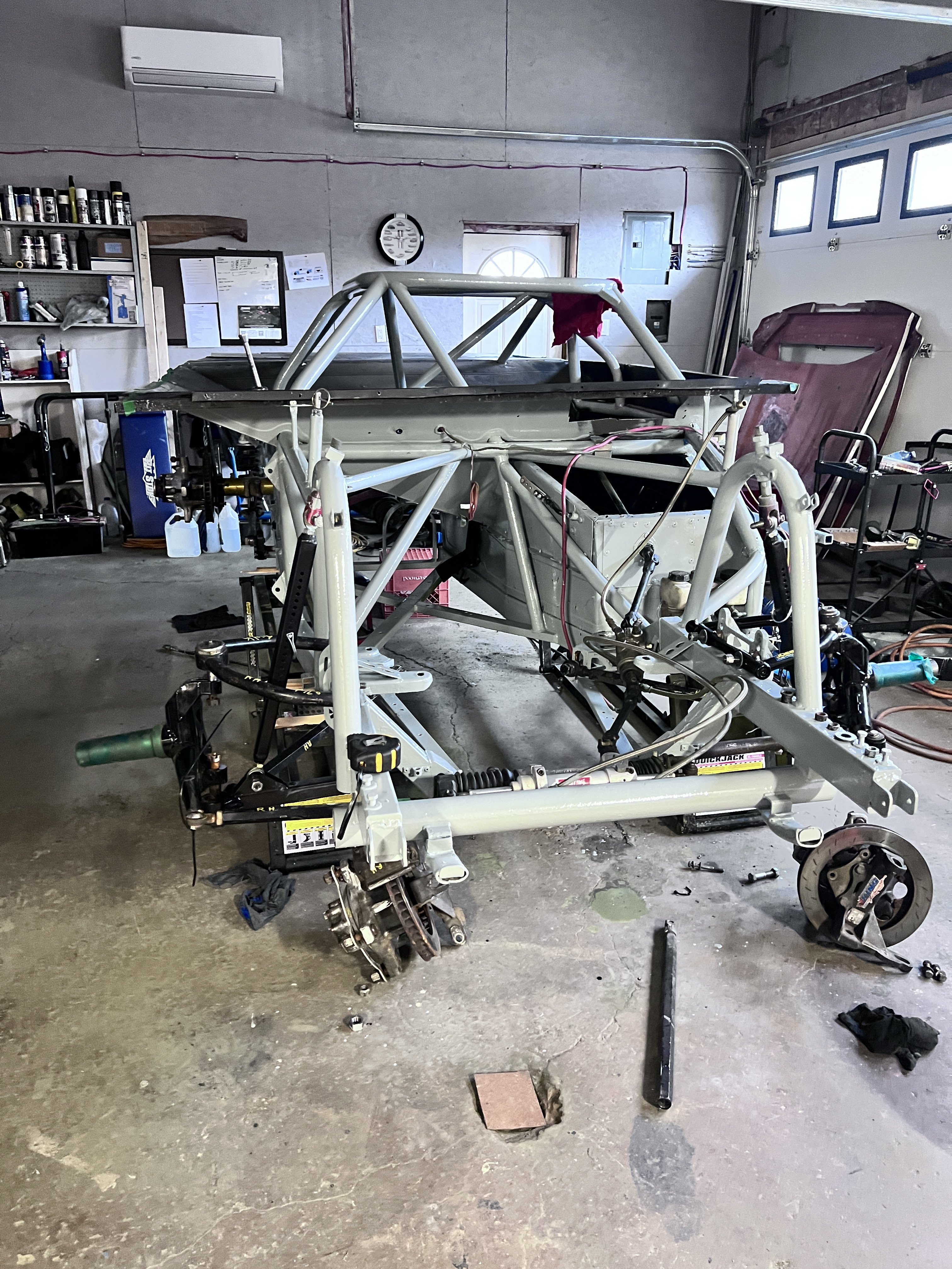

Car has been completely stripped, 98% of suspension is now here and we can start putting it together,
Rear -end comes back we install rear suspension, Front springs 800lbs, rear 400lbs fairly stiff.
I have new brakes coming, complete set up, did deal on new for 1/2 price, good way to start and leaves up some spares.
Willwood 4 pot front and rears witth PFC race pads, should stop good.
Checked in with Armstrongs, engine is due to be torn apart next week, so see what that looks like :)
hopefully have back soon. Found seat ( on its way) new race harness among other stuff.
Lots to do, seems like lots of time, but 3 months to race season, comes quick :)
