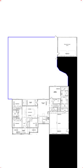

But, the good note is that we've been looking at building a house. It's still ocal, but it's going to be beyond what the local market will support for resale. Like somewhere around $100,000 above market. We're considering going so far over as we are looking at it as the last (IE:retirement) home and if we are going to live in it "forever", it's going to be what we want.
Now, that's a lot of money for the area and when we're both on fixed incomes (well, indexed pensions) ithe mortgage is going to eat up a good share of our funds. BUt we don't drink, we don't party, we don't travel (done enough of that already thanks) and the house is pretty much our world. Seems to make sense that's where our funds should go.
Here's one of the layouts we're considering:
Yup, two garages. Not going to cram myslef into a single car garage any more!
