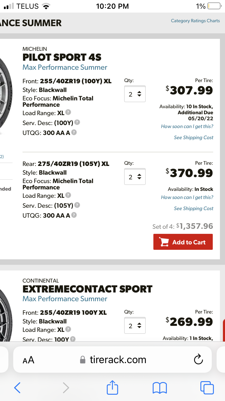

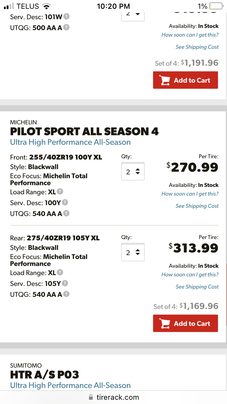

Going on Trevor’s suggestion of Pilot AS4, I went to TR and compared them to Pilot Sport 4S.
They are examples of the information above.
I used the sizes of the 2015 and up PP.
255/40/19 front and 275/40/19 rear.
Both are high speed rated at a Y rating.
The AS4 has a treadwear of 540, pretty high, and described as a ultra-high performance all-season tire.
Think touring sedans or cuv’s like BMW, Mercedes, Cadillac and the like.
The performance here is more a speed component.
The 4S has a treadwear rating of 300,
getting into the stickier range now.
They are described as Max performance summer.
Think bonafide sports cars here.
The performance here includes cornering and stopping as well as the speed element.
They are roughly $40.00 to $50.00 a piece more than the AS4.
Both can handle high speed but what you are paying extra for in the 4S is the extra stickiness. The added handling and braking ability.
But they are not made for driving in temps bellow 7 degrees Celsius.
The rubber on low treadwear tires gets hard and loses traction in cold.
They can freeze solid and they wear faster.
The higher treadwear tires maintain suppleness in cold. That’s why they are rated all-season.
They generally wear longer.
