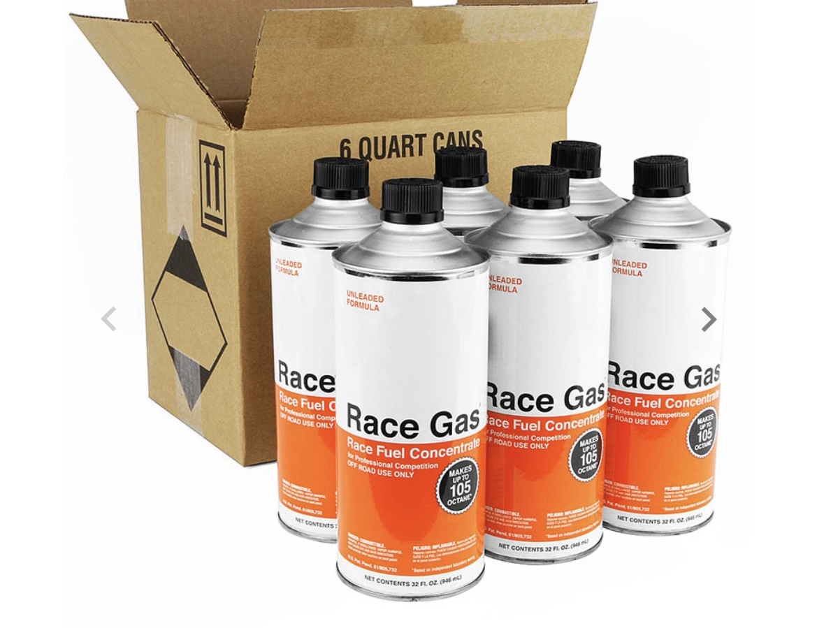

no, not sure i would want to try, only way that works correctly is if your consistent,Has anybody used a octane booster to maintain 93. (Race fuel boostane) View attachment 54383Thoughts or comments
Right on stuff is all over YouTube, good and bad reviews, just curiousno, not sure i would want to try, only way that works correctly is if your consistent,
which means premixing IMO
I share Trevor’s concerns on consistency requirement and always following the same recipe.
Some techs say it is hard on injectors, including Ford trained dealer techs.
But I can share a personal experience with my 06 last time I had it tuned.
I towed it to Dasilva’s.
Filled up with 91 octane from Shell along TCH up here before leaving.
Place very busy and sells lots of gas so supply always fresh.
Laid down good numbers on dyno.
When all was done, Matt Dasilva asked me if I was curious as to what a 93 tune would give me compared to the 91.
They sell similar race fuel additive octane boost at the shop and assured me it was safe to use.
I agreed to try out of curiosity.
So he poured some additive in the tank and did his thing on the laptop and did another pull.
The result was only 2 extra hp over the 91 tune.
Matt told me I had very good gasoline and to keep using it, and not to bother with the additive.
In my case, it was not worth it.
And, I feel better driving that combo.
I’m not afraid of detonating a piston.
How long did Matt wait or drive the car around before doing the pull with the booster. What I see there could be a 20 to 40 minute mixing time before it gets to the injectors, if not per mixed and add to make a full/half tankI share Trevor’s concerns on consistency requirement and always following the same recipe.
Another thing, the Irving refinery in St-John is one of the most modern in the country.
And Irving keeps the best gas for its own flagship stations.
So if you have access to a busy, high volume Irving station near you, consider filing up with that before you ship your car, have it tune with that and keep using it after.
Your result might resemble mine.
Not that much gain with the additive.
