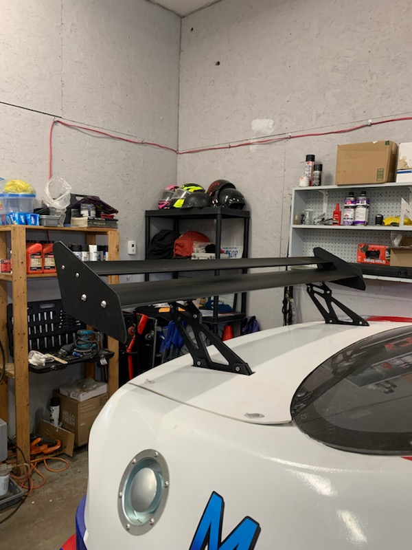

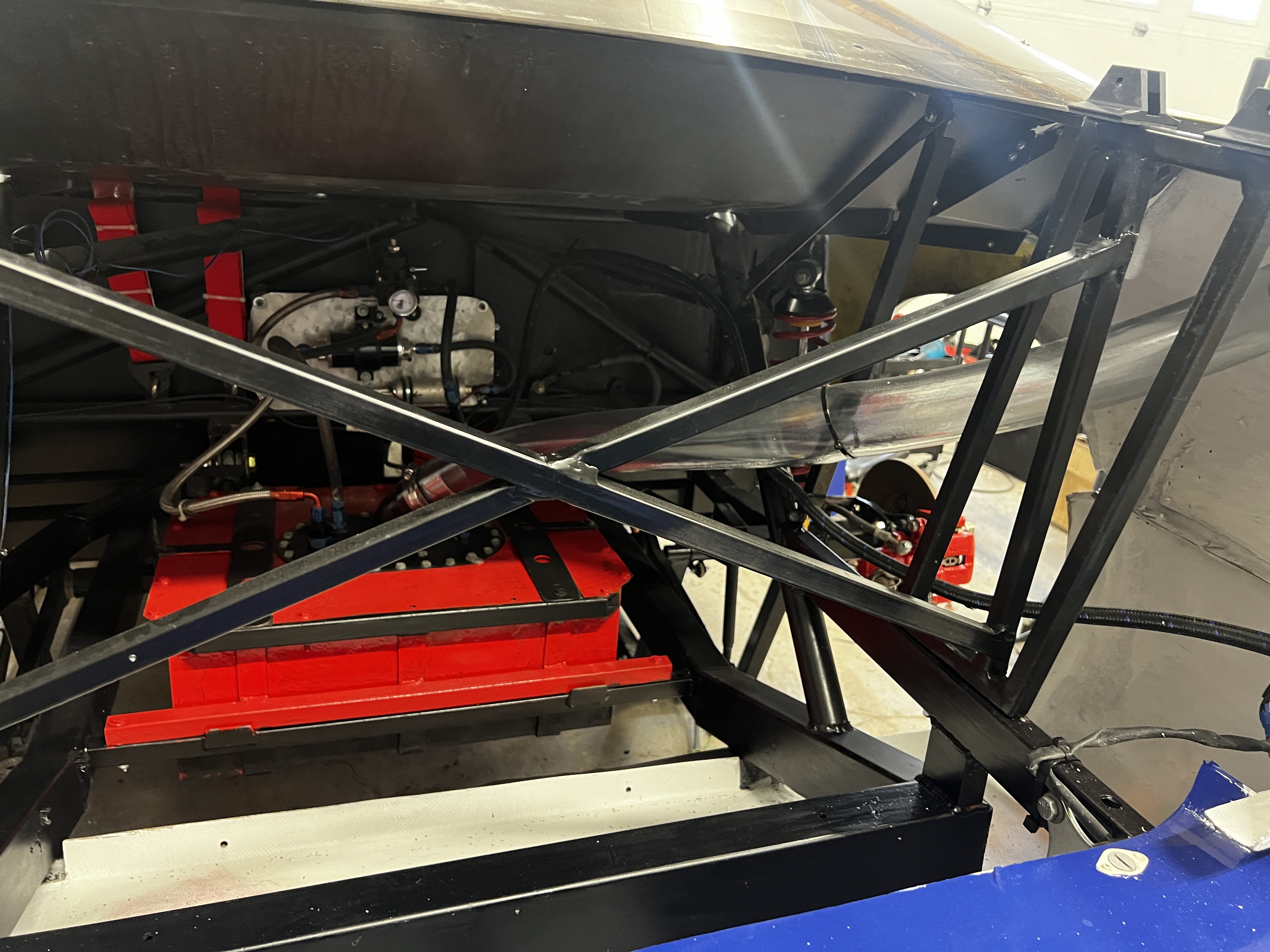

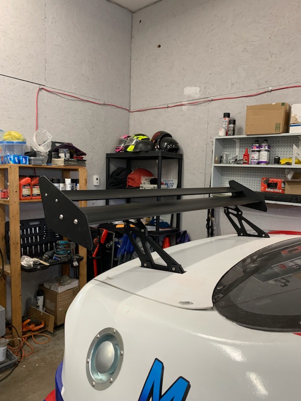

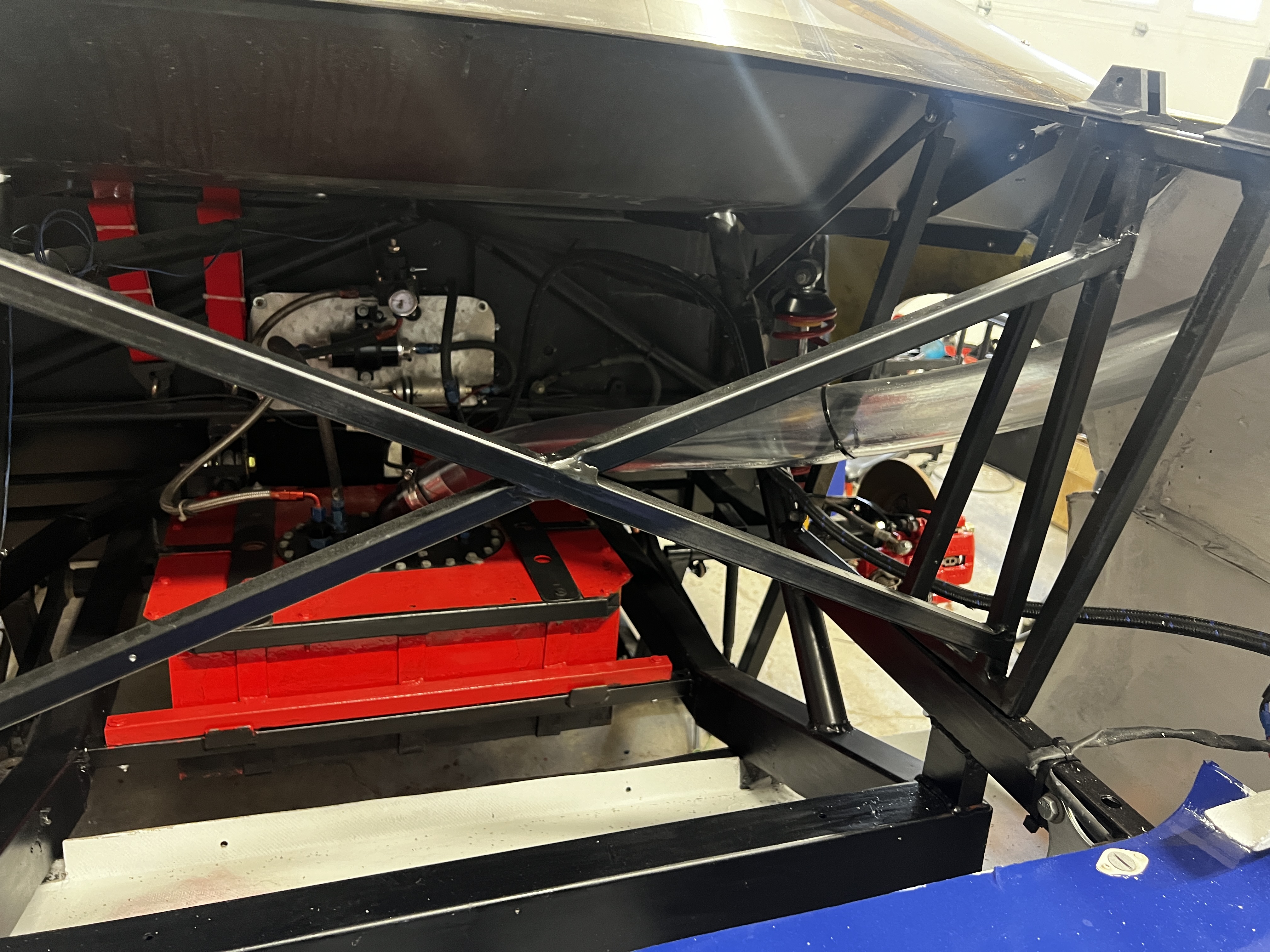

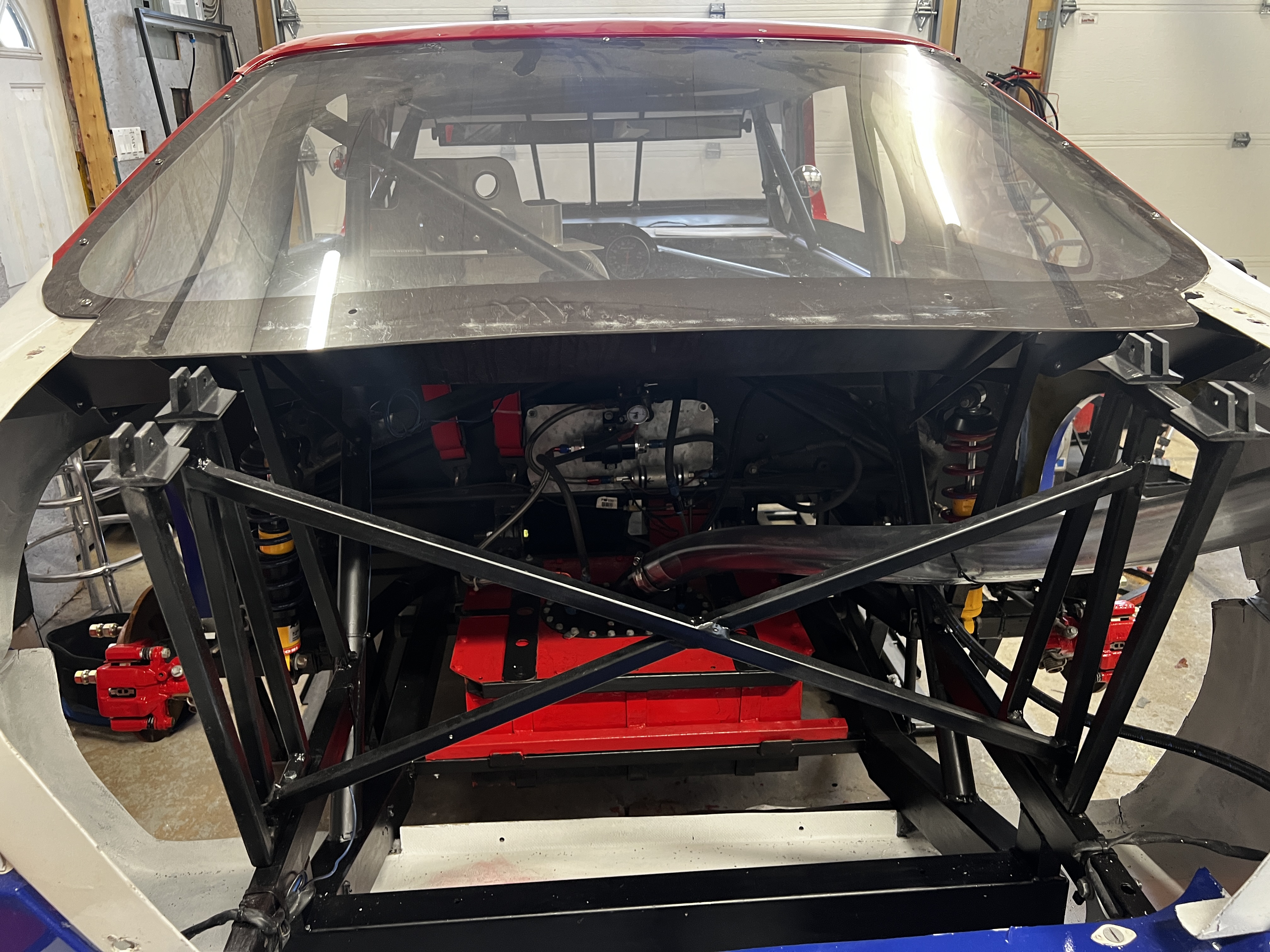

heres a few more pics, tuner is coming this week to program new tuner, adding a couple more things, but after tune it can go to track, were ready
few pics. soon going to be real fun :)
$68.00 dollars for this wing, hard to even comprehend lol
