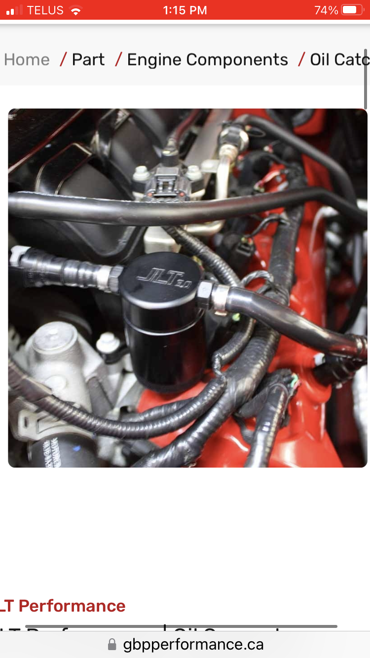

The oil separator will do more good than it will harm, it's a pretty non-intrusive mod and easy to install.
Should have OEM style connectors and drop right in, at least mine did, JLT and Ford Performance both.
All I had to do was pull the OEM tube from the valve cover to the intake and replace with new lines and separator.

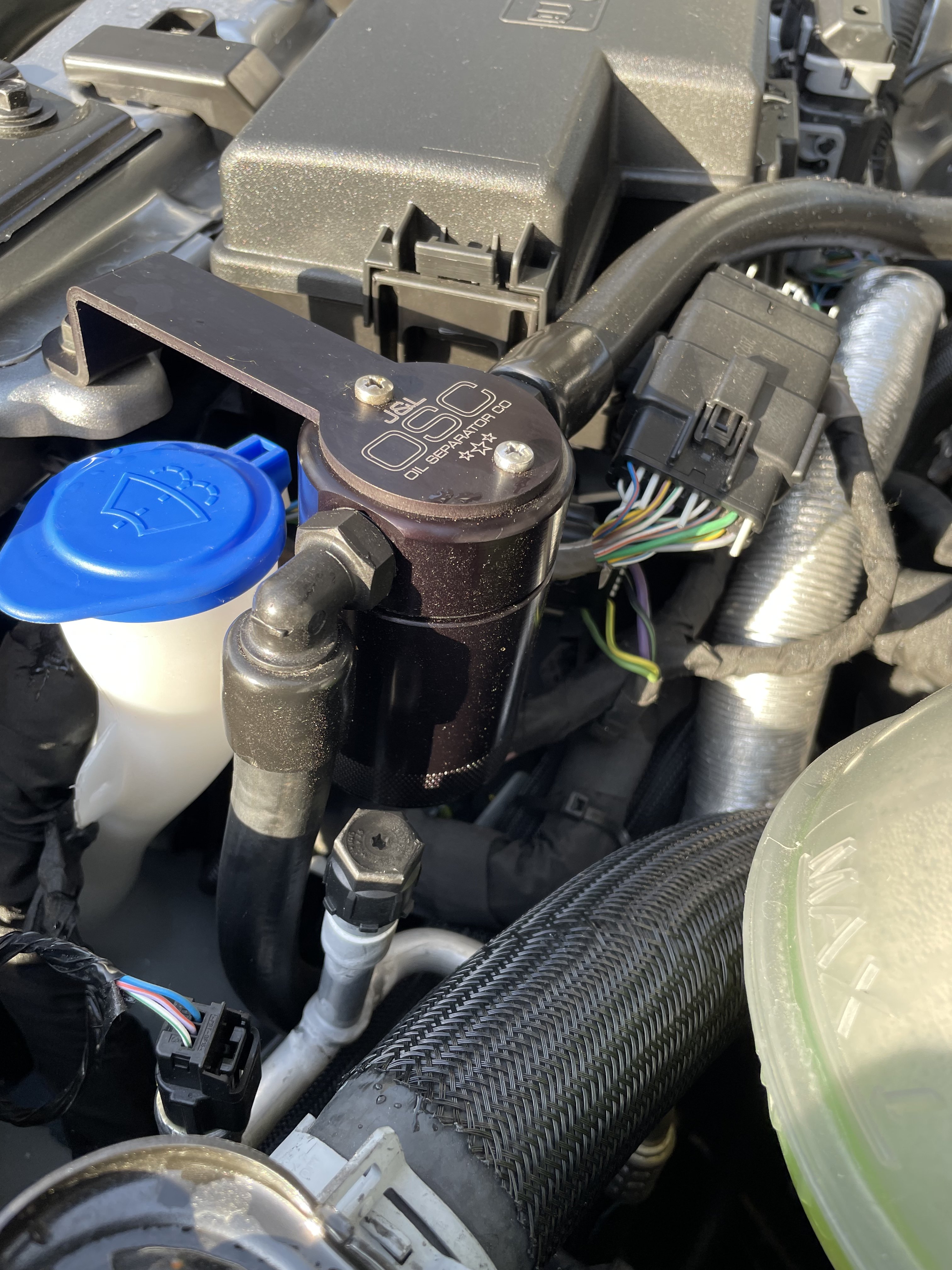

Like Mike (svt4mt) says, they can hang at the end of the plumbing in front of the valve cover, like in the case of Coyote engined cars.
Or over the valve cover, as in the case of the 05-10 cars.
They’re not heavy and don’t cause any damage.
Unless the manufacturer supplies a hanger and hardware, like in the Mike’s (Mike 2021) picture.

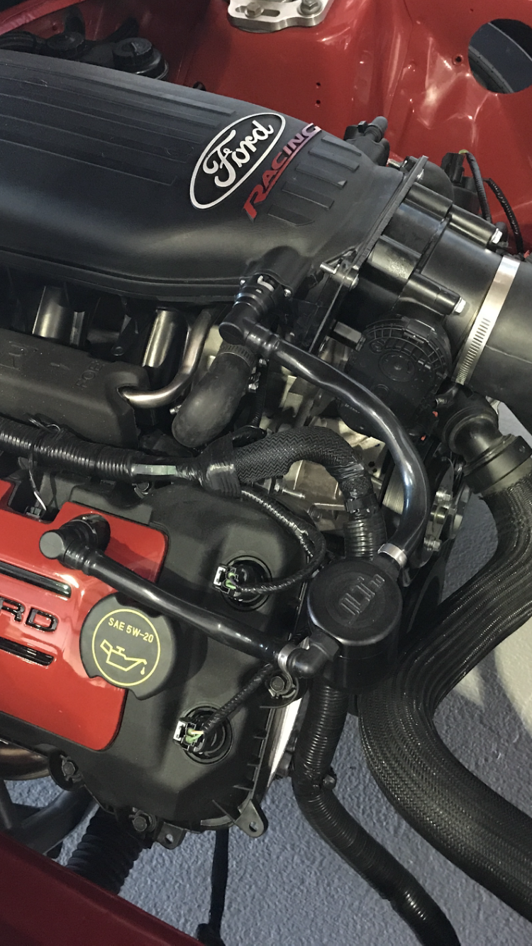

I have one anchored on the Driver side in the 06 because the plumbing was custom made to fit with the Ford Racing intake manifold and the plumbing is longer than stock setup.
Otherwise, the stock Driver side setup would just hang supported by the plumbing.

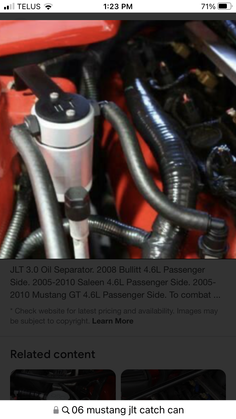

Or this is a remote setup on the Passenger side of the 05-10 cars because the plumbing is longer to leave room for the oil filler cap.
The reservoir is bolted to a flange on the strut tower because of longer plumbing.
My 06 setup looks like this but on Driver side, because of intake manifold.

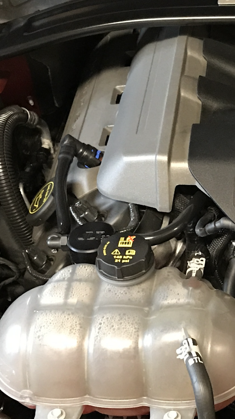

The other in the 15 just hangs at the end of the plumbing. It just rests in front of valve cover on whatever other wiring is there.
It is not heavy enough to cause any issues.
