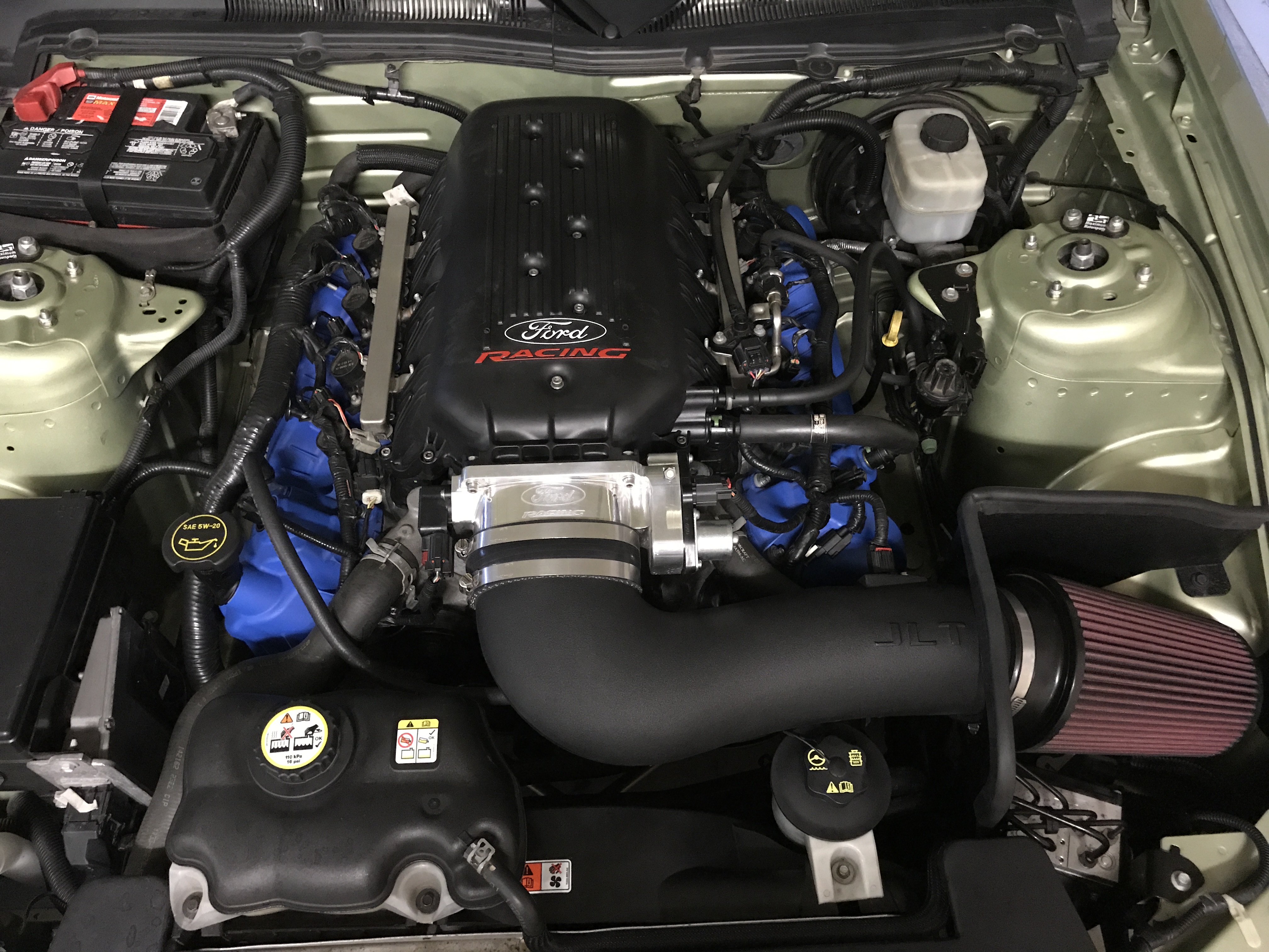

The plan was to do ported heads, a big cam and incorporate Ford Racing’s open plenum, high flow intake manifold.
A manifold similar to the Cobra Jet or Boss manifolds of the 5.0 litre generation but made for the 3 valve 4.6.
Since this intake relies on higher rpms for power, the rpm redline would be bumped up to 7500 from the 6000 factory setting.

Because this Ford Racing intake manifold is taller than the OE manifold, the strut tower brace had to be removed.
I tried a V6 brace and it also was not tall enough to clear the new manifold.
I then tried a Boss brace and it was tall enough but it would not allow the hood to close.
So the car is without a brace now.

And, the look of the engine bay changed with these mods.
Here is what it looks like now.

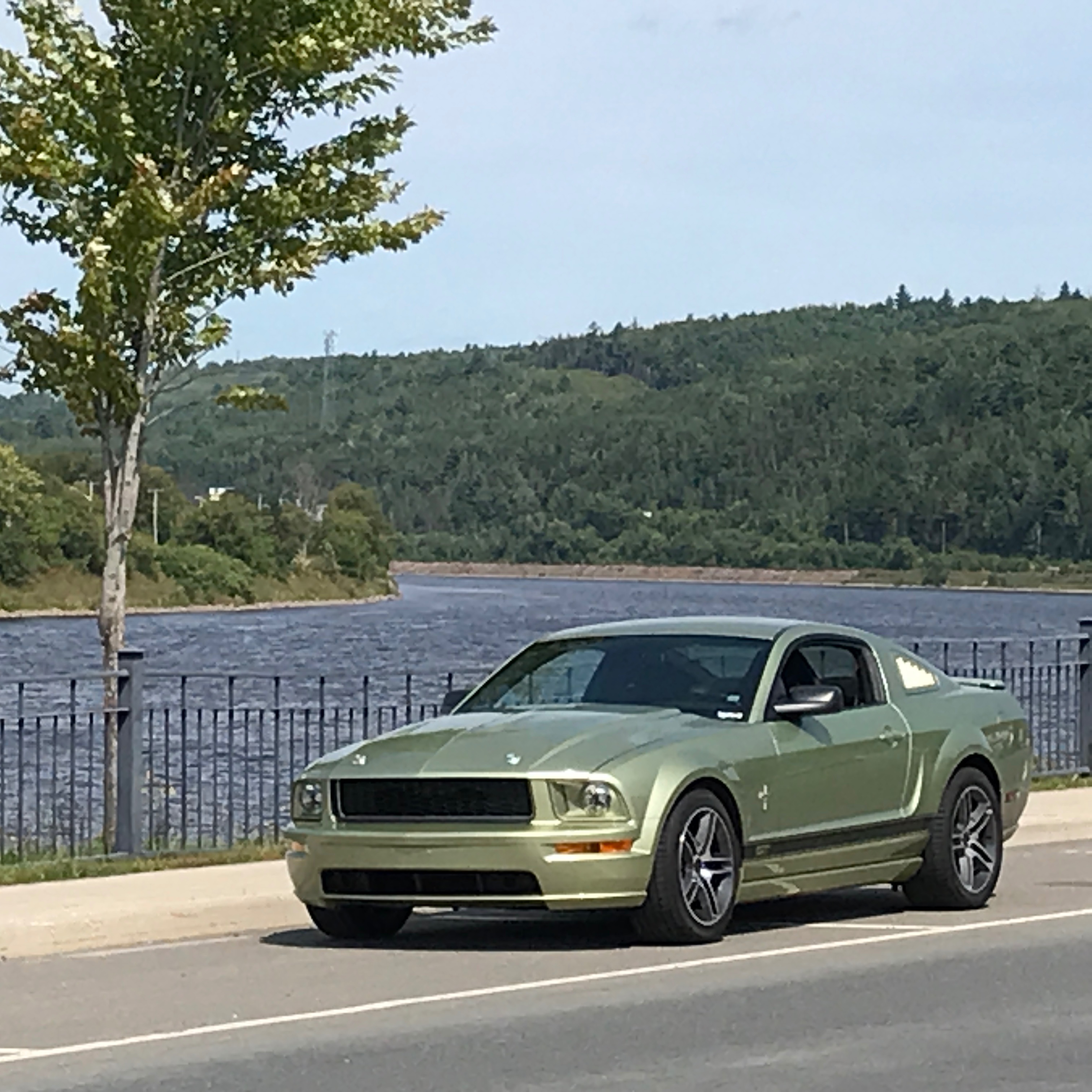

Well broke out the green monster this morning.
Drove it to work and had oil change done and alignment checked.
I hope we can say holy crap on this forum.
Because “holy crap” is that car fun to drive!
I forget from year to year, but man it’s a thrill.
Despite what I said above about the intake manifold taking away some bottom end, what a thrill when it hits that 4000 rpm mark and opens up.
Both in velocity and sound.
It’s a manual, so you keep the rpms in the range with gear shifts.
I call it keeping it on the boil.
It’s not a torque monster so if you want to go, you rev match, drop a gear, bury your right foot and enjoy the experience.
