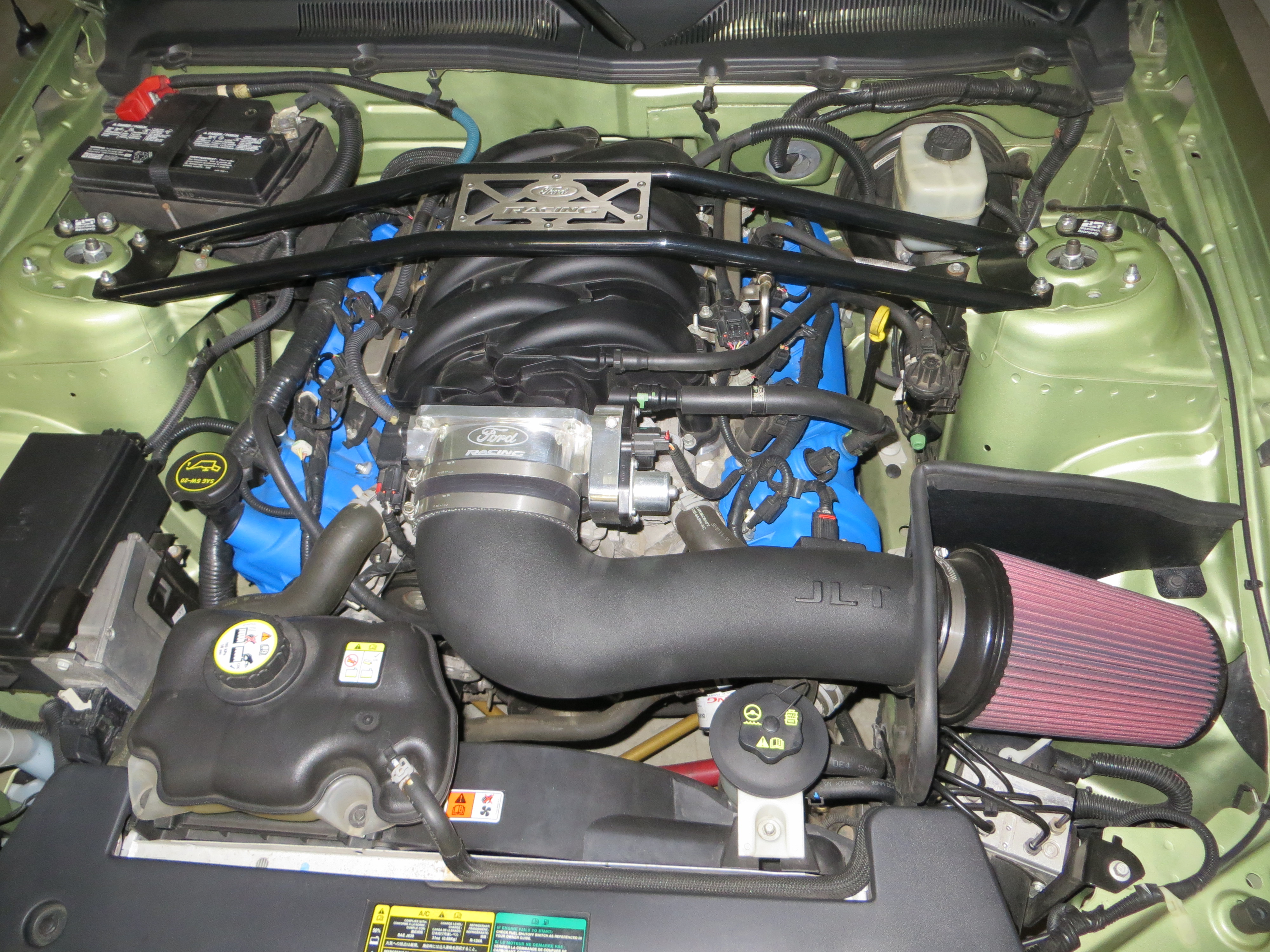

I forgot to include that I had also kept a set of Granateli Motorsports under-drive pulleys from the 2005 and had those installed during that first round of mods in 2011, along with an Axle Exchange aluminium driveshaft, also kept from the 2005.
The drive shaft was done for weight savings, both overall weight, and rotational weight so the car can get going quicker.
I forget the details but I think something like 20 lbs savings on the driveshaft.
Also saved a fair amount of weight with the Recaro seats because they are not power seats and are built lighter than the OE seats.
Again an estimate only, but something like 20 lbs per seat.
As well, when the cams were done in 2012, I also added a Ford Racing twin 62mm throttle body.
Also, when I did the Brembo brakes, I upgraded the brake lines with stainless steel braided lines from Goodridge, and bled the system and used Motul full synthetic DOT 4 brake fluid.
I also did brake cooling ducts from JLT.
The ducts and FOT 4 fluid was intended to deal with heat on track.
The stainless steel brake lines were also meant to deal with heat because they don’t expand when hot like rubber lines can.
The SS lines also provide a much improved pedal feel all the time, allowing for better pedal modulation and control.
The cooling ducts are relatively inexpensive but work well.
Like ducts on NASCAR racers, they route cool air from the front of the car to the back side of the front rotors and on to the front wheel bearing to keep things cool.
A main consideration on track.

In addition to BMR relocation brackets, I got some additional chassis bracing in the form of an A arm support brace from BMR and a K member to rad support brace from Whiteline performance.
The BMR piece is basically a K member brace like the Steeda G track brace.
All this bracing in anticipation of taking the car on track.
I also concluded that I was not using the AC enough, or at all, driving windows down all the time so I decided to get an AC delete to dump a bit more weight and free up a couple extra hp.
I didn’t weigh the stuff at the time but wish I had to get a clear picture of the weight savings.
All the plumbing and the condenser came out but those are mostly aluminium parts except for the fluid reservoir so not a great amount of weight.
Maybe around 10-15 lbs.
But the compressor was a fair bit.
Maybe 10-12 lbs by itself, but weight taken off the very front of the car ahead of the front axle, so helps the balance of the car.
Another positive for track use is that removing the condenser from in front of the radiator now allows the radiator to get fresh air to hit it directly without having to first pass through the AC condenser.
I imagine this makes the radiator a bit more efficient.
After installing the rear relocation brackets, I noticed improved rear axle traction.

By 2014 the 4.6 3 valve was in its 10th year and development on CAI’s had come a long way.
The Boss 302 was demonstrating adeptly how naturally aspirated engines could produce power.
About that time, I also read an interesting article about air flow, CAI’s and throttle bodies.
All about CFM’s of air flow and efficiency.
The big takeaway for me was that the Ford Racing throttle body that I had on my car was capable of much more flow than what my C&L CAI was capable of putting through it.
Basically, my limiting factor was not my TB but rather my CAI.
So, off I was to Pickering again in search of more flow and power.
In speaking with Matt Dasilva, he related his many test and tunes on the dyno demonstrated to him the best CAI for the 4.6 3 valve was the then fairly new, JLT series 3 CAI.
Obvious to the naked eye was that this CAI had a much larger inlet tube than all previous 3 valve CAI’s.
Another added bonus was that the inlet tube on this CAI was made of composite plastic, which made it more resistant to heat soak than a lot of earlier aluminium CAI’s for the 3 valve.
Examples of those early aluminium units are the C&L, which I had, and the also popular BBK.
So I had the JLT installed along with a set of charge motion delete plates from Steeda.
The result was simply impressive and surprising to me.
I expected maybe another 10 hp or so if all went well.
Well the net gain was like another 21 hp over what I had before.
This put the car above 400 hp, naturally aspirated, with little more than bolt ons.
It was somewhere in the neighbourhood of 405-410 hp.
Back when the S197 came out in 2005-06, you needed a supercharger to get those types of numbers.
Clearly this JLT CAI was maximizing the capability of the FR throttle body.
Here is a look at what the new engine bay looked like with the JLT CAI.
Compare to the photo a few posts back and you can visibly see how much larger the inlet tube is over the C&L.
