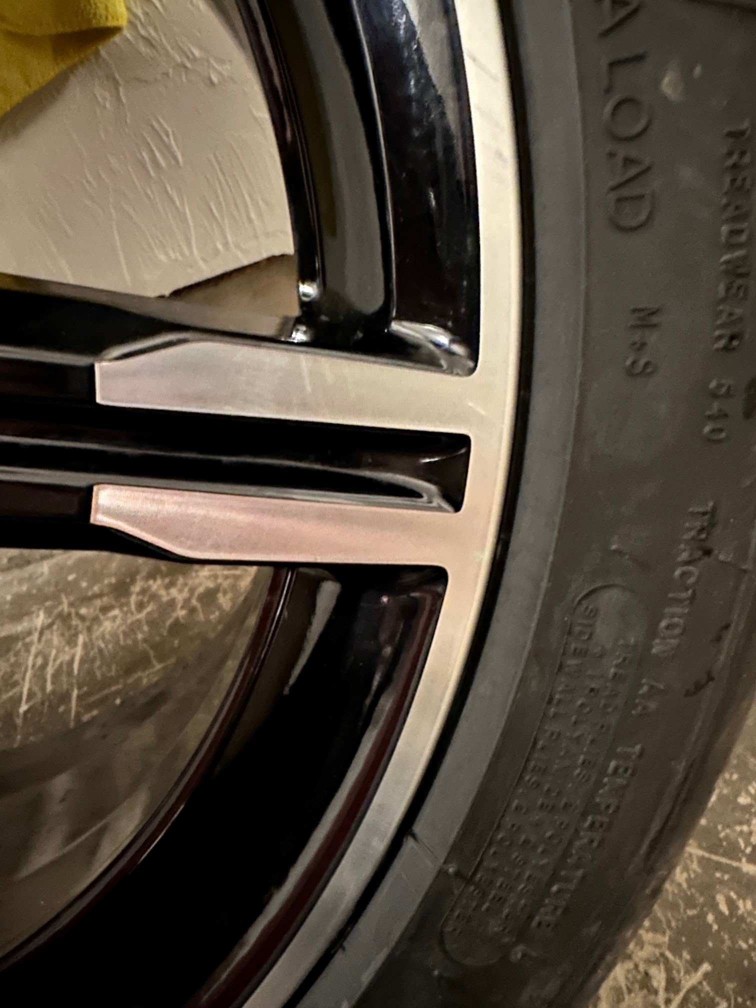

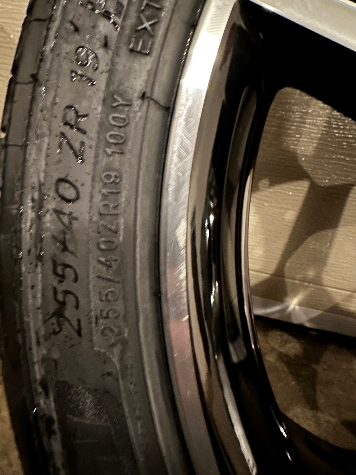

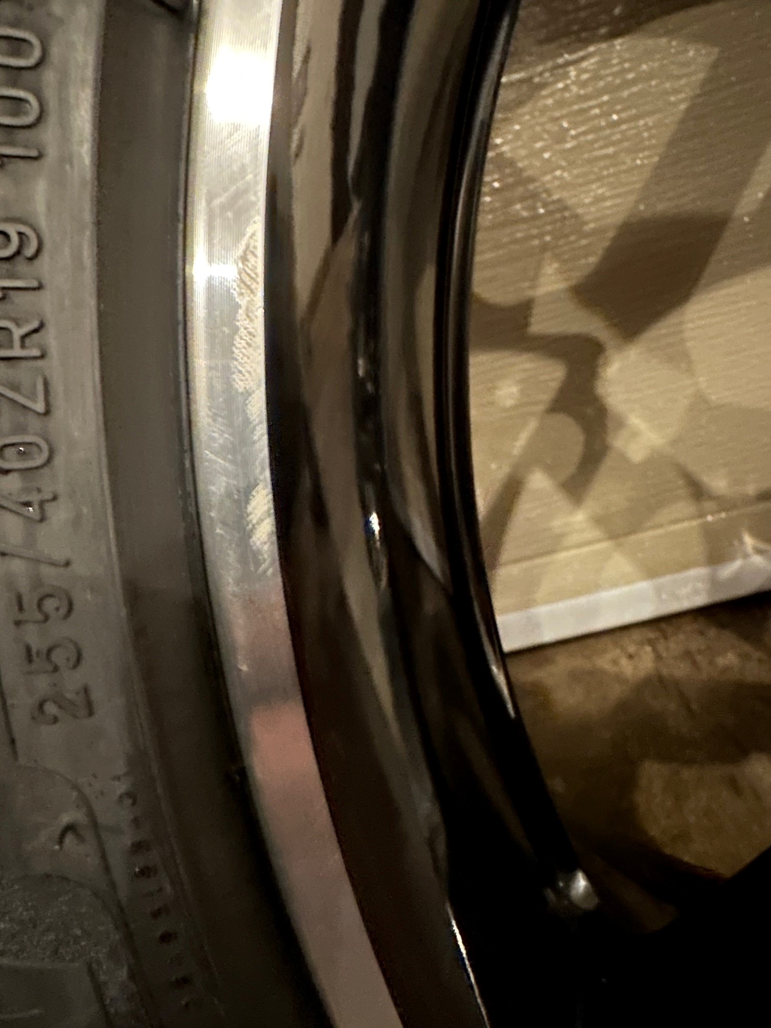

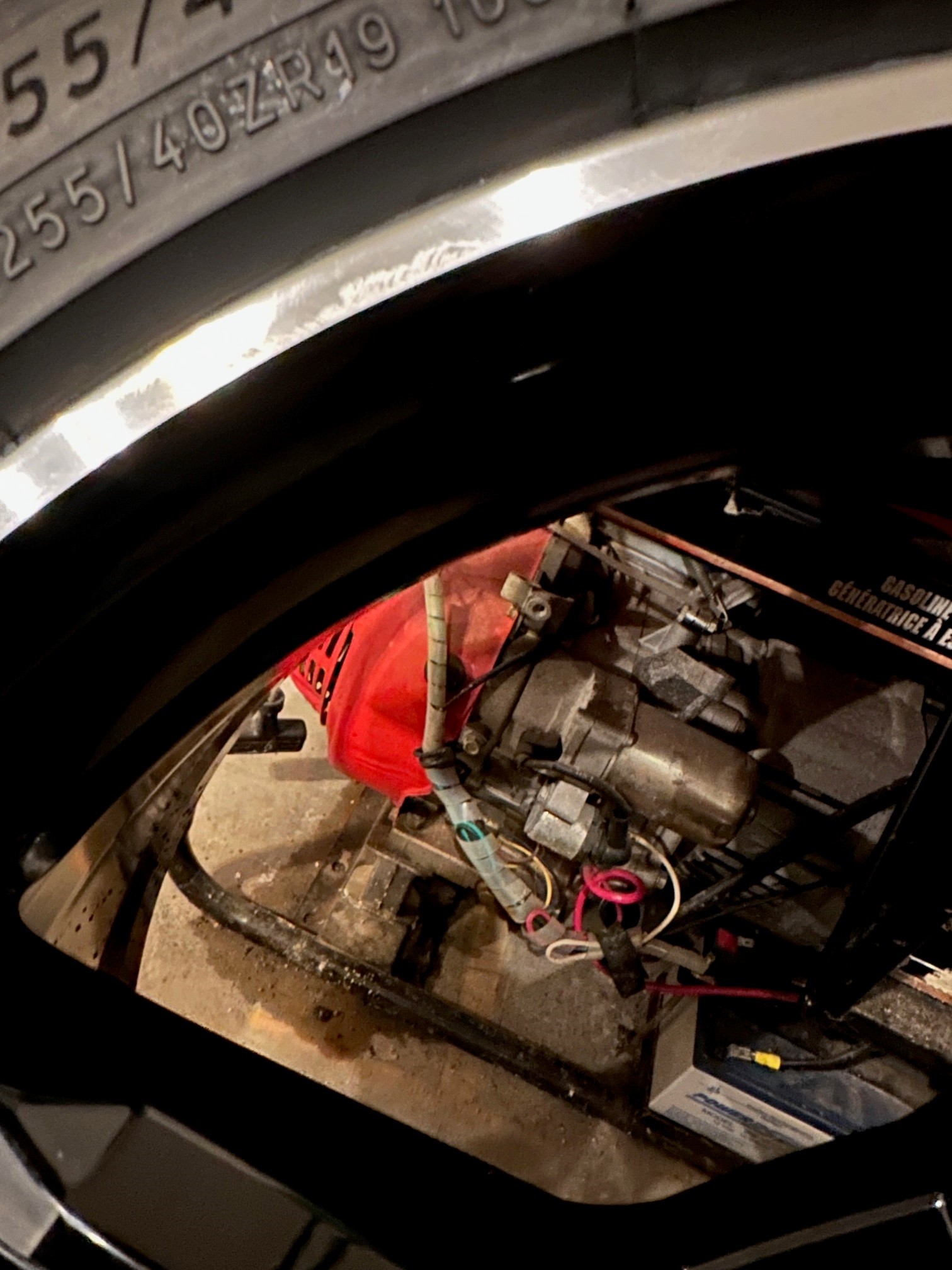

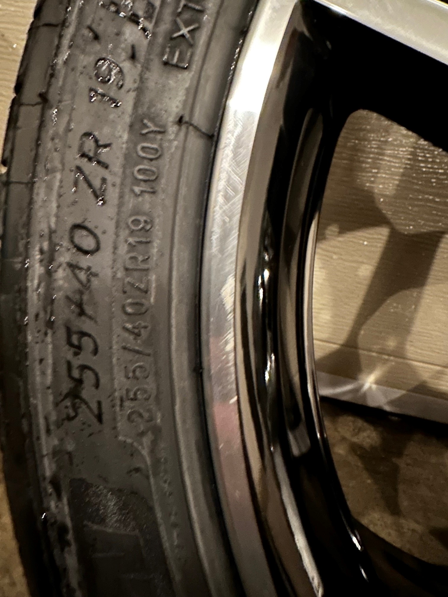

I got my wheels all cleaned up last night. Not a happy camper....lesson to myself and everyone that doesn't do this. ALWAYS take a date stamped pictures of all 4 wheels before taking wheels in to get new tires put on. I have side shots but not close enough. All 4 wheels now have damage because someone didn't use the correct machine or wasn't careful during the removal or install. Wheels where in perfect condition prior to this. Wheels were super dirty when I picked them up so I needed to wash them to see this. I have used this particular shop in the past with no issues. I have reached out to them and I was told to reach out to the manager on Monday as he is out. At this point its a their word against mine. I will keep the name of the company out of it for now to give them a chance to address my concerns.

That sucks hopefully the manager will have some integrity and own up to this mistake
Wow, hope it works out, good lesson for us all.
I think something like this can happen so fast and easy.
and we have all got wheels back dirty
Yes I agree. Why I didn’t question it when the shop hand gave them to me. I didn’t have the stuff to clean them right there either. These I must say where worst then normal as far as dirty. Like they were left in the mud. Not normal. Doesn’t make it any better and I know for a fact that whoever did these knew they did it. There is no way you would not know.
Probably wasn't done on purpose, but it's pretty sketchy to try and cover it up like you wouldn't notice and not take responsibility. Part of it comes down on the work ethic of whoever is doing the job and how much they GAF, and the other comes down to what the management deems as acceptable conduct for the employees. Changing tires on a Corolla or Camry used as transportation differs greatly from a car guy's tires and wheels. The Carolla or Camry owner probably wouldn't notice and likely wouldn't care. I'll buy Marc's comment about it slipping out of someones hands ...but that happens once, not on four different tires.
Hope things get worked out to a successful resolution.
Yeah I agree it could have slipped I guess. Never thought of the dragging motion. The reason I think tire machine and removal of old rubber might be the culprit is that all 4 wheels have a spot that is scratched way worse in a certain area. 2 have clear coat completely off about 1 1/2” long rough aluminum 2 others scratches I can feel with my finger nail but not as deep. Than a multitude of smaller surface scratches. I know one thing, I hand washed these wheels before putting it away in the fall and waxed them They were not like this.
I agree I don’t think it would be intentional. These are not your normal wheels as mentioned above. I also agree Usually the tire shops treat them with a different type of care. Possibly new worker? Wrong tools? Improper training.

All 4 wheels damaged is outright incompetence and neglect.
It’s possible you have combination of both types of damage. Face scratched from being laid on floor and from the tire machine.
The deep gouges with clear missing are very likely from tire machine.
The lighter scratches, especially if they criss cross randomly in different directions, can result from being on floor.
If they’re mostly in same direction, likely machine again.
Like Mike says, they treated your wheels like they would a set of run of the mill steel wheels from a random daily driver, who’s owner would never notice. That’s sad.
There should not be double standards.
Also, not a defence either but simple fact, older and/or heavily used high volume machines can become more prone to causing damage.
With the heavy use and time all their pivot points and lock mechanisms wear and the tolerance of each point increases, making the machine less sturdy, especially the arm that they use to pry the tire off and then put back on.
It that arm is loose, even the best tire technician can damage wheels.
But that is where integrity of shop owner and front counter personnel comes in.
The shop has a responsibility to keep equipment in proper working condition.
The counter personnel should screen jobs and be honest with clients.
We have been having issues with our machine lately, I would hate to damage one of your wheels.
Can we reschedule to next week after we have our machine serviced?
Or, let me check with my best tire technician to see if we can work on your wheels safely.
And yes, poorly trained personnel and or personnel who don’t care.
Sometimes the poorly trained are trying their best but simply aren’t cut out for it.
The worse is the poorly trained employee who also doesn’t care.
The counter person knows the strength and weaknesses of their staff.
We will do those tomorrow because our best tire technician is not in today.
Sorry, this all too late for you, Charlie.
But there is worth in doing due diligence even with tire shops.
I’m very picky about that.
For example, when I did the new wheels on my ‘15, I highly doubted the equipment we had in one shop was up to the task.
I consulted and decided to send the wheels to our other dealership where they had newer, state of the art equipment, and competent personnel to do the job.
Plus I added an extra caveat that there was absolutely no rush.
I made sure this was clear so no one on the other end would rush the job through.
To avoid feeling the need on their part to give it to the next available technician.
And probably more importantly, to not do it until the tech is fresh and ready to do the job.
One thing we don’t think about is that nice expensive wheels place added pressure on the tech.
If it’s a professional tech that takes pride in his or her work, and cares, they know the minute they see the wheels.
Ok, I got to get my A game on.
Can’t screw up on these babies.
You know what, it’s been a long day and it’s getting late.
Now that I’m aware that I have these to do, I’ll just set them aside and do them tomorrow morning when I’m well rested and ready.

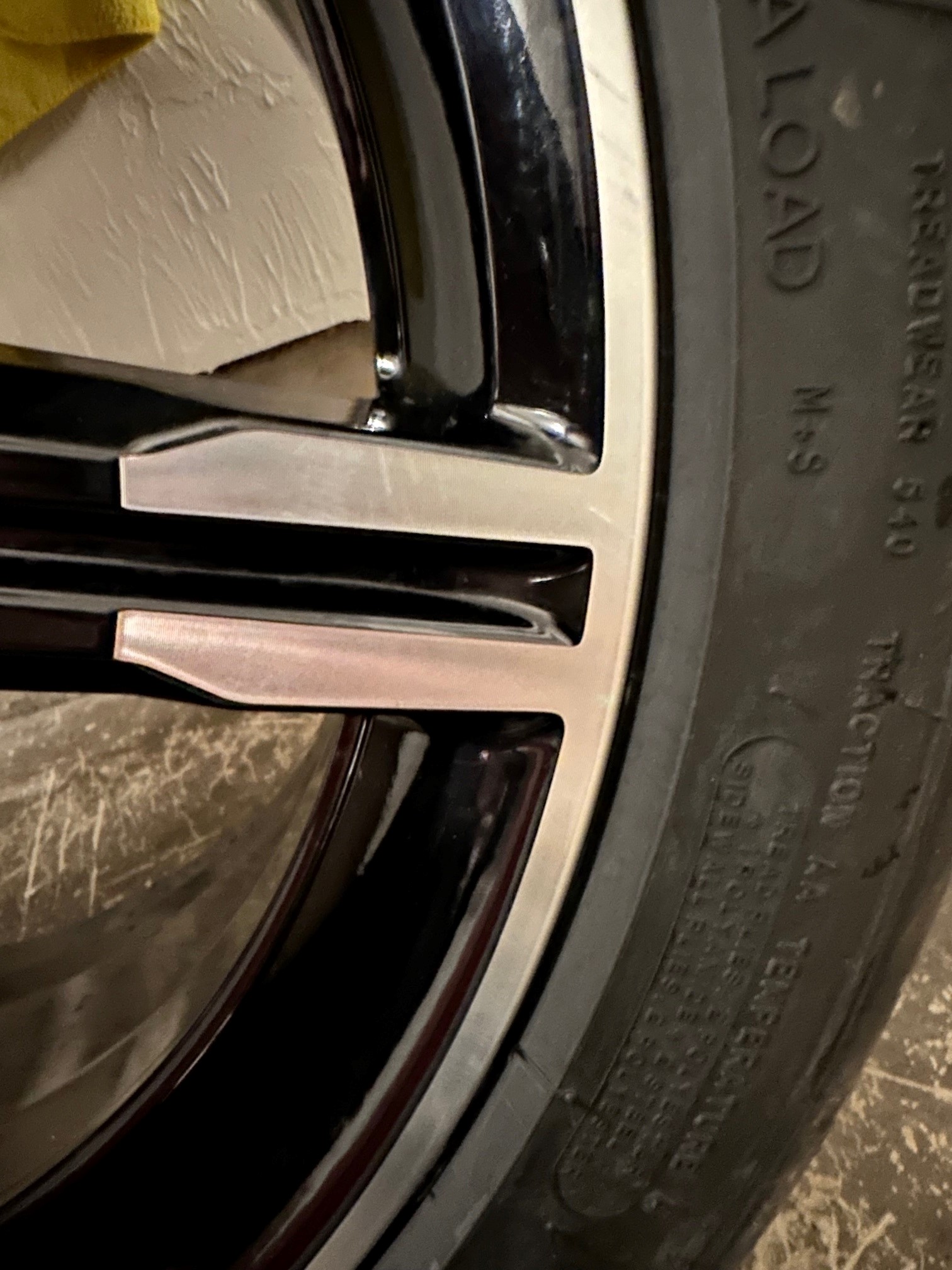

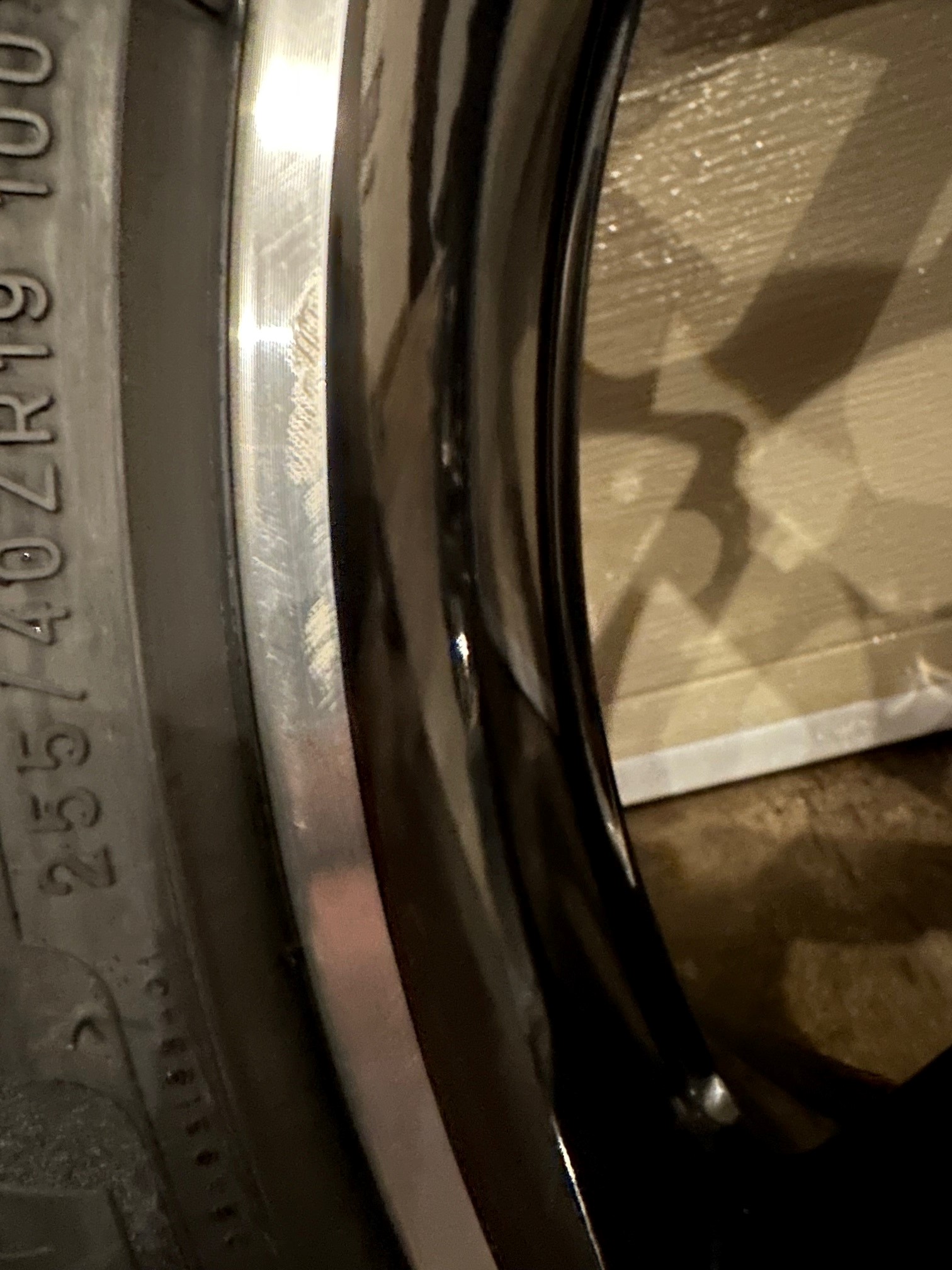

I understand how you feel . Happen to me once when i went for alignment they ask that you not stay in the garage while they work so can t see if anything happens but was happy took picture just before got the car in .was a damaged big scratch and the oem wheel was only 1400.$$ was so mad .never will i go to that garage ever.
Hope that they will own up for there mistake.i unserstand how you must be.Sad for you. They don t own a mustang they do not understand,hope goes for you.
