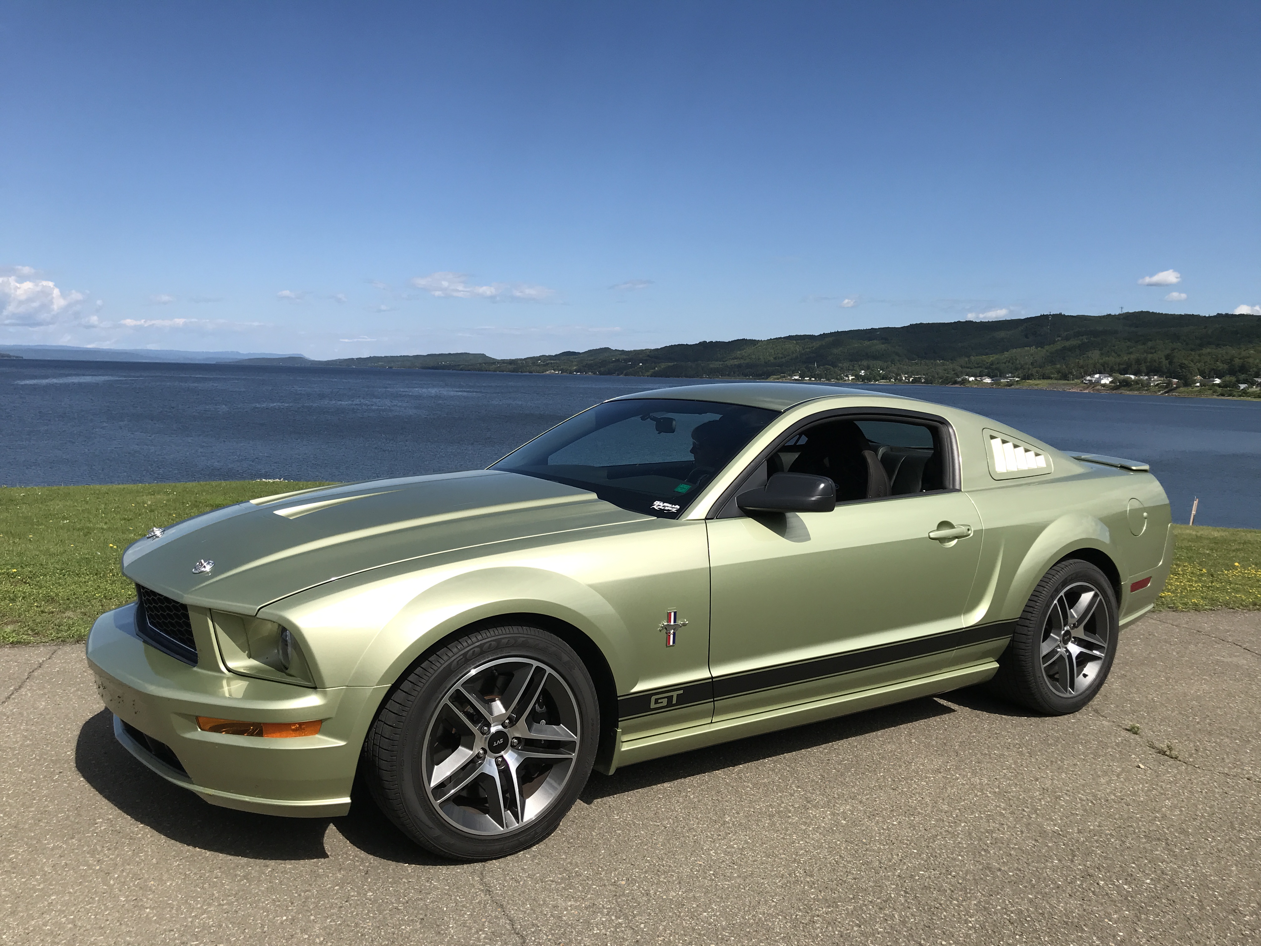

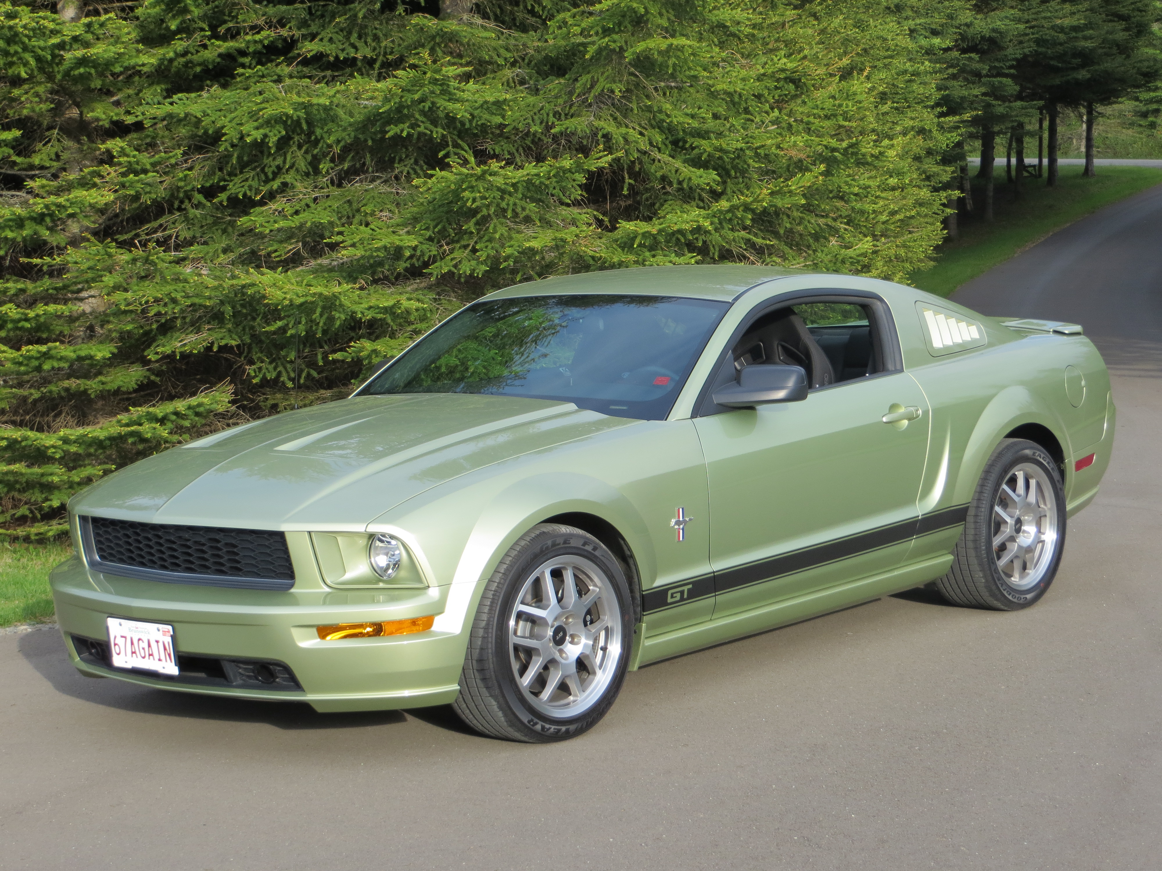

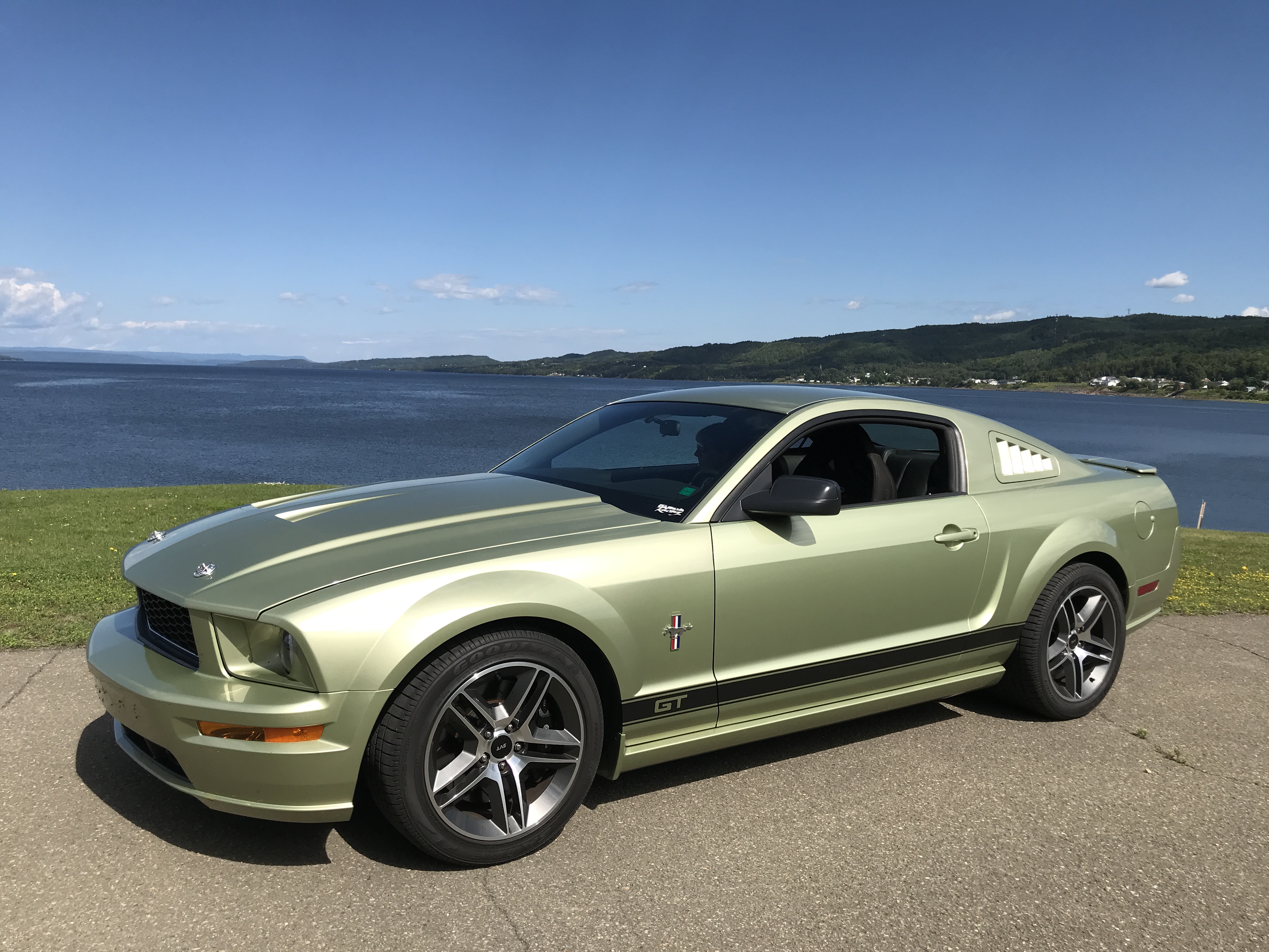

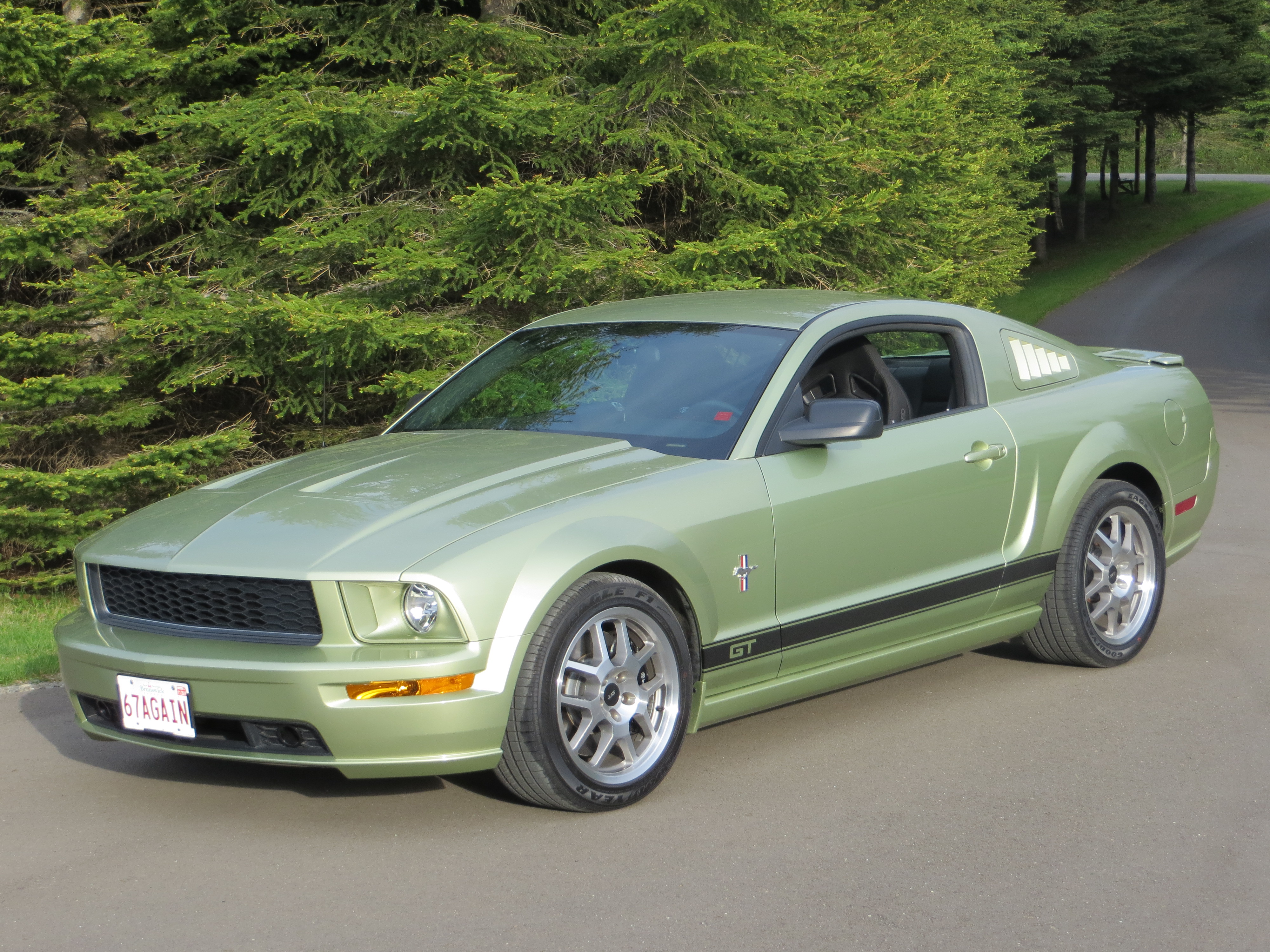

I have two sets of wheels for my 06.
-07 to 09 GT500 wheels
-2010 GT500 wheels
I’m currently running the 2010 wheels because tires on them are newer and more rubber.
Have used the 07-09 wheels for track days in last few days.
Which ones do you think look better?
07 - 09 wheels?
2010 wheels?
I think the 2010 ones suit the colour scheme more.
