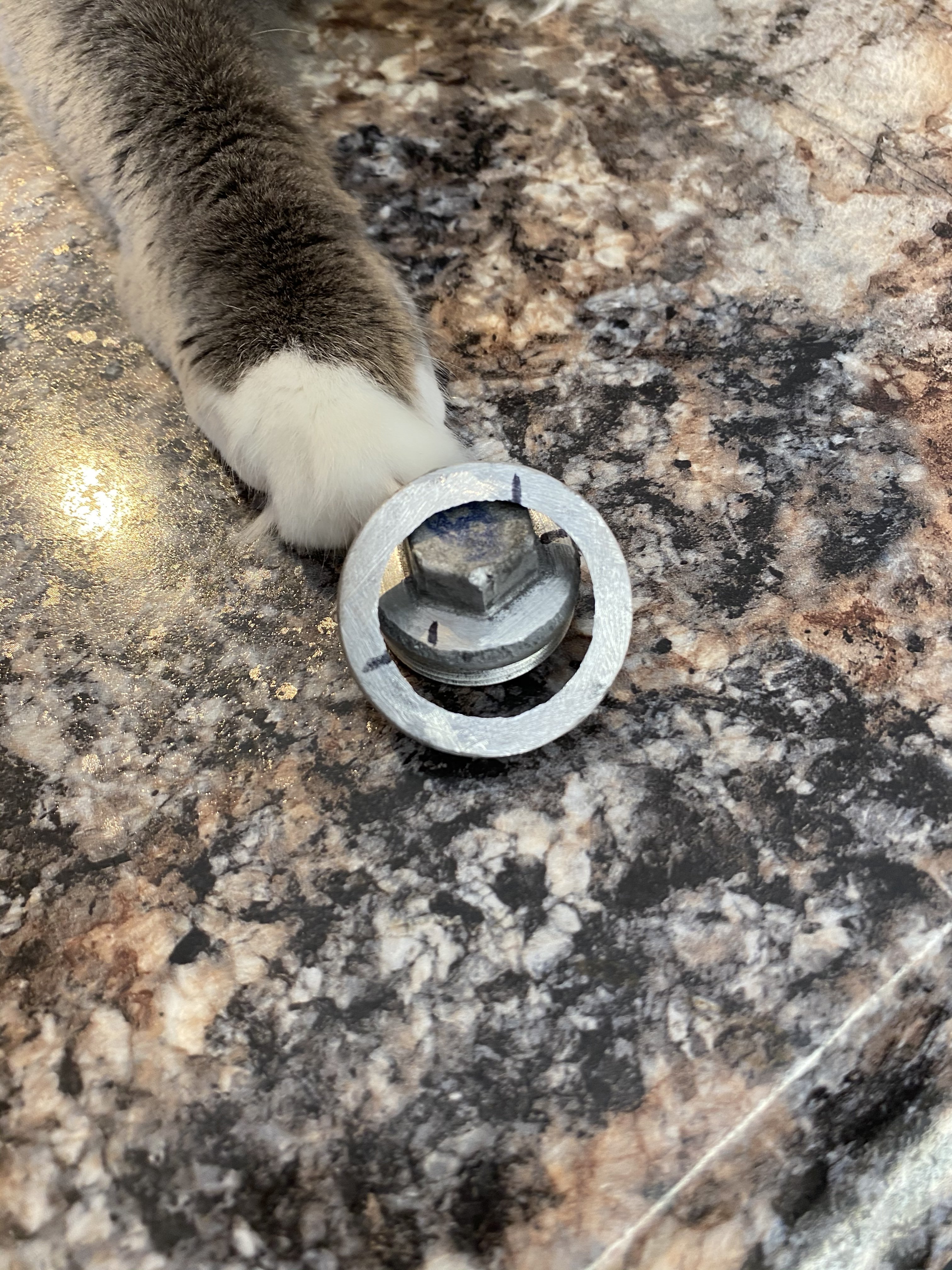

This is what happens when a so called motorcycle mechanic doesn’t use a torque wrench to tighten a oil filter cap. It only needed 20nm or so. I had to use my 3’ bar to loosen it
