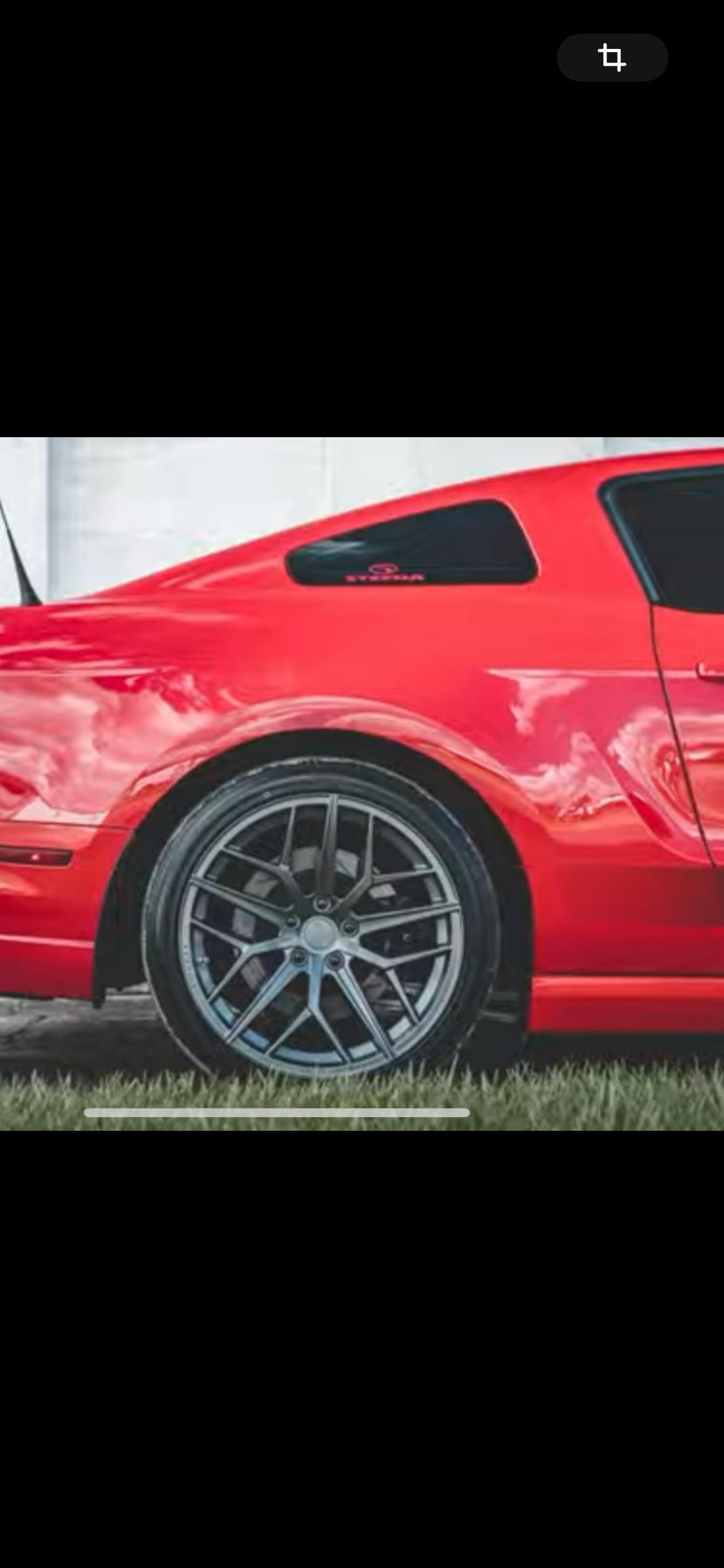

I’n no engineer or CAD design expert but to assist in understanding some of the principals I sketched a few visuals.
The sketches show this part of the car where the control arms (in red) tie to the chassis in front of the rear axle (front end of the control arm) and the axle housing at the back (rear end of the control arm).
The control arms are inboard of the wheel or behind it.
The four sketches I have.
