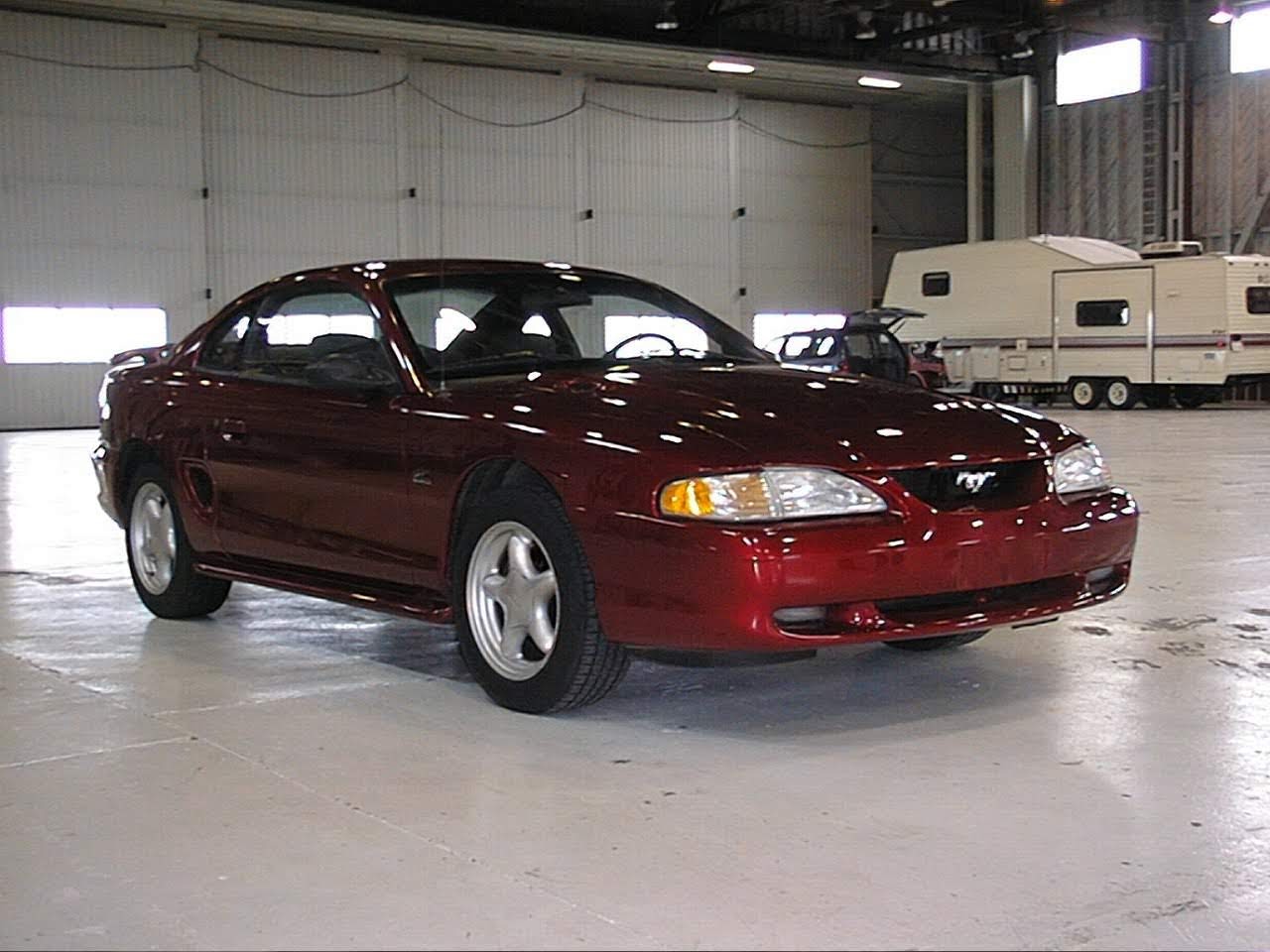

1994 Mustang GT Coupe
Looks great! This was the same car I started out with in 2001, although mine was Laser Red. While I do miss it, the 302 definitely needs a bit of help with that heavy body on it :)

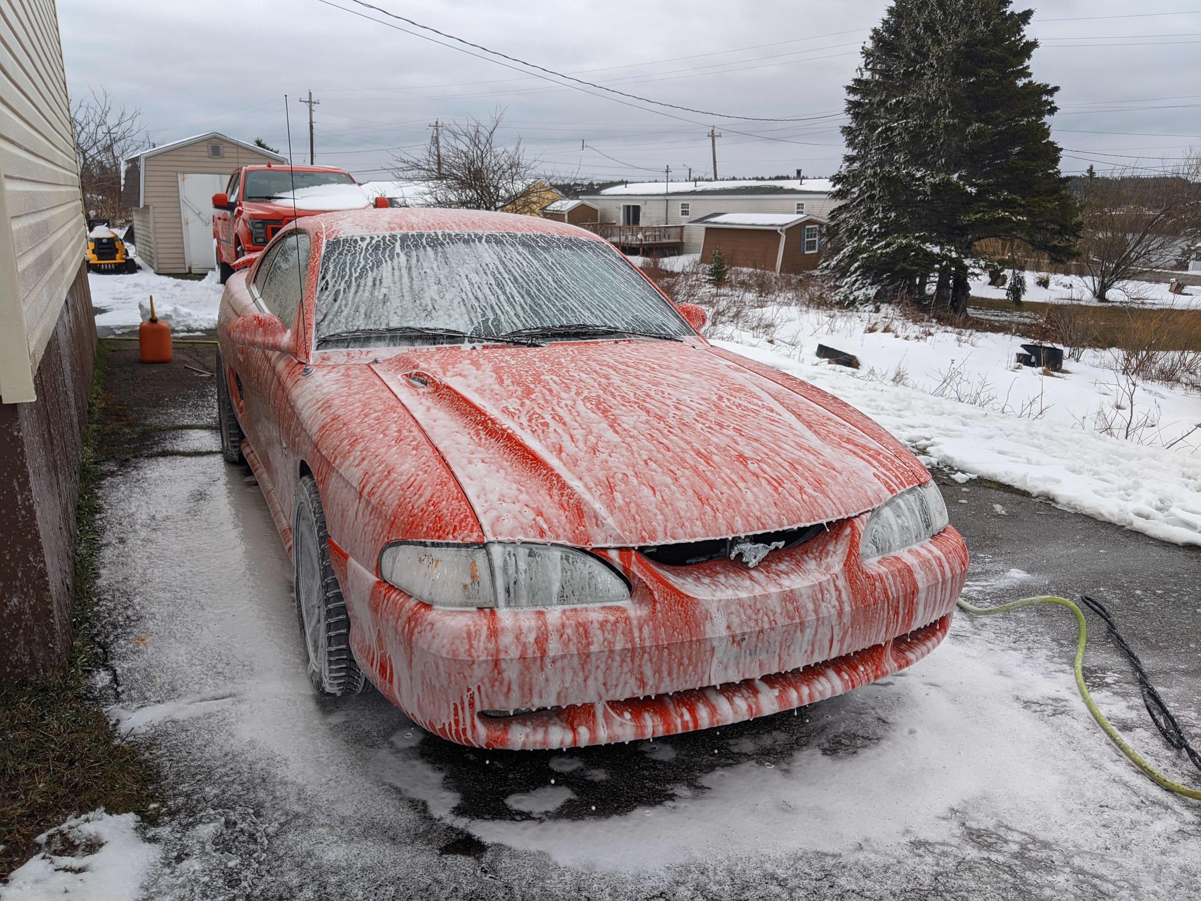

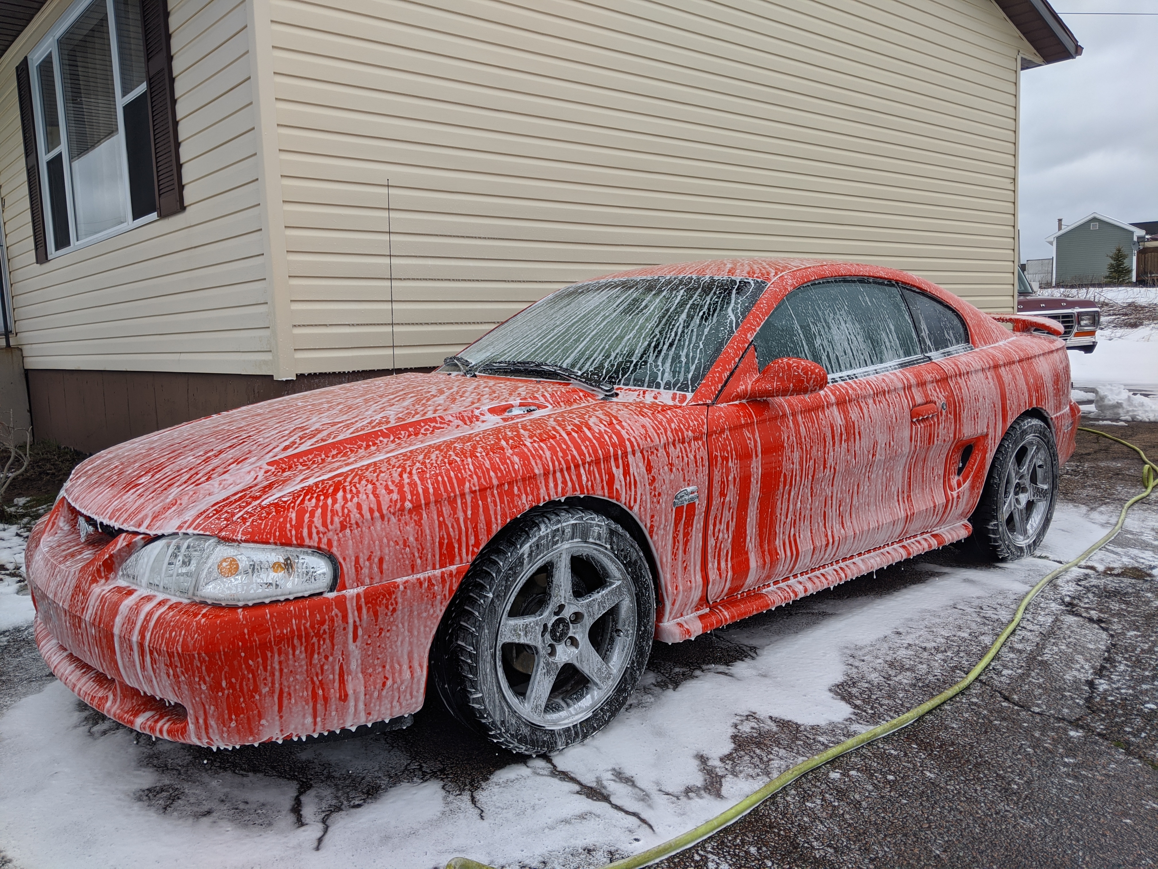

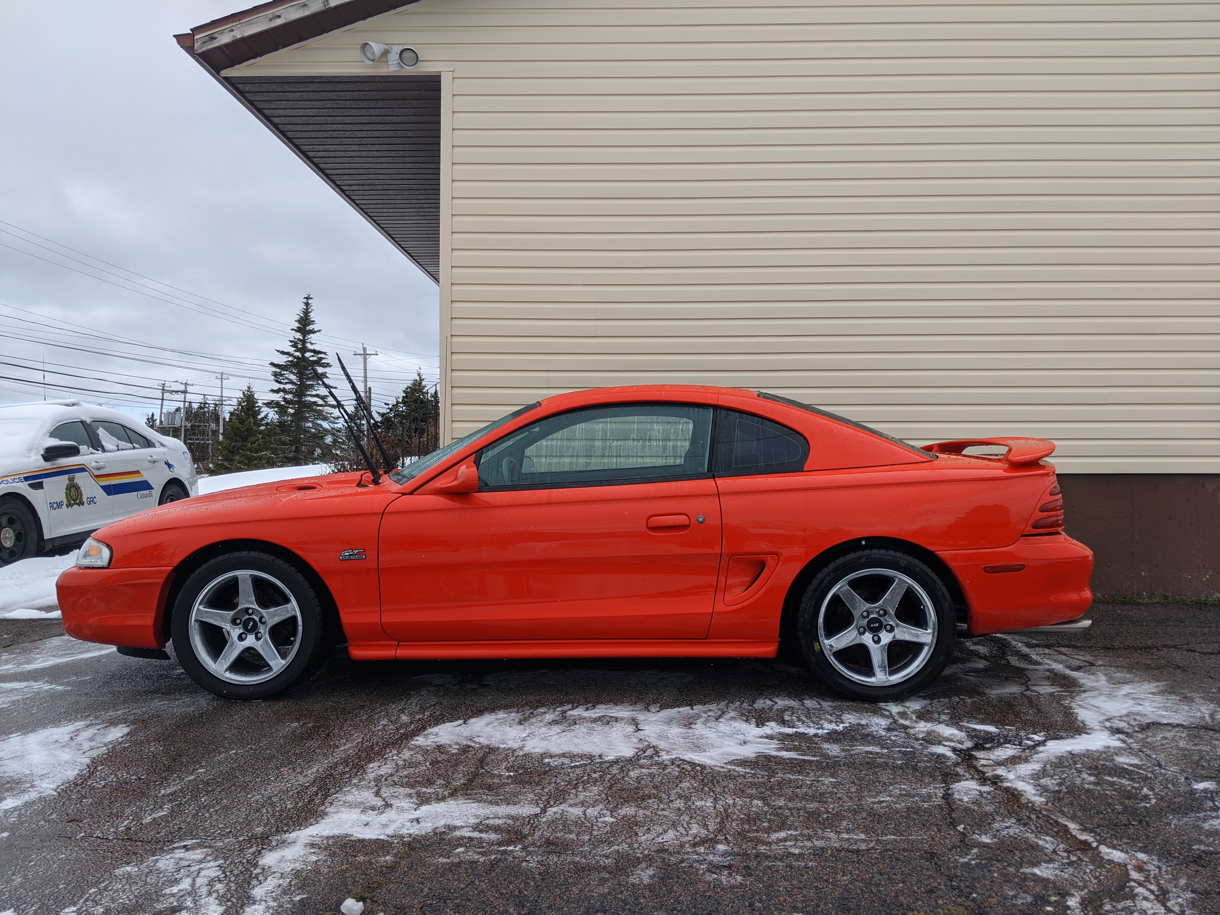

So I finally managed to get the car home in Arichat yesterday. Thanks Charlie for the help!
I started by giving it a good bath due to the beautiful spring weather we had. A foam gun on a pressure washer works wonders.
The sun came out as I finished drying it.
Max it was my pleasure to give you a helping hand getting it across the border. Glad you are enjoying it. It is looking awesome.
