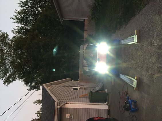

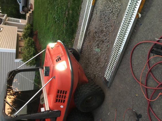

27 watt led lights. 45 watts total. 3 amp draw total. Pretty good! Powered them up in the dark garage and they actually throw some pretty serious light. Its not going to get out hundreds of feet, but the argo is going to be slow speed driving and tops out at 18-20 mph anyways.

Mounted in the body and slaved to a temporary battery (waiting for more delphi connectors to arrive):
The last pic looks like its looking down because it is. I had to hold the phone up over my head. Any lower and the lights are blinding and just wash everything out. Its actually hard to look at them, they actually are that bright!
I had to square out the body holes, cut the mounting boss off the lights and drill/tap holes in the rear of the housing to attach body mounting brackets (the place for the bolts was there, just not drilled).

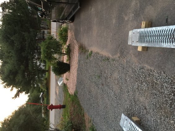

Lights off:
Lights on:

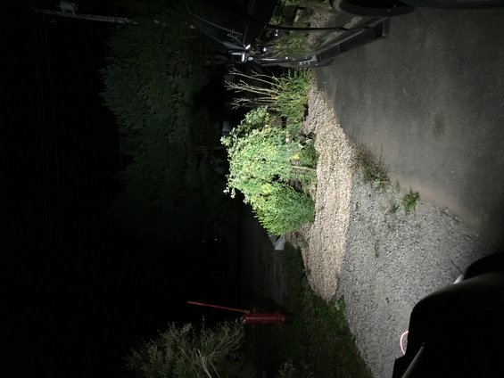

In darkness:
Night pic is a little deceptive because of the tree/bush to the immediate front. The big pines behind it were all lit up, but just doesn't show in the pics.
Right around 27!watts each and under 3 amps total to run both.
Pretty good for 26 bucks!
