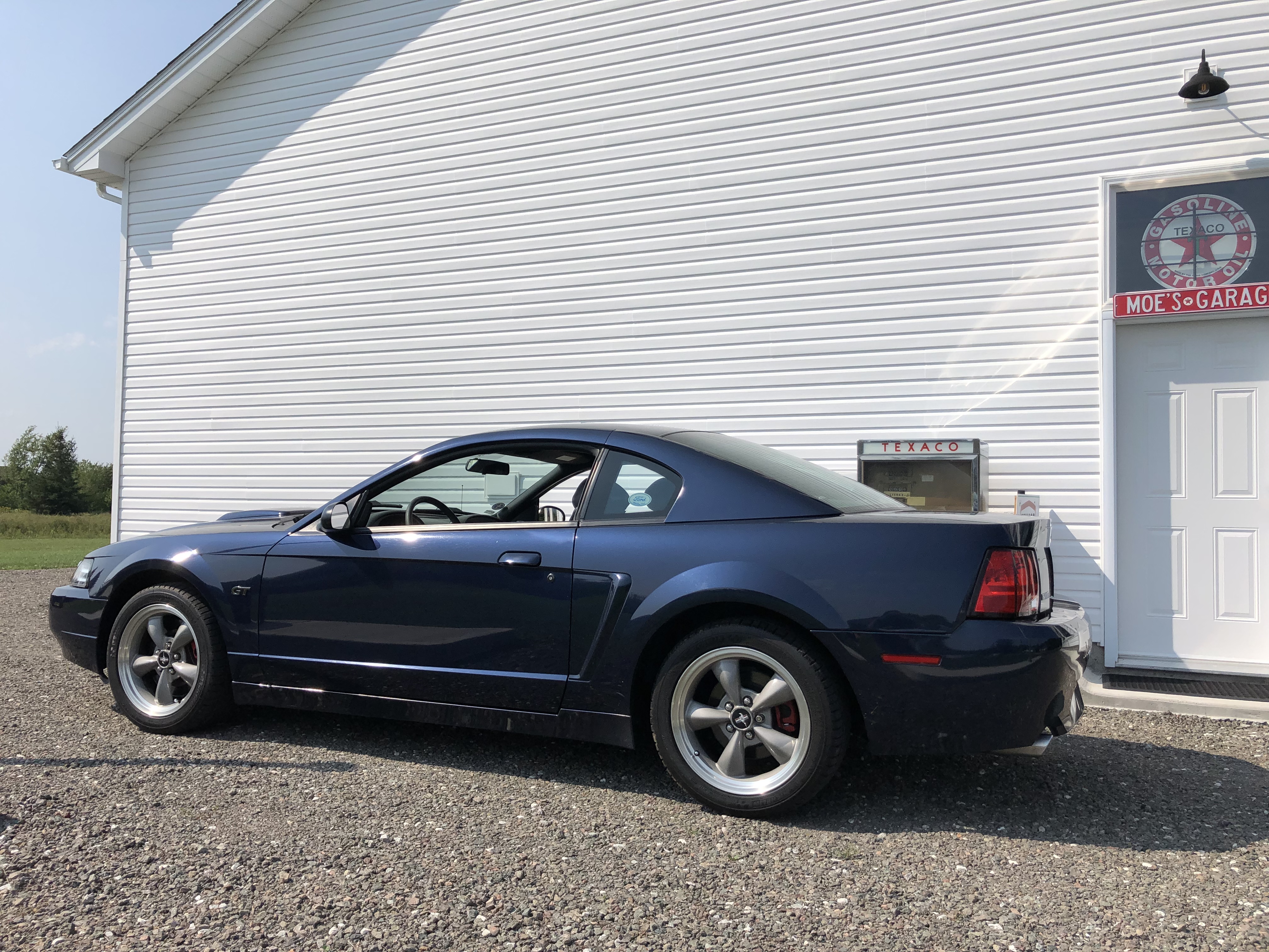

Here’s my True Blue 01 BULLITT View attachment 48048
Nice looking car! I had a 99 Gt before this one... then and now
